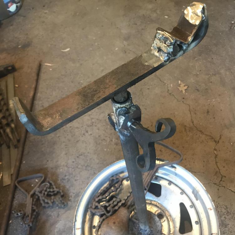

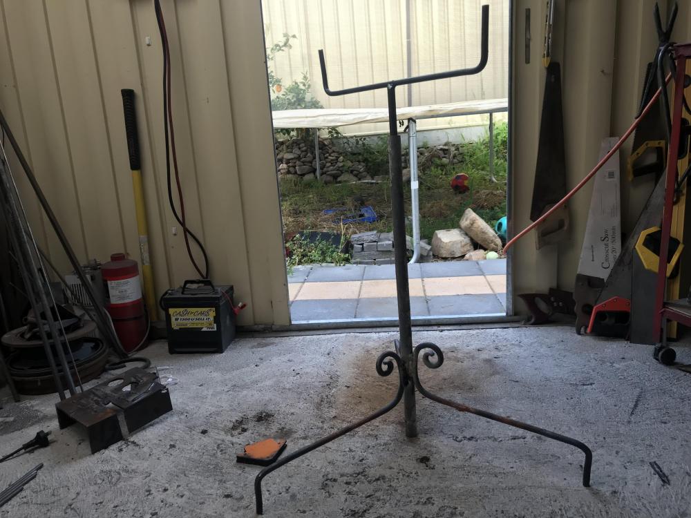

To support longer stock in the forge, I used to use plastic crates stacked up, which worked, but were bulky and made of plastic didn’t fare well with hot steel.  I saw a simple support stand on a video on you tube and thought it should be fairly straightforward to make, and it turned out to be very useful so far.
Here is the build video:
https://www.youtube.com/watch?v=m1qYu8aNCiU&feature=share
I had to laugh when after you tacked the first leg it fell off after taking the clamp off :-) Anybody that welds has had that happen. I wonder if theres a welding term for that. I might have  missed it in fast fowarding the vid but what kind of device makes it adjustable?    You made a handy tool!
I have since added a set screw near the top, not in the video so you didn’t miss it.  I need more welding practice, I also find it funny when things drop off, but not at the time!

You may want to weld a V to the stand to keep things from moving about. Lay the stock in the V and it stays put.
Thus:
Another good option is to use rebar for the horizontal piece; the nubby texture keeps things from sliding around.

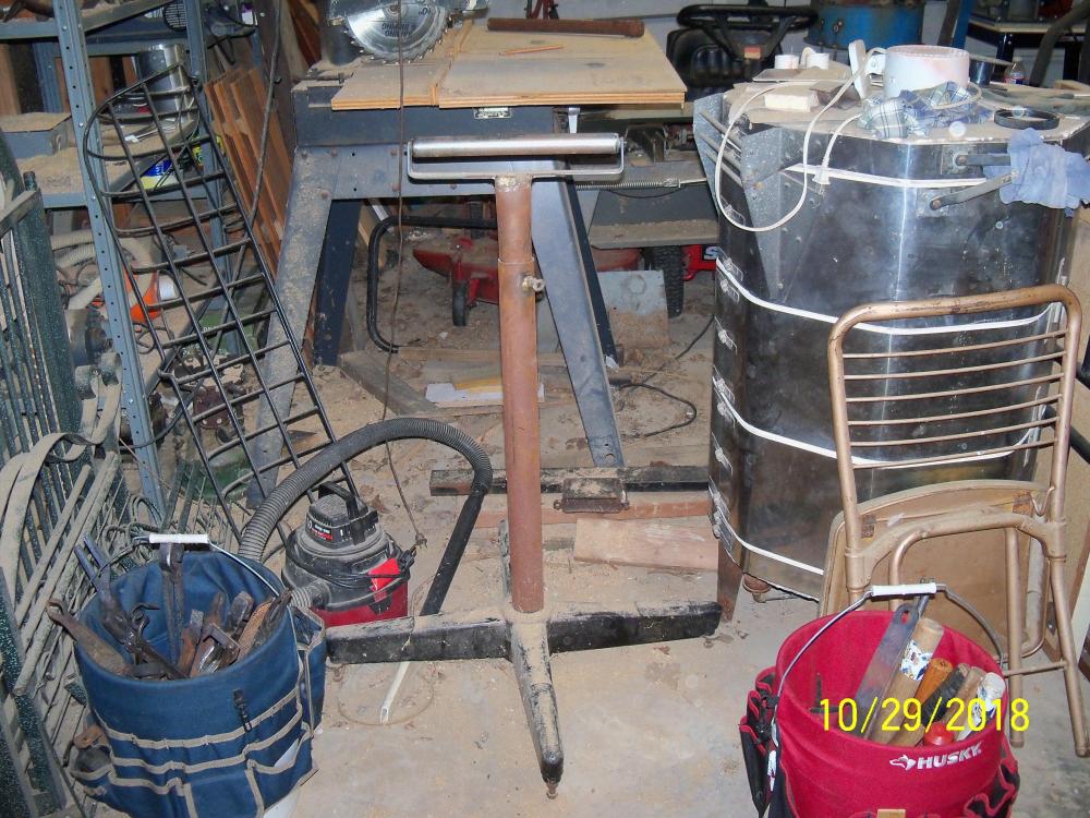

Mine is a pretty simple affair. Base is an old chair base with a piece of auto exhaust pipe welded to it. Another piece slides inside it with a roller welded on and a nut&wing bolt to adjust height. It does double duty for a stock rest when ripping long lumber with the radial arm saw and long stock in the forge. When using it in the forge a couple of c-clamps keep it from turning & the stock from sliding off to the side.

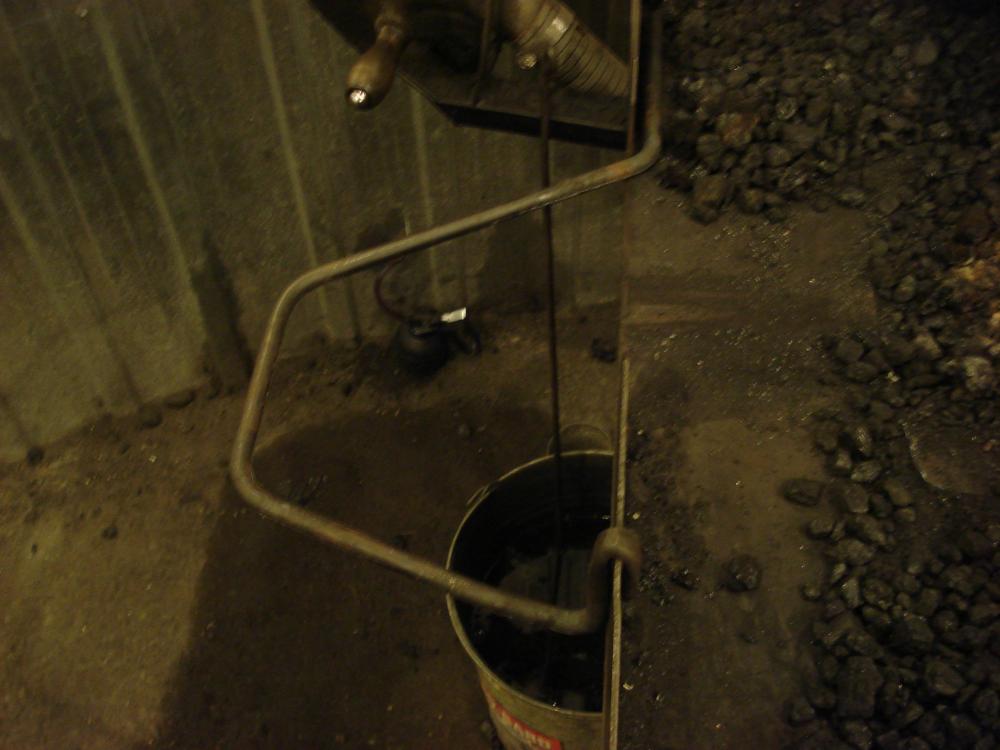

Made this when I started. It takes no floor space. It is used almost every day. Further, bolted to the wall I have a crane that works/pivots like a crane in a hearth for longer material. DSC02574.thumb.JPG.e6abf2ee07cf2dc1925ac1ce201c603b.JPG
