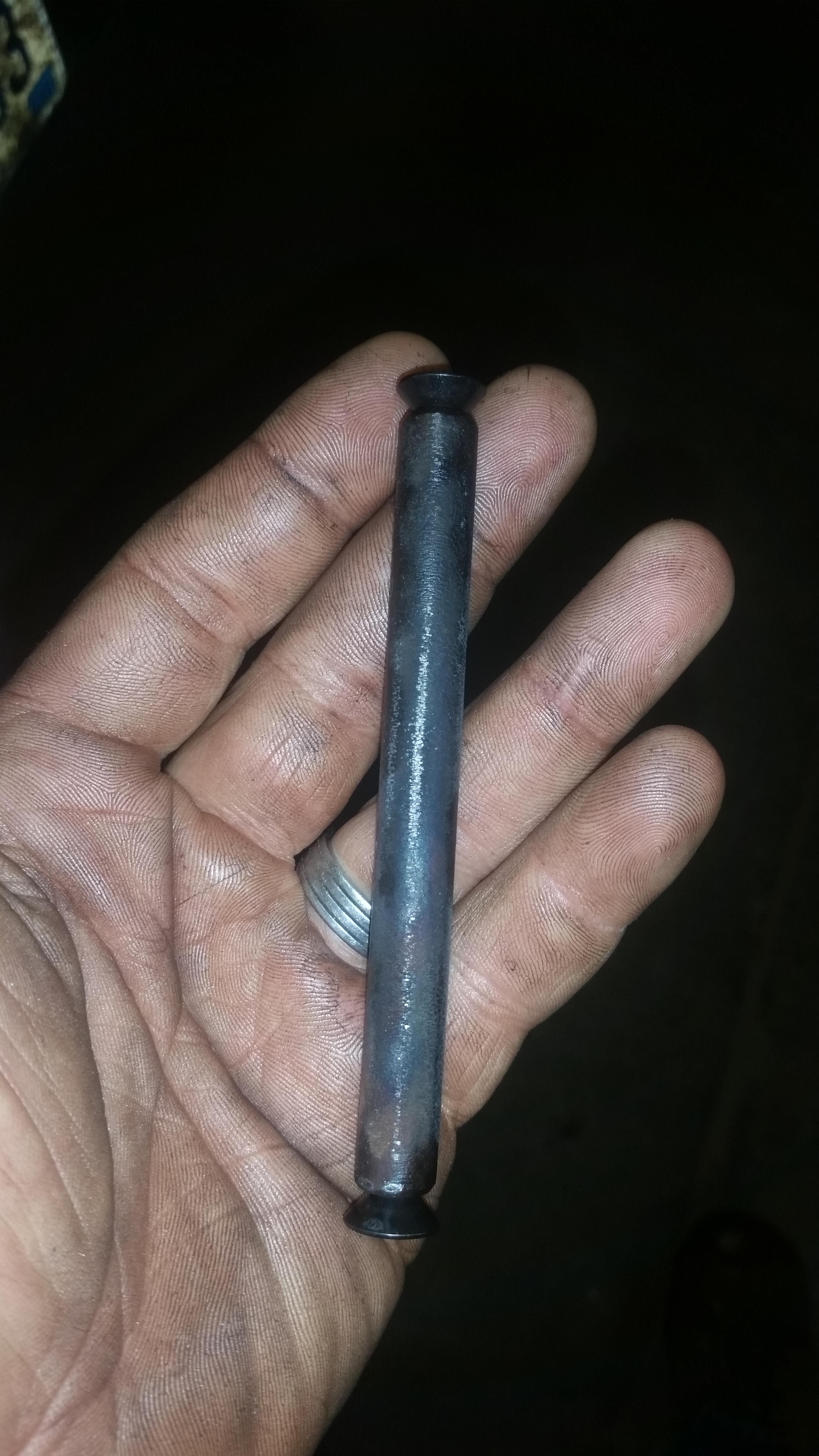

I recently made some pins for a project at work using a coil spring. I'm assuming it is 5160. After great treating and tempering them I realized that I need to drill and tap the ends of the pins for a 1/4X20 screw and in their hardened state they wear out my drill bit really fast (obviously). So now I need to aneal them. This is where the problem comes into play. I do not have a forge here, so I can't use the technique of heating them up, and then cooling them down slowly in the forge. I am thinking about trying the following technique but wanted to run it past you gurus to see what you thought.
Fill a metal bucket with dirt leaving a cavity in the center.
Heat the pins to critical, at the same time preheating the dirt with a propane torch.
After that I would bury the pins in the hot dirt and leave to cool slowly.
Does this idea make sense?

I realize that there are better annealing mediums out there, but like I said this is being done at work with only typical welding/shop tooling IE no forge or any of that fun stuff which is why I thought I'd try and get as much heat into the dirt as possible because I am sure it isn't as good of an insulator as ashes or vermeculite.  I used a half bucket of dirt, put a 1/2" plate in the dirt and heated the pins on top of it then buried them and tamped it down.  My goal there was to get some extra heat in the plate to allow for a slower cool down of the pins themselves.  Tomorrow morning when I get to work I'll pull them out of the bucket and try drilling them in the lathe.  I'll let you guys know how it worked out.

My taps are good, however the drill bit we have for 1/4 20 taps has seen it's better days.  I drilled and tapped 2 pins the other day and I had to sharpen the bit 5 times!

This is why I'm annealing them. I was trashing my bit and scared that is leave half of my tap in the pin.

I pulled them out of the bucket. They drill and tap like butter!
