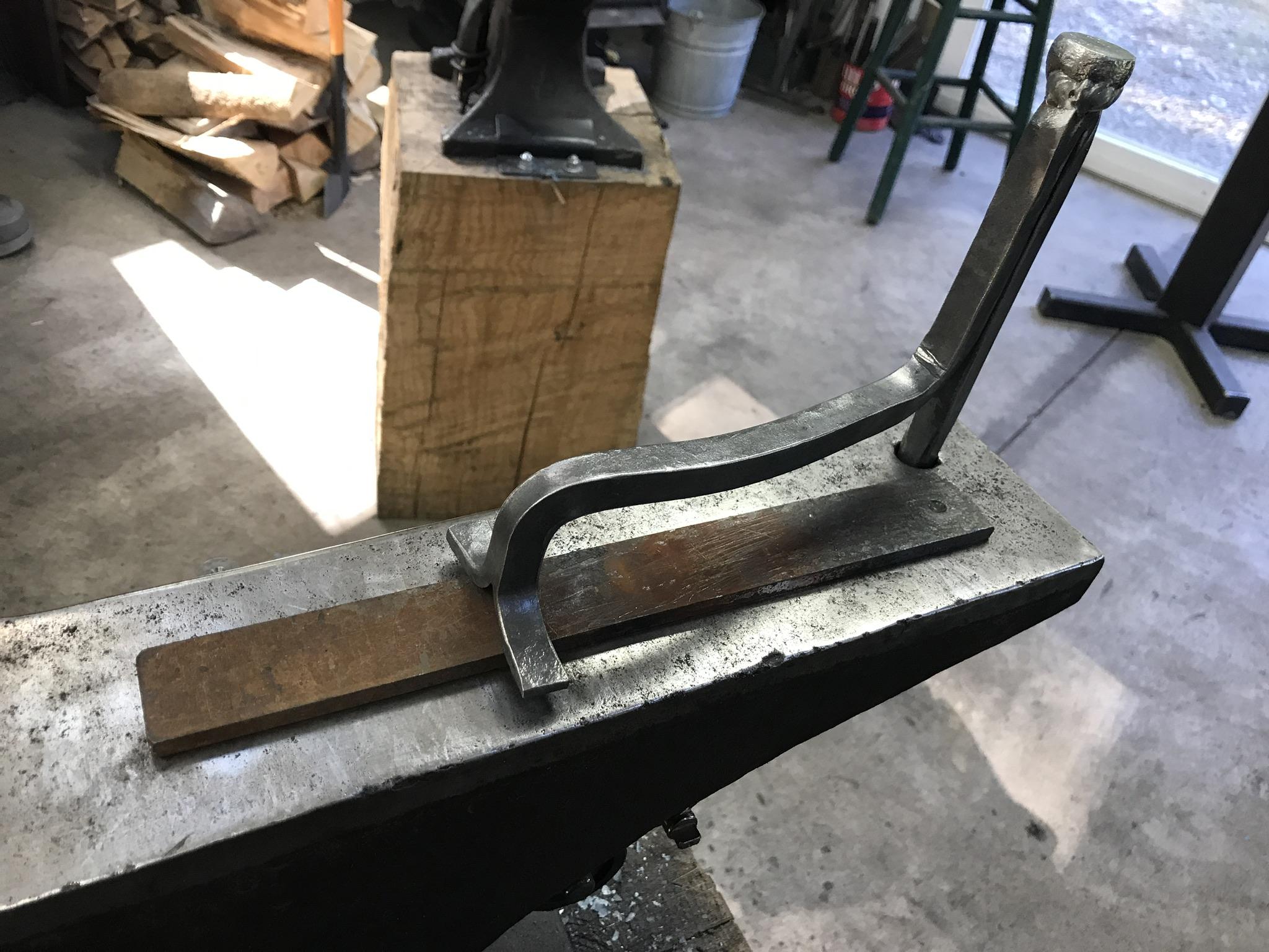

Well it’s not pretty. But I did practice a little bit. I practiced tapering and of course bending over the horn. I’m going to cut my stock a little smaller tomorrow. I’ll use some vise grips and a glove since I don’t have tongs yet.65FC1F15-AC12-4756-B5F9-B2D8D3A4696F.thumb.jpeg.5644f3f46cbd7aab3c9824536d8e5462.jpeg
Come back a known distance and mark the stock. Make the end and reference to your mark. You now know how much stock is needed to make that end.  Measure that distance plus the length of the middle section you want and cut the stock. Make the second end piece and you should be close to your target length.
