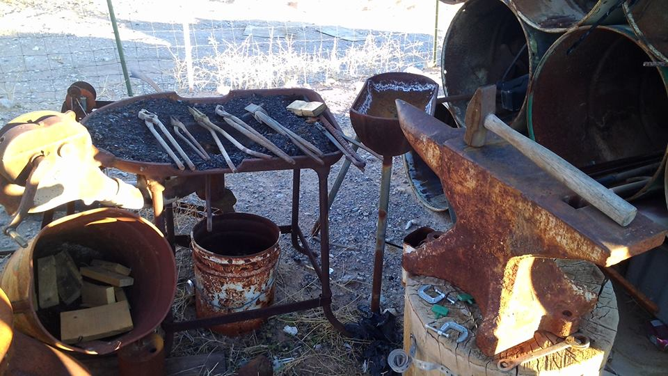

For me an equalateral triangle works best and one step from forge to anvil and post vice, and one step from anvil to post vice.
Unless it's a temporary setup for me, I always mount my post vice on a post buried well into the ground. Being  able to work a full 360 degrees around your post vice is a wonderful vice to have..
Also you might consider placing your forge in a corner, on dhe diagional. Meaning the back of he forge faces the corner Apex., This will be a bit more efficient and give you more room for your benches and other tools that will magically appear in the future. And if you do long stock, then cut a pass thru where needed in the corner.
