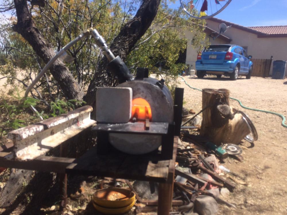

jlblohm Posted June 2, 2018 Share Posted June 2, 2018 At least he has the wool sealed and is a basically turn key unit. Better than what this guy is selling! 1 hour ago, Mikey98118 said: Since you see no reason, my advice is for you to buy one and experience that forge yourself. I have no need for a forge. I have been building my own forges for quite a while. K-9JAX asked fir our opinion and we all gave him our opinion. So my honest opinion is i have seen way worse forges built and have personaly built worse. Its a little on the pricey side but he has to make money...he isn't doing it for fun.the wool is sealed and the option to have 2 inches is good. I belive it would be worth the money. So there it is...my honest opinion. Quote Link to comment Share on other sites More sharing options...
Frosty Posted June 2, 2018 Share Posted June 2, 2018 I really don't want to turn this into a "thing" and I tend to agree the forge maker involved in the picture you present is worse. However please note my red flag warn you off issue is exactly the one in the picture you posted. The use of cheap air hose for the propane supply and hose clamped barbs rather than propane rated hose and fittings. I'll give the fellow the benefit of the doubt that he just doesn't know any better but basic safety is important. Especially in a gas burning appliance. Frosty The Lucky. Quote Link to comment Share on other sites More sharing options...
