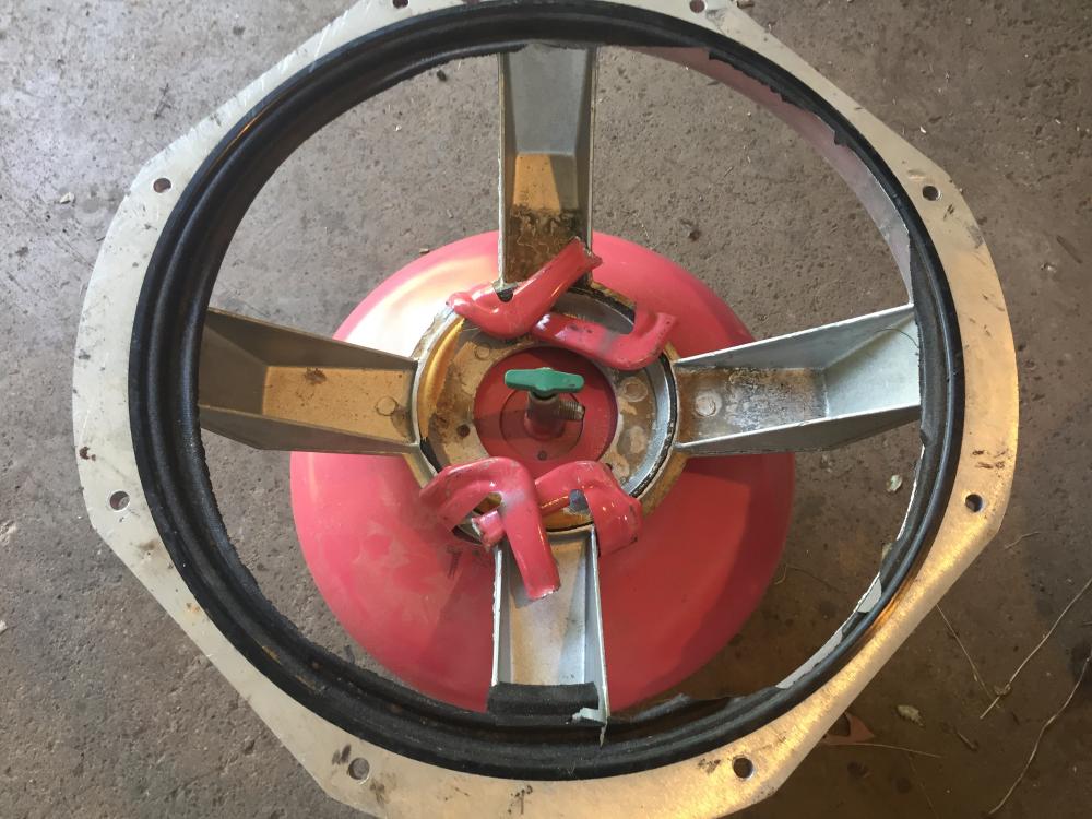

JHCC Posted May 27, 2018 Share Posted May 27, 2018 My slack tub is one of those helium tanks for filling balloons, originally intended for making it into a gas forge. It’s attached to an aluminum speaker frame for stability. Link to comment Share on other sites More sharing options...

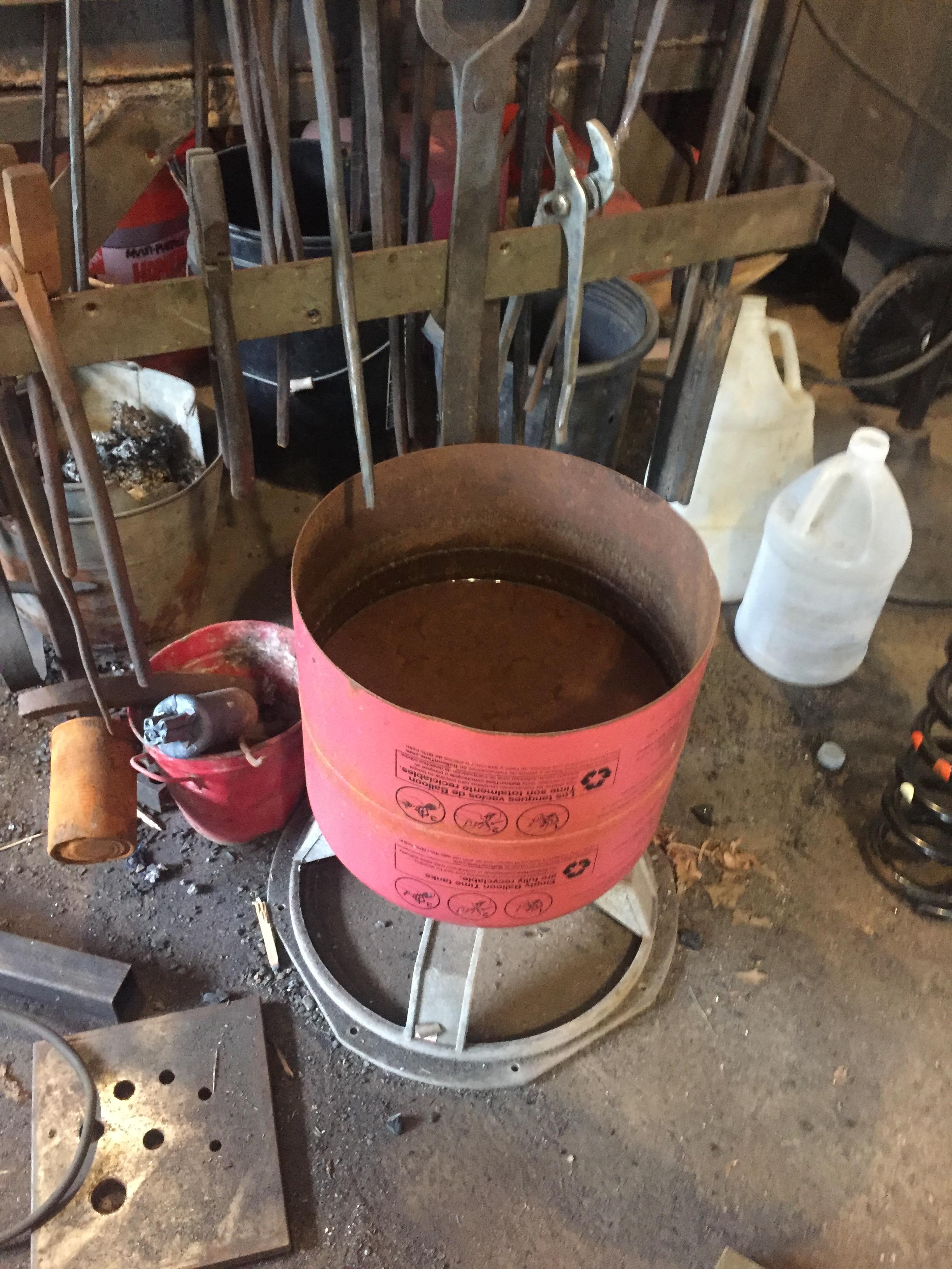

Fixit Posted May 27, 2018 Share Posted May 27, 2018 I add a couple tablespoons of Bleach in my slacktub. I use a small beer keg, probably 2or 3 times your size shown in the photo. How did you attach the stand to the tank? Link to comment Share on other sites More sharing options...
JHCC Posted May 27, 2018 Share Posted May 27, 2018 The tank is upside-down; the carrying handles are cut and wrapped around the speaker frame. Link to comment Share on other sites More sharing options...

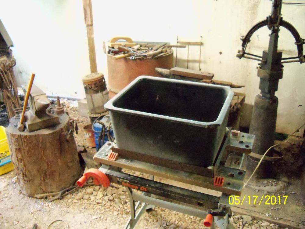

Irondragon Forge ClayWorks Posted May 28, 2018 Share Posted May 28, 2018 Our current tub is a donated deep sink. Made out of some kind of resin (heavy like cast iron) it's working well and easy to drain. Picture while making an angle iron frame stand for it. Link to comment Share on other sites More sharing options...

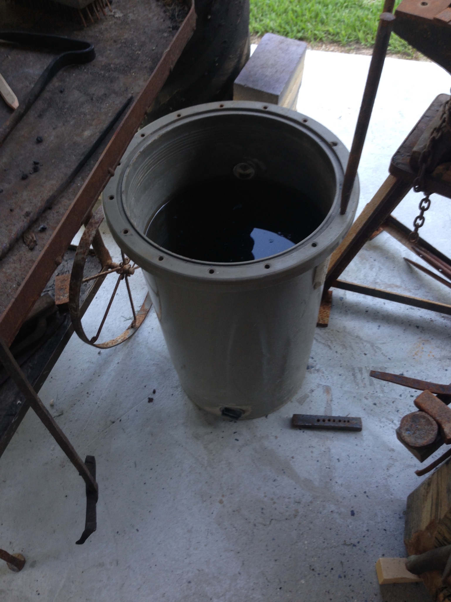

Borntoolate Posted May 30, 2018 Share Posted May 30, 2018 Mine is plastic it doesn't rust. IT is from a previous pool DE filter. BUt don't see why any plastic tub would not work. Just don't poke it with hot metal. This is relatively thick maybe 1/4" or so maybe more. Has to hold pool pump pressure. So thicker than a plastic trash bin and pretty sturdy. Drifts usually live in the flange holes for easy access and quench cooling. Link to comment Share on other sites More sharing options...
