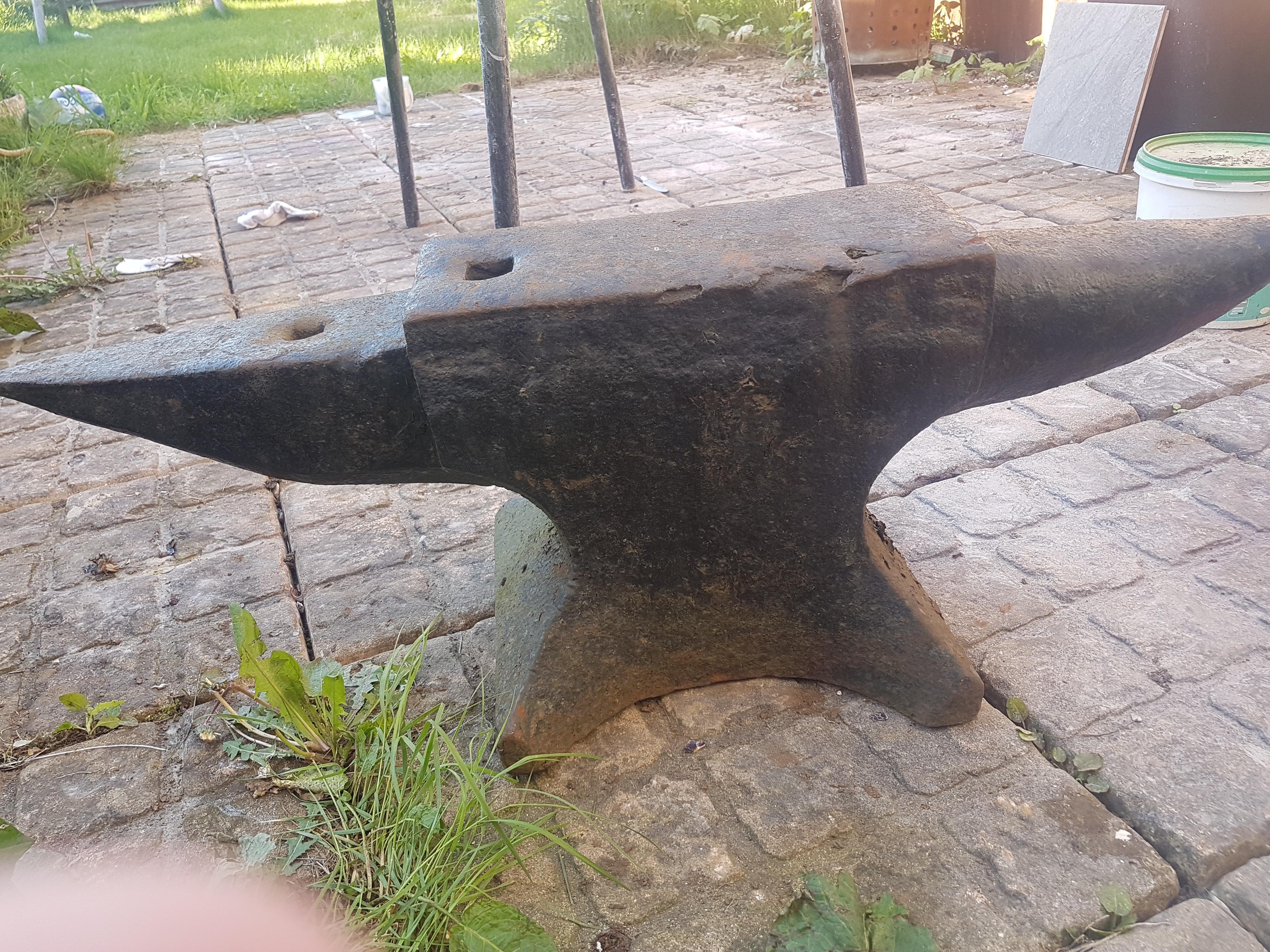

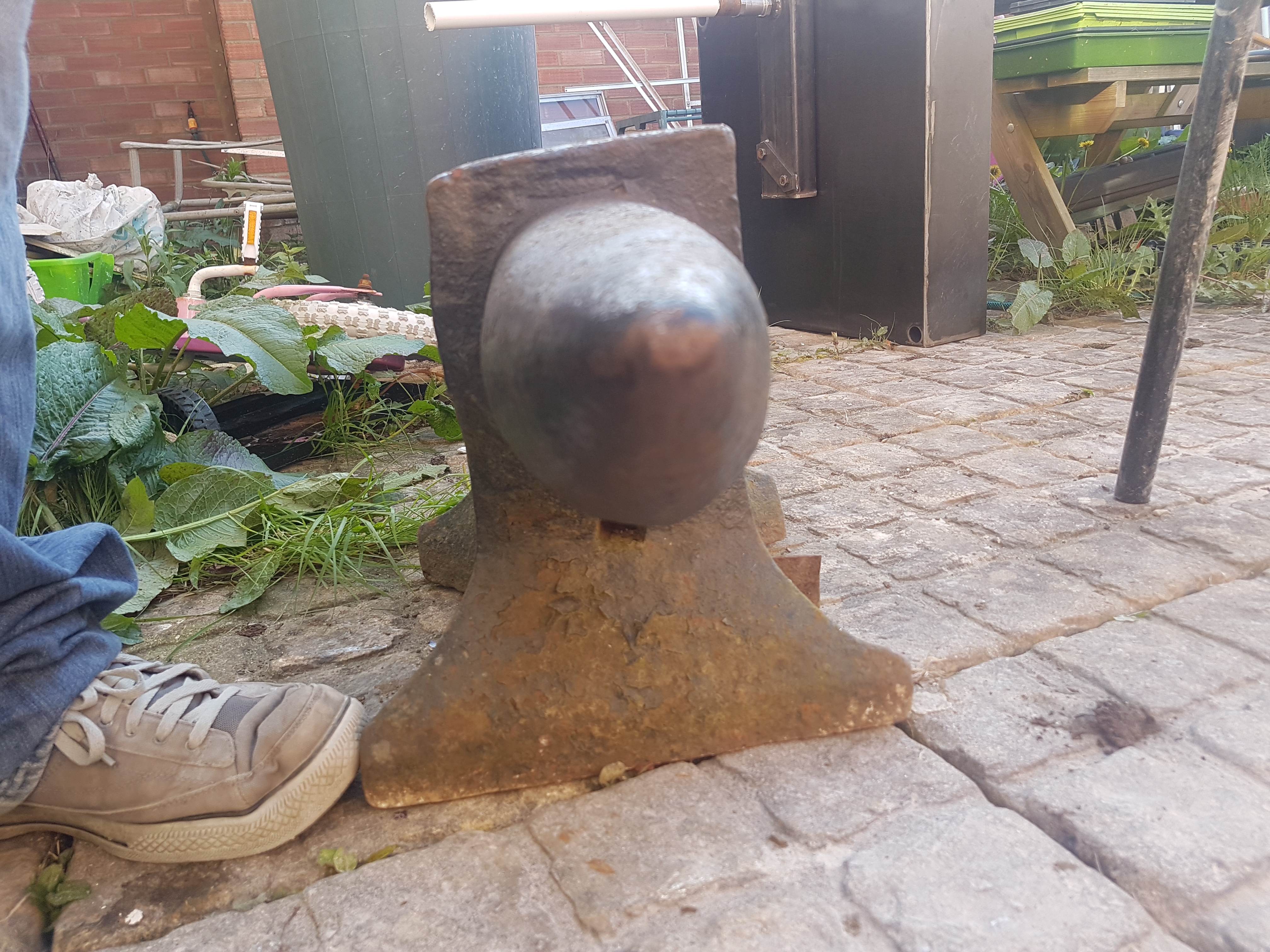

Nick Owen Posted May 5, 2018 Author Share Posted May 5, 2018 6 hours ago, the iron dwarf said: and you have not met john yet. go measure your anvil and check for markings at the same time All in good time Drawings are not to scale, just rough outlines but hopefully these measurements should be useful? Excuse the mess in the photos, I'm completely redoing my kitchen so the outside is being used as storage and construction yard She's loud too... Think I might have to do the anvil work inside the extension on I'm going to drive my neighbours loopy Quote Link to comment Share on other sites More sharing options...
Irondragon Forge ClayWorks Posted May 5, 2018 Share Posted May 5, 2018 You can damp that loud ringing down. When it's mounted in the stand a good bead of silicone calking compound under the base will do the trick. Quote Link to comment Share on other sites More sharing options...

the iron dwarf Posted May 5, 2018 Share Posted May 5, 2018 ok, all I needed was 30.5 by 34 and you will want the height of it the size of your hardy holes is something to check so you know if tools will fit tap lightly all over the top to see if the sound changes, these may be areas of delamination, the area where the top has broken away is where you dont want to be using it or that can spread Quote Link to comment Share on other sites More sharing options...
Nick Owen Posted May 5, 2018 Author Share Posted May 5, 2018 Derp. Missed those off of the sketch! The anvil is 32.5cm tall. The big Hardy hole is 1.25inch square, the small 0.75 inch. Is that the right measurements? Quote Link to comment Share on other sites More sharing options...
the iron dwarf Posted May 5, 2018 Share Posted May 5, 2018 yup, we can make a stand and maybe a hardy tool or two and metric or imperial is ok with me Quote Link to comment Share on other sites More sharing options...
