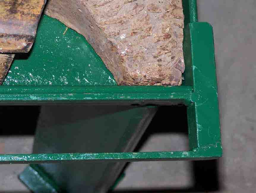

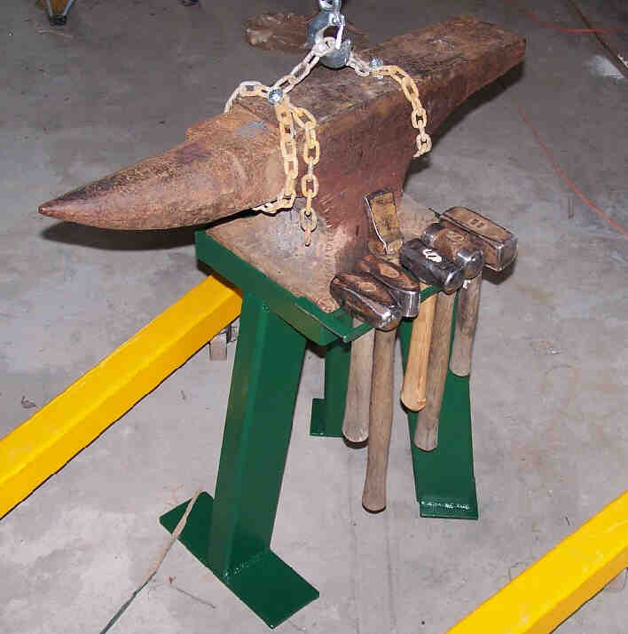

I mount my anvils on steel tripods, the contact is angle iron flange up and only contacts the anvil around the edges. The tong and hammer racks are also angle iron but are notched and sized to wedge between the anvil foot and stand rim. It isn't anymore perfect than most anything I make but it works nicely. With the racks wedged on I can lift it all with the engine hoist I move heavy stuff with or I can tap the racks out, lift the anvil out making it light enough to move it a piece at a time by hand.
Pics follow, it's in the engine hoist, either being loaded in or pulled from the truck.
5ae5e44568e17_Anvilstand01s.JPG.5dcb8c52517775d99f2e22e0f49114ff.JPG 5ae5e452c222f_Hammerrack01.JPG.755023dcd8910573ccb79b75904658d6.JPG
