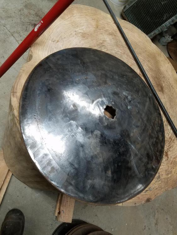

Mellin Posted April 10, 2018 Share Posted April 10, 2018 What is the name of this agricultural doohickey i picked up 4 they make great bases for vise or grinder stands Quote Link to comment Share on other sites More sharing options...
Terry Humphries Posted April 10, 2018 Share Posted April 10, 2018 Disc blade Quote Link to comment Share on other sites More sharing options...
ThomasPowers Posted April 10, 2018 Share Posted April 10, 2018 Usually high carbon steel so be sure to follow the welding high carbon steel rules when welding to it! Quote Link to comment Share on other sites More sharing options...
Charles R. Stevens Posted April 10, 2018 Share Posted April 10, 2018 It is the blade from a disk harrow. Most often refers to simply as a disk. The make handy cooking pans for such things as paella (often called cowboy waks, but they are a bit thick for the localized hot spot) and the warn 24” ones are handy to either drop in the bottom of a 22.5” wheel as a fire bowl. They make nice camp fire bowls if placed on a trivet as well. Quote Link to comment Share on other sites More sharing options...

Mellin Posted April 10, 2018 Author Share Posted April 10, 2018 Thank you! I might go back and pick up all the "good" ones they are only .30 a pound. I will also read high carbon welding procedures. Quote Link to comment Share on other sites More sharing options...
Charles R. Stevens Posted April 10, 2018 Share Posted April 10, 2018 Basacly preheat and and slow cool. Quote Link to comment Share on other sites More sharing options...
Mellin Posted April 10, 2018 Author Share Posted April 10, 2018 I also got some blades that are flat with a single bevel sharp edge put on it they are considerably smaller. I can get pictures. I figure it’s the same kind of tool something that rolls and cuts stuff. Quote Link to comment Share on other sites More sharing options...
Mellin Posted April 10, 2018 Author Share Posted April 10, 2018 I am assuming a hand torch for the preheat, for the slow cool should I try to wrap it in that cloth stuff for insulating forges (that I cannot for the life of me remember the name of) and maybe stuff it under the cupped portion too or just hit with the torch for a while after welding. Quote Link to comment Share on other sites More sharing options...

ThomasPowers Posted April 10, 2018 Share Posted April 10, 2018 Welding indoors is not obnoxious? The basic idea is that you don't want cracking in the HAZ due to the nonwelded mass pulling heat out and "quenching" areas that are above the critical temp. When we preheated anvils for doing a Gunter repair on them we used weed burners (and an IR temp gun to make sure they didn't overheat!) Quote Link to comment Share on other sites More sharing options...
Mellin Posted April 10, 2018 Author Share Posted April 10, 2018 I don’t think it’s too bad in a normal situation to weld inside but I guess a couple charcoal briquettes shouldn’t be too terrible how long am I looking to slow the haz cool down to, I guess I don’t know the alloy because that may be a relevant question. side note if anyone knows the name of the set of books about metal alloys and their properties I want to buy them Quote Link to comment Share on other sites More sharing options...
ThomasPowers Posted April 10, 2018 Share Posted April 10, 2018 I find that old copies of the ASM handbooks generally do fine for the types of things I am doing. New ones have breath taking prices...Bladesmithing books usually discuss the alloys they work with. Machinerys Handbook has a list of alloys and what they would be good for, Welding texts discuss how to weld certain alloys. What is exactly is your need? The idea is to keep it above or at a good tempering temperature for the alloy till it cools past the critical temp. (So if any parts accidentally harden they automatically get the temper drawn) If you don't need the hardness err on the higher drawing temps. And using charcoal indoors IS A BAD THING!!!! Please Don't Do It! (Unless you have happened to buy the largest NIMBA anvil and willed it to me in your will; then doing unsafe things is strongly encouraged---Can I get you some deep fried potatoes to go with the steak and eggs you are eating while parachuting backwards on a motorcycle from a low height into a barrel full of rattlesnakes going over a tall falls? Seconds?) Quote Link to comment Share on other sites More sharing options...
Mellin Posted April 10, 2018 Author Share Posted April 10, 2018 That settles it, ill preheat with a torch and set on the wool stuff. It should stay hot long enough. Quote Link to comment Share on other sites More sharing options...

Mellin Posted April 11, 2018 Author Share Posted April 11, 2018 8 hours ago, ThomasPowers said: What is exactly is your need? I just want it on hand I have certain chemistry texts and mechanical engineering books for various reasons. As to the concerns about K wool, I agree that it poses hazards that I would not expose others to however when I worked with it previously I used a 3m p100 respirator, nitrile gloves and a full face shield. I understand the risks but I also know precautions need to be taken into consideration. I would like a better option for sure but I don’t have the ability to use charcoal briquettes. I will look into heat treating processes. Quote Link to comment Share on other sites More sharing options...
Charles R. Stevens Posted April 11, 2018 Share Posted April 11, 2018 Jerry, evolution has led us to the huffing of condoms and the eating of tide pods.... that said I concur he is free associating, you and I chose to keep out crazy better concealed.(at least the first time we meet some one) The small flat disks are coulter wheels usually used on no till drills Quote Link to comment Share on other sites More sharing options...
Frosty Posted April 11, 2018 Share Posted April 11, 2018 I thought the Tide pod fad was over in favor of something dumber. Never heard of huffing condoms or are they using them to hold a gas, mist, etc? I am just so out of the modern get high chemicals loop. Yeah, I like to get to know someone a little before I let my imagination lose on them. I don't suffer from insanity I thoroughly enjoy it. I see you are free associating Mellin, good you had us worried. I don't have so many friends I can afford to lose one if I can help it. A lot of the things you were brainstorming were just plain dangerous, a couple for everybody in the house. Frosty The Lucky. Quote Link to comment Share on other sites More sharing options...
Mellin Posted April 11, 2018 Author Share Posted April 11, 2018 I can’t even begin to believe the stuff people are doing now a days such stupidity, that’s a complaint I’m sure every generation says about the next but this last 17 years has been a downward spiral of stupid I looked up a coulter wheel and one of the results was almost exact except mine are all shiny maybe even polished. What type of steel generally are they made of. Quote Link to comment Share on other sites More sharing options...
