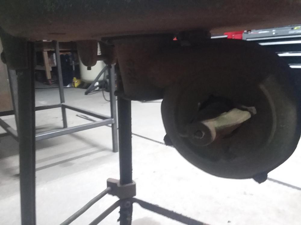

  10. So I found another semi identical forge This has many identical properties to mine the casting numbers on the blower and the u in the pan casting I can see I'm missing a few bigger gears and pulleys. I can go out with the boss next time he goes to clean the acreage to try and locate them but it gets dark too early and everything is frozen. Is it a better idea to just buy a cheapo Amazon blower and duct it in?

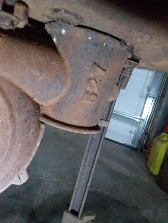

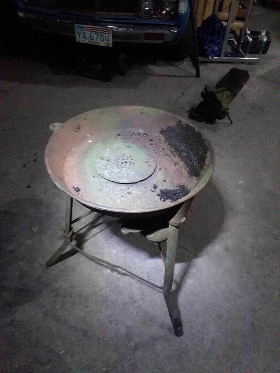

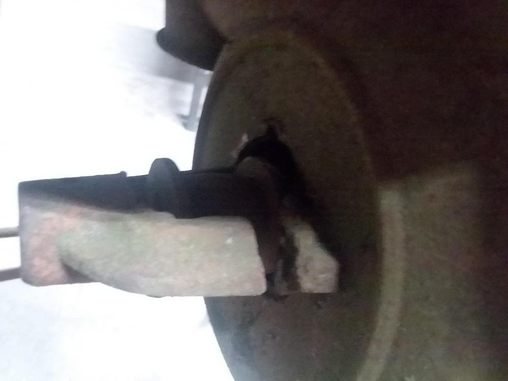

  11. So I pulled this old hunk of metal out of the ground and found out from a member here it's called a rivet forge. The only mark on the body is a "U" cast into the pan. A piece of the blower housing has been cut through with what looks like an oxyfuel setup. The blower has a smooth wheel that turns freely and spins whatever is inside. 526 and 527 are the numbers in the casting of the blower. One can only assume that pieces are missing. For starters the drive mechanism for the blower. There's a bracket on the underside next to the "right" leg, no idea what went there. Also one hole on the top lip. As for claying the forge there's a ton of ways I see ranging from not claying and having a thick bed of coal to using common soil clay and then sand concrete mixes. I don't know if I honestly plan on coal forging any time soon, i don't know the first thing about it but I would prefer to get this ol boy back in usable condition.

  14. Warning a few pictures I took half a day off working the mill to help my boss clean out some land and got some goodies. 6 rolls of various types of barbed wire A small lube can that might become a forge body A larger texaco lube tube that might become a forge body An old propane can that might become a forge body That's it for the "small" things I also pulled what looks like a solid fuel forge out of the ground and a small bench vise that is pretty rusted together but I reckon it will loosen up with some tlc I am pretty interested in seeing if that is a forge.
