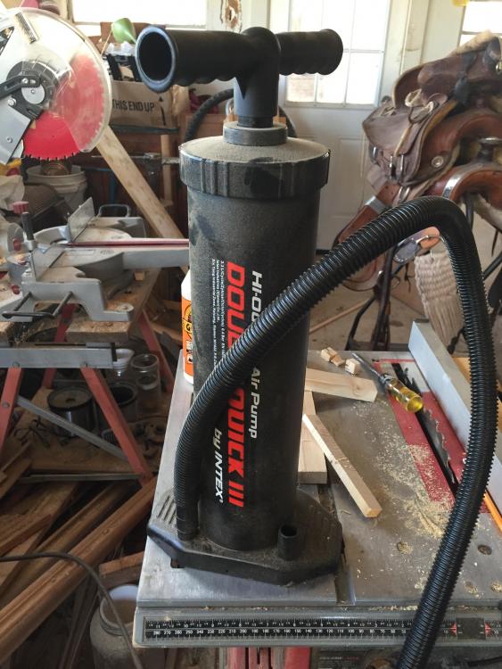

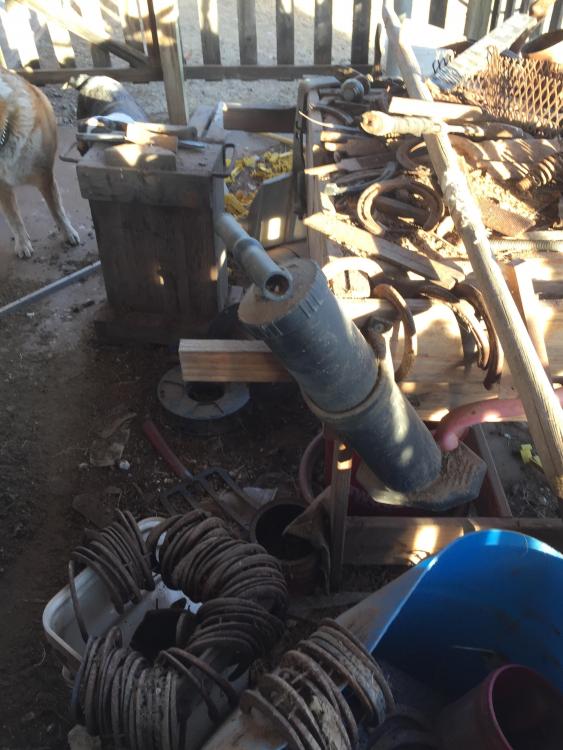

Charles R. Stevens Posted February 9, 2018 Share Posted February 9, 2018 I find this to be a perfectly usable air supply for charcoal Quote Link to comment Share on other sites More sharing options...
