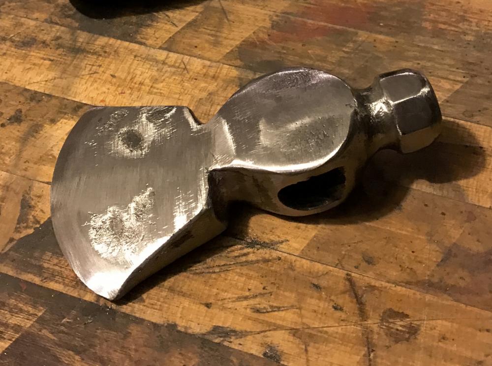

MilwaukeeJon Posted October 30, 2017 Share Posted October 30, 2017 Making a small ax/wedge to use when splitting wood for handles. From a rusted old ball peen hammer (pre-1950). Still have some polishing left to do although will leave in the black when done, not all shined up. Thoughts on the best heat treating approach? Quote Link to comment Share on other sites More sharing options...
Michael Cochran Posted October 30, 2017 Share Posted October 30, 2017 Depending on how tough it is you might want to try using it with it normalized and see if it actually needs to be hardened. Unless you're going to be using it to split some kind of super hard exotic woods or splitting off large pieces of hardwood you'll probably be ok without a harden and temper if the hammer was made from decent steel. Quote Link to comment Share on other sites More sharing options...
MilwaukeeJon Posted October 30, 2017 Author Share Posted October 30, 2017 Thanks Michael Quote Link to comment Share on other sites More sharing options...
rhitee93 Posted October 30, 2017 Share Posted October 30, 2017 I don't really have the experience with axe heads to answer this one, but I would have thought bringing the edge area up just past the transition temperature (look for the shadows) and a heated canola oil quench would work pretty well. Temper it a couple of cycles at increasing temps until you get to where it can just be sharpened with a file. Of course, this assumes a lot about the steel the hammer head was made from... Quote Link to comment Share on other sites More sharing options...

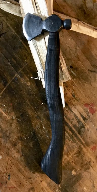

MilwaukeeJon Posted October 31, 2017 Author Share Posted October 31, 2017 Did a heated safflower oil quench of the blade (1/2” or so). Here it is....fun little splitter: Quote Link to comment Share on other sites More sharing options...
rhitee93 Posted October 31, 2017 Share Posted October 31, 2017 Neat. I keep meaning to try something like that to make a kindling splitter for the camp fire. I should start looking for a old hammer head! Quote Link to comment Share on other sites More sharing options...
Stitch Posted October 31, 2017 Share Posted October 31, 2017 I use the heated Canola oil treatment after a couple of normalizing cycles. Works great on American ball peens. Quote Link to comment Share on other sites More sharing options...
