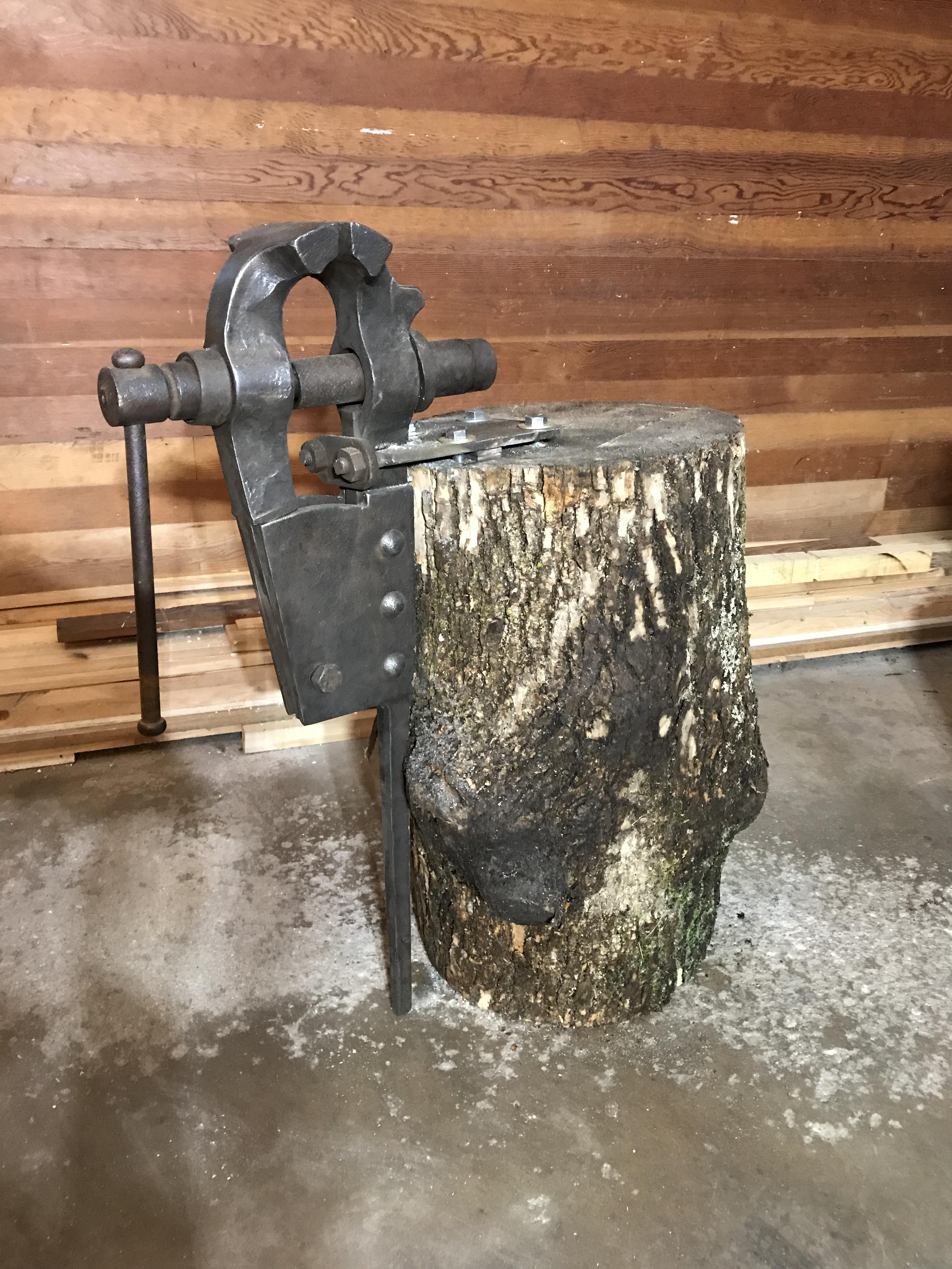

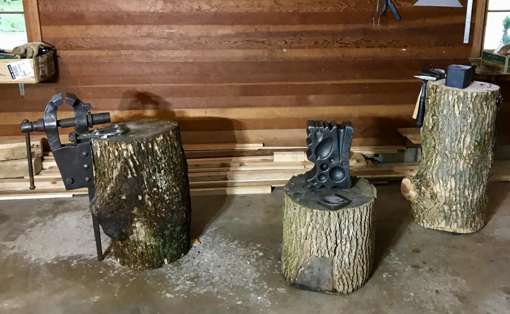

MilwaukeeJon Posted October 11, 2017 Share Posted October 11, 2017 Nice old leg vise just acquired from my friend Aaron Cergol. As with my swage and nailing stations, it is attached to an ash stump. Quote Link to comment Share on other sites More sharing options...

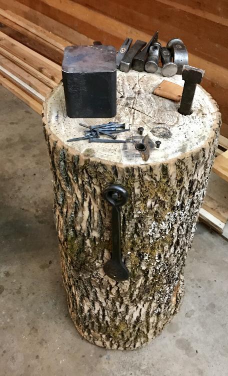

C-1ToolSteel Posted October 11, 2017 Share Posted October 11, 2017 Nailing stations??? Super nice vise! Quote Link to comment Share on other sites More sharing options...
MilwaukeeJon Posted October 11, 2017 Author Share Posted October 11, 2017 Where I forge nails...I’m a newbie so terminology may well be mistaken: Quote Link to comment Share on other sites More sharing options...
Jim Coke Posted October 11, 2017 Share Posted October 11, 2017 Greetings Jon, Great to see our friend AJ is not just sitting around. Have not seen him in a while. Just a suggestion or two. Ya need to support your leg vise at the bottom. ( steel plate ) .. If you make a cut out in your stump for your swage block it makes it easy to do edge work ..Have fun with your new stuff.. Forge on and make beautiful things Jjim Quote Link to comment Share on other sites More sharing options...
Frank Turley Posted October 11, 2017 Share Posted October 11, 2017 Vise looks like it's straight from Germany. Quote Link to comment Share on other sites More sharing options...

Mark Ling Posted October 12, 2017 Share Posted October 12, 2017 I really like that vice! Nice nailing station, I am wanting to make one similar to that one. Littleblacksmith Quote Link to comment Share on other sites More sharing options...
Daswulf Posted October 12, 2017 Share Posted October 12, 2017 Nice all around, but I'm really in love with that swage block. Quote Link to comment Share on other sites More sharing options...
MilwaukeeJon Posted October 12, 2017 Author Share Posted October 12, 2017 17 hours ago, Jim Coke said: Ya need to support your leg vise at the bottom. ( steel plate ) OK. Is this to keep it from moving around or to give it a hard, solid surface upon which to sit? Thanks in advance. Quote Link to comment Share on other sites More sharing options...
JHCC Posted October 12, 2017 Share Posted October 12, 2017 2 hours ago, MilwaukeeJon said: OK. Is this to keep it from moving around or to give it a hard, solid surface upon which to sit? Thanks in advance. Yes. Quote Link to comment Share on other sites More sharing options...
Jim Coke Posted October 12, 2017 Share Posted October 12, 2017 Greetings Jon, The metal shim on mine is for two different thicknesses of blocks .. Yours only needs a cut slightly larger than your swage. My much larger blocks are set up the same way.. This makes it much easier to work on the edge.. Forge on and make beautiful things Jim Quote Link to comment Share on other sites More sharing options...
Daninghram Posted October 12, 2017 Share Posted October 12, 2017 Is the Swag block new? Is there a place to buy one? Quote Link to comment Share on other sites More sharing options...
MilwaukeeJon Posted October 12, 2017 Author Share Posted October 12, 2017 21 minutes ago, Daninghram said: Is the Swag block new? Is there a place to buy one? Mod Note: Link removed. The swage block can be found on line. Price $300 Plus shipping. Quote Link to comment Share on other sites More sharing options...
