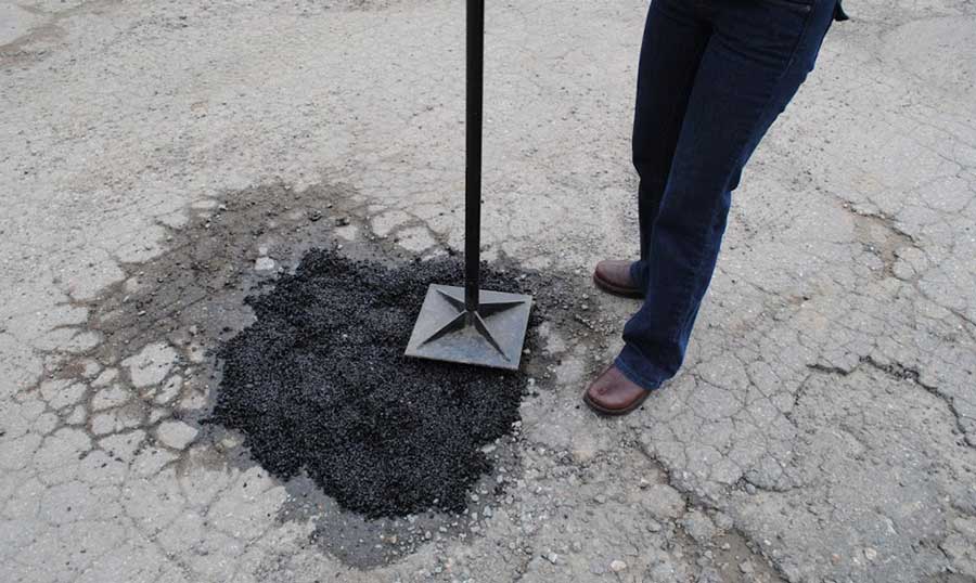

Get one of these and some plywood.  Just sweep/shovel up the pieces.  Cheap.  Done.
Arky,
Great idea.
The tool is called a tamper. It is used to tamper down cold patch for repairing asphalt driveways and other similar uses.
They are usually over priced at hardware stores. But I noticed cheaper ones at Harbor Freight. I have not tried theirs but it is worth a go.
Or you can rent a much heavier "professional" one if you have a lot of coke/coal to crush at one time.

SLAG, my tamper is similar but much heavier than the pic of the example.  Most folks use them to firm up and level soil in foundation footers, flower beds, any other app for flattening any soft surface.  Used it up here in this rocky soil(?) a lot for foundations.  One can find them in second hand tool shops where folks have disposed of them after pounding their arms into submission!!!  They should come with handles on the sides like post pounders...now there's a pregnant idea!!!!....hmmmmmm.
