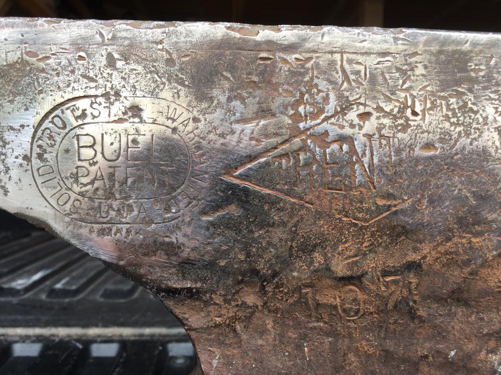

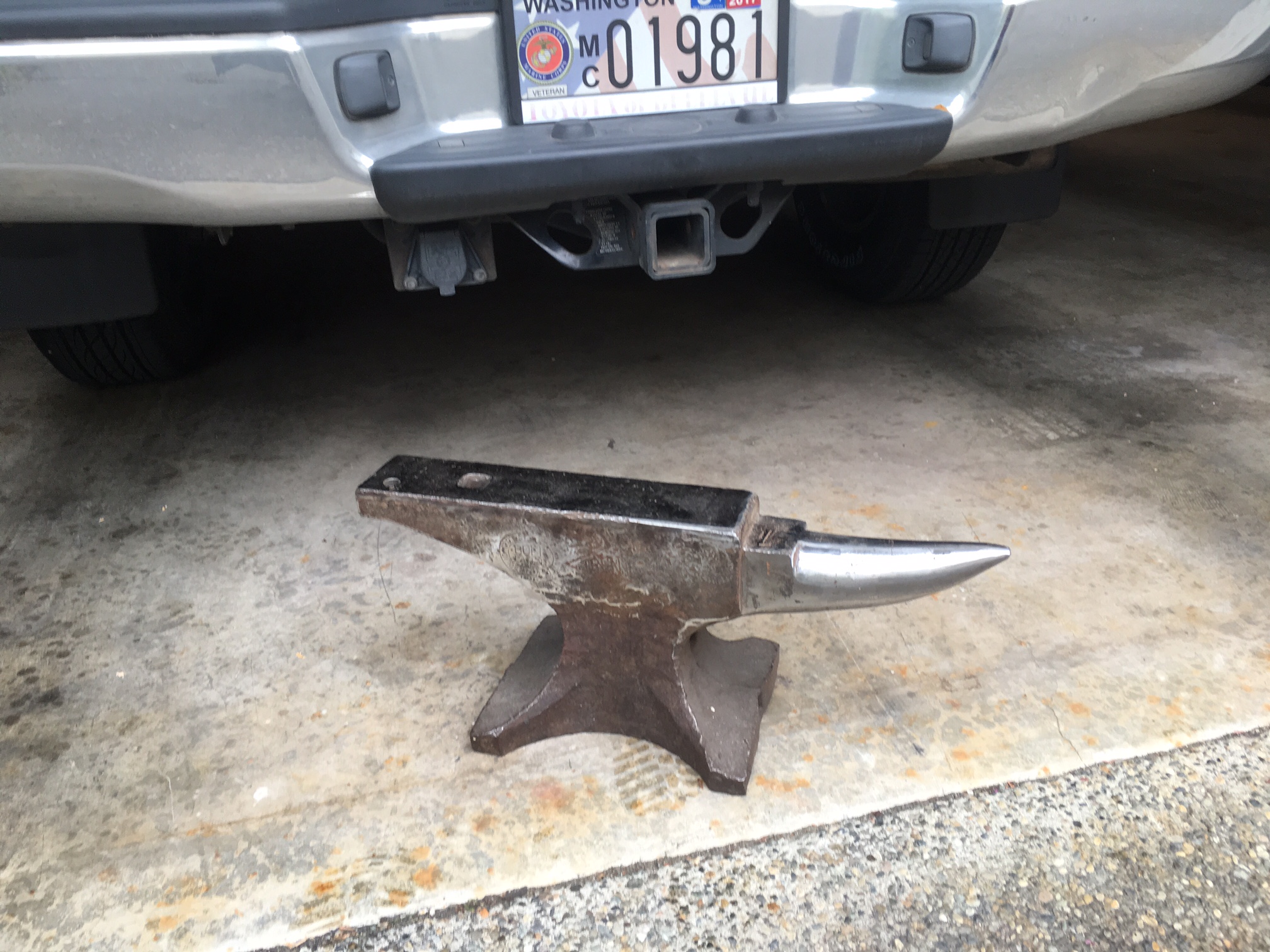

Ecmartin Posted May 15, 2017 Share Posted May 15, 2017 Can someone tell me the date of my Trenton anvil? It's serial number is A11076. It has the diamond with Trenton in it but also has a Buel Patent mark with what looks like "Wroght Iron Guaranteed USA" written around the words Buel Patent. Any help would be appreciated. Thanks. Quote Link to comment Share on other sites More sharing options...
ChrisPTF Posted May 15, 2017 Share Posted May 15, 2017 Trenton A11076 would be the year 1899 Quote Link to comment Share on other sites More sharing options...
Black Frog Posted May 15, 2017 Share Posted May 15, 2017 Please post a close-up picture of the side logo stamps! Quote Link to comment Share on other sites More sharing options...
Frosty Posted May 15, 2017 Share Posted May 15, 2017 Welcome aboard E, glad to have you. If you'll put your general location in the header you might be surprised to discover hoe many of the Iforge gang live within visiting distance. We LOVE pictures and rarely believe you have a thing if you don't post a pic or two. Frosty The Lucky. Quote Link to comment Share on other sites More sharing options...
Ecmartin Posted May 16, 2017 Author Share Posted May 16, 2017 20 hours ago, Black Frog said: Please post a close-up picture of the side logo stamps! Let me give it a shot. Making things is easy this computer crap is hard. 20 hours ago, Black Frog said: Please post a close-up picture of the side logo stamps! Let me give it a shot. Making things is easy this computer crap is hard. Quote Link to comment Share on other sites More sharing options...

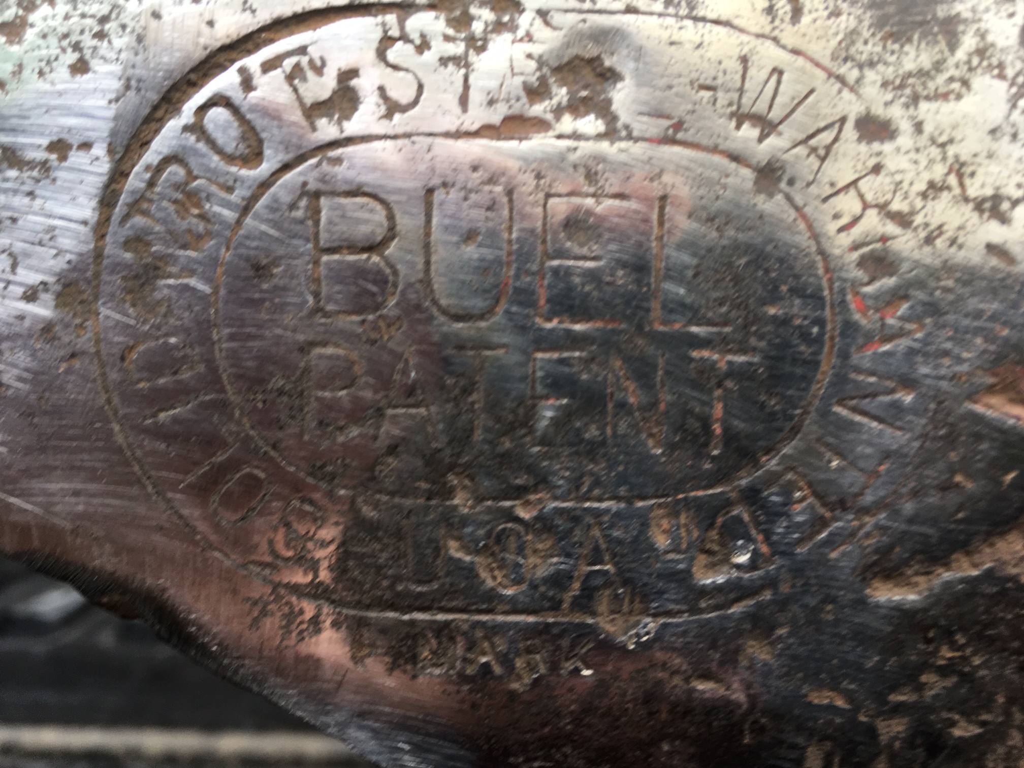

Black Frog Posted May 16, 2017 Share Posted May 16, 2017 Thanks! Do you have a close up picture of the Trenton stamp and the serial number as well? Quote Link to comment Share on other sites More sharing options...
Ecmartin Posted May 16, 2017 Author Share Posted May 16, 2017 Here is the Trenton stamp. I will get a photo of the serial stamp tomorrow. Quote Link to comment Share on other sites More sharing options...
John McPherson Posted May 16, 2017 Share Posted May 16, 2017 Looks to me like it might say "SOLID WRO'T-STEEL WARRENTED USA" around the Buel Patent. Quote Link to comment Share on other sites More sharing options...

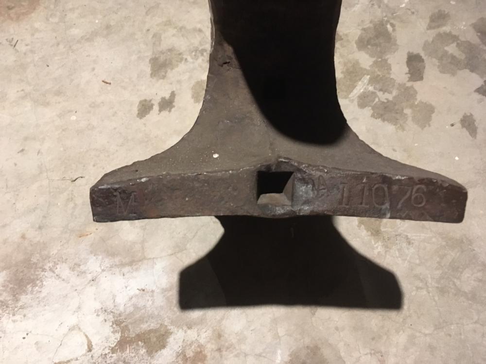

Black Frog Posted May 16, 2017 Share Posted May 16, 2017 Would like to see the serial number picture! I had already recorded a likely SN 11076, and it is not this anvil. Is there a possible "A" in front? Quote Link to comment Share on other sites More sharing options...
Ecmartin Posted May 16, 2017 Author Share Posted May 16, 2017 Yes there is an A in front of the serial number. What does that mean? Quote Link to comment Share on other sites More sharing options...
Black Frog Posted May 16, 2017 Share Posted May 16, 2017 I was wondering if possibly part of the the A was being mistaken for the first "1" of the serial number. That mistake happens often on faintly stamped numbers. Looking forward to a picture! Quote Link to comment Share on other sites More sharing options...
Ecmartin Posted May 16, 2017 Author Share Posted May 16, 2017 Here's the serial number it's definitely an A. Quote Link to comment Share on other sites More sharing options...
Black Frog Posted May 16, 2017 Share Posted May 16, 2017 Thank you! Quote Link to comment Share on other sites More sharing options...
Ecmartin Posted May 17, 2017 Author Share Posted May 17, 2017 Thank you for looking into this for me. Does the A change the dating of the anvil? The date isn't really that important to me but I do find it interesting that something that old is still in service. Quote Link to comment Share on other sites More sharing options...
ThomasPowers Posted May 17, 2017 Share Posted May 17, 2017 Anvils are not really considered old until they are 200+ years. *Many* anvils that age and older are still in use. I have one from 1828 I use from time to time. (And yes the A indicates it's from after they restarted the numbering scheme.) Quote Link to comment Share on other sites More sharing options...
Black Frog Posted May 17, 2017 Share Posted May 17, 2017 I've recorded several others in the serial range with similar stamps and placement. The "A" was just a prefix, probably for recordkeeping purposes with other things that have serial numbers. Quote Link to comment Share on other sites More sharing options...
