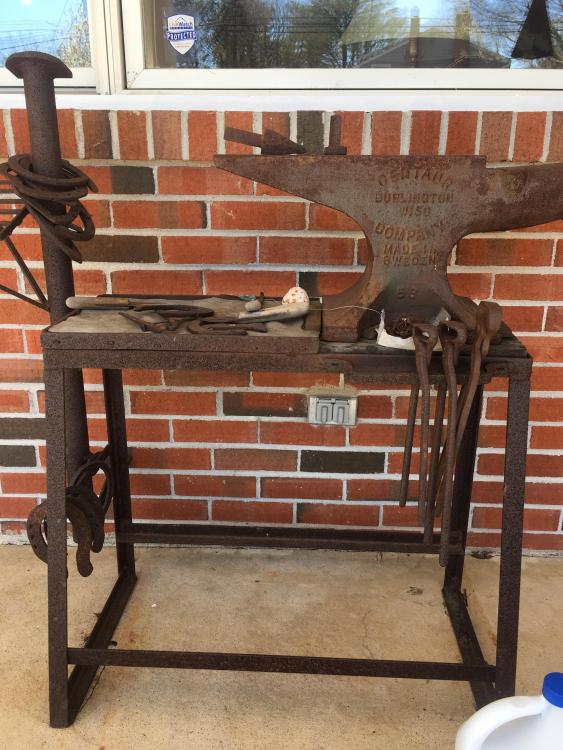

csinesi Posted April 5, 2017 Share Posted April 5, 2017 Farrier Anvil, 125 LB., Centaur model M2066 - with stand and tools. Anyone know what this is worth? Quote Link to comment Share on other sites More sharing options...
brickman Posted April 5, 2017 Share Posted April 5, 2017 Nope, but i'll take it off your hands ;).. i mean you wouldnt want it just laying around taking up space right... In all seriousness this looks like a very nice anvil, should be worth something. Someone here will be able to help you out Quote Link to comment Share on other sites More sharing options...
Frozenoak Posted April 5, 2017 Share Posted April 5, 2017 I'm shopping for an anvil right now and out here anybody that want's to sell a good anvil will ask about $5 a pound, more for heavier. Lesser quality anvils, $3/lb. New or used. I can't speak towards anything else. Quote Link to comment Share on other sites More sharing options...
Jim Coke Posted April 5, 2017 Share Posted April 5, 2017 Greetings Csinesi, Great anvil made for Centaur forge by Kohlswa in Sweden., I have one that is like new and would not sell it for anything under 1k.. They are hard to find now days, What is the asking price? Forge on and make beautiful things Jim BTW. It should weigh 135 Quote Link to comment Share on other sites More sharing options...
C-1ToolSteel Posted April 5, 2017 Share Posted April 5, 2017 Very nice anvil. Centaur Forge used to sell cast steel anvils made by Kolswah which is what you have. Swedish steel is very high quality. Oops, Jim Coke beat me to it! Quote Link to comment Share on other sites More sharing options...
csinesi Posted April 5, 2017 Author Share Posted April 5, 2017 Thanks everyone. It's been on my porch for 10 years and in my family for over 40. I have a friend who really wants it to do some iron work. We are downsizing and I never really thought about parting with it seriously until he asked for it. My father used it in Kansas when he went to Kansas State University to shoe horses to put himself through college. I really had no idea how much it was worth just wanted to check before I gave it away. But I will definitely ask him never to sell it 135 lbs really?? Geez Quote Link to comment Share on other sites More sharing options...
ThomasPowers Posted April 5, 2017 Share Posted April 5, 2017 You can also check what Centaur Forge is selling a similar setup for today; but the swedish anvil is a great one! Quote Link to comment Share on other sites More sharing options...

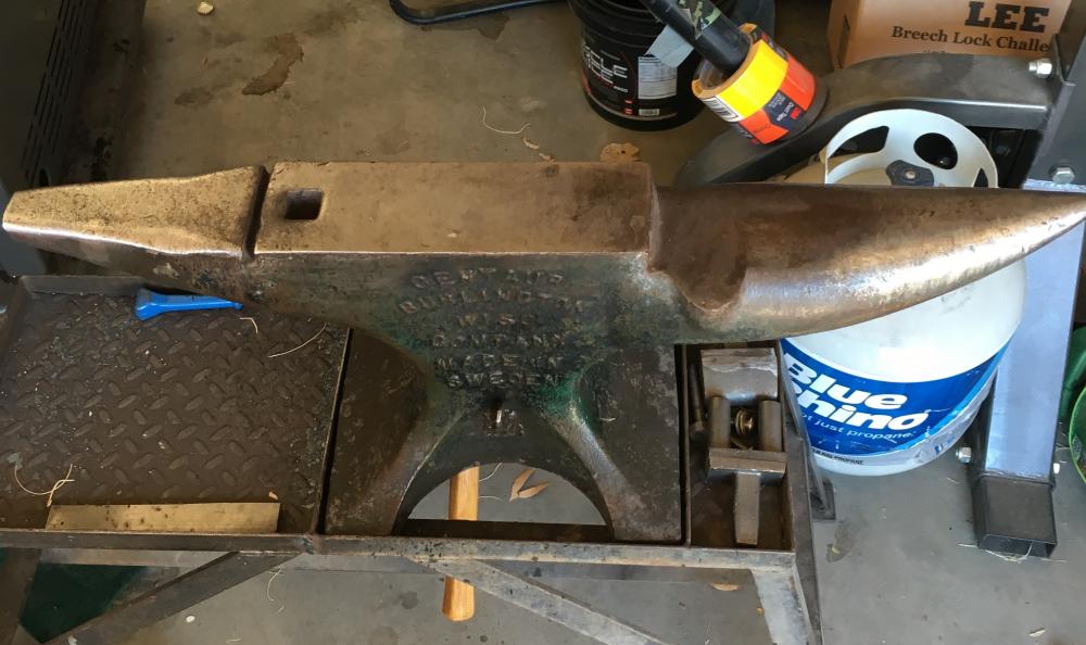

Kenny O Posted April 2, 2018 Share Posted April 2, 2018 I have one similar, but made in USA. Quote Link to comment Share on other sites More sharing options...
Charles R. Stevens Posted April 2, 2018 Share Posted April 2, 2018 Suggest to your friend that he mount it on a more substantial stand for general forging. The light stand was intended to make getting in and out of the truck easer Quote Link to comment Share on other sites More sharing options...

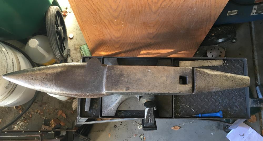

elkshot Posted May 31, 2018 Share Posted May 31, 2018 Kenny O, look at your last pic, it says Made in Sweden. They were made in Sweden by Kohlswa and imported by Centaur in Burlington, Wisc. I have the same anvil I purchased from a retiring Farrier, although th.e anvil has been modified a bit to the farrier's preference...He ground off the back including the pritchel hole. If you look closely at mine ... you can see this is where he did most of his work and even where he filled in the pritchel hole. Quote Link to comment Share on other sites More sharing options...

George Geist Posted June 1, 2018 Share Posted June 1, 2018 21 hours ago, elkshot said: Kenny O, look at your last pic, it says Made in Sweden. Those Centaur anvils were probably about the best horseshoers anvils ever made. They certainly set the standard for all the others to try to match. Was a shame yours was tragically mutilated by somebody trying to copy a Bruce Daniels pattern. It also appears that it's previous owner did Race Horses. George Quote Link to comment Share on other sites More sharing options...
Kenny O Posted June 1, 2018 Share Posted June 1, 2018 I guess it is a Swedish made anvil...those tiny pritchel holes don't help me much though. Quote Link to comment Share on other sites More sharing options...
George Geist Posted June 1, 2018 Share Posted June 1, 2018 Just depends what kind of work you use it for. If you made horseshoes they'd be indispensable. George Quote Link to comment Share on other sites More sharing options...
Marc1 Posted June 1, 2018 Share Posted June 1, 2018 George ... what was the intention in stripping that much off the face of the anvil? How is one supposed to use that shape? Quote Link to comment Share on other sites More sharing options...
George Geist Posted June 1, 2018 Share Posted June 1, 2018 For a period of time, Noted horseshoer Bruce Daniels designed and patented that boattail style of anvil.(late'70s-early'80s) Centaur made a small number for him then the contract to mass produce them went to GE. After they got out of the anvil business I believe AP of Texas made that style for a while. Not sure who, if anybody makes that style now but there are plenty to be found out there. Mr Daniels told me years ago it was to make it easier to work pony shoes over the heel. I'd also be inclined to think it easier to pull side or quarter clips over that tapered area too. It was a very popular pattern for a while but it ran its course like all horseshoeing fads. It was also Mr Daniels who introduced the idea of a groove in the anvil face in his anvils. This was handy for pritcheling out light racing plates. I'm inclined to think personally that he was inspired a lot by the Continental patterns he saw used in Europe that Americans hadn't discovered yet. Clearly his idea appears to be a hybrid. Looks like what you get for offspring when a London marries a Continental. JMNTBCHO that style of heel is a solution in search of a problem. In the case of the pictured butchery it caused problems by eliminating the pritchel holes necessitating carving the groove in it further weakening the heel. The individual who did that should have just gone ahead and bought what he wanted. Another thing about the one pictured is it has lugs arc welded onto it's sides near the base. Those lugs used to come with a swage block hold down marketed by thoro'bred. The hold down came with two springs that attached to those lugs. Unfortunately for many of us, we learned the hard way that those springs never fastened securely enough to keep the holddown secure so we all found other better ways to get it done but not before welding those lugs on lol! Presence of them tells me this guy was practicing swaging race plates, in all likelihood for his racetrack and/or Union test. George Quote Link to comment Share on other sites More sharing options...
