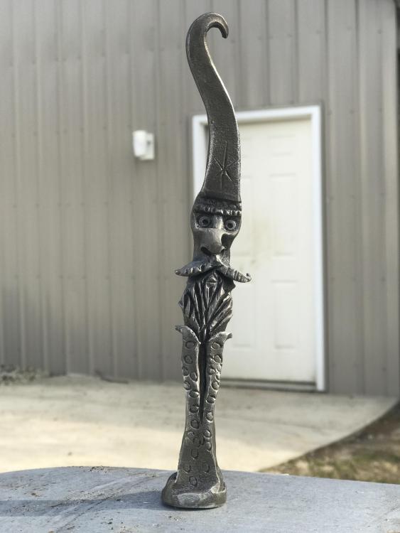

New wizard
New wizard design.
You're getting pretty good at that it looks really nice. I'd reverse direction incising the beard and use a sharper chisel. Having the cuts spread as they go down gives the beard a bushier look. You get a good twirl on the mustaches too, but I think the hair texturing should follow the stache.
Of course that's just my opinion, I'm full of them you know.
Well done, Very.
No. From sqarestock.
I upset the bottom
Thank you!
I'd like to set that out on the table at our farm market where I try to sell some of my things.  Would not sit for long!!
Thanks guys. I think he's upset because I beat on him for an hour or so
Kim Thomas has a great video on making these  on you tube
that's where I learned the nose from
