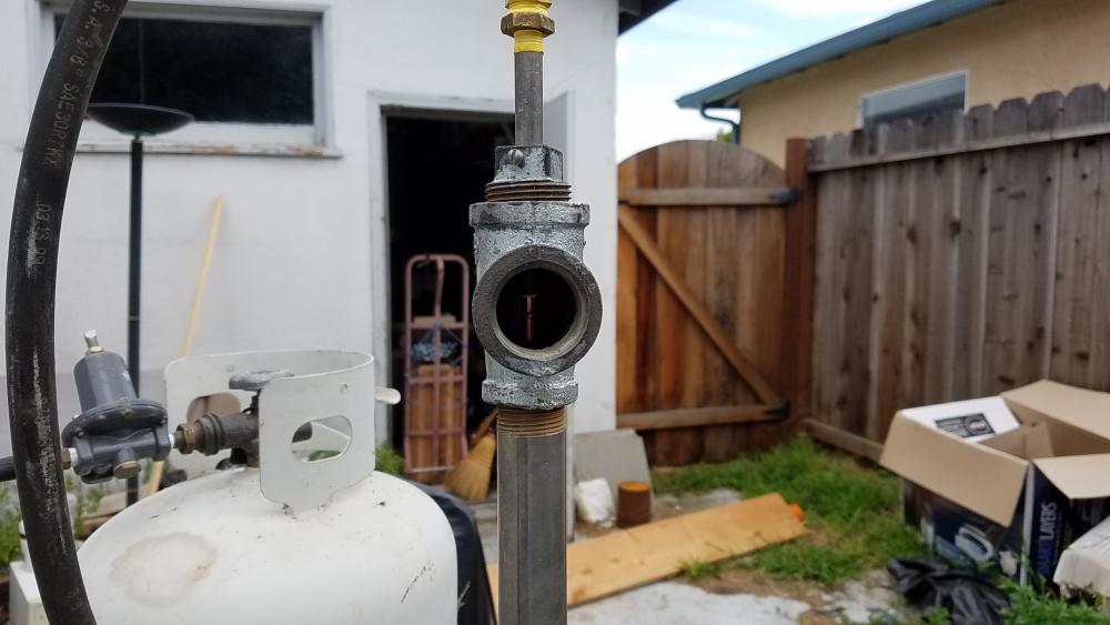

JHCC Posted April 12, 2017 Share Posted April 12, 2017 Go with the vinegar, then. Can you disassemble completely before you soak it? Might be a good idea to remove the non-galvanized pieces first, so that they don't get affected by the acid. Make sure to neutralize with baking soda and wash off the film of zinc acetate before you fit everything back together again. Quote Link to comment Share on other sites More sharing options...
Melw45 Posted April 12, 2017 Author Share Posted April 12, 2017 Pulled it apart last night. My wife gave me a Tupperware container large enough for all the parts this morning. They are all under vinegar now. Just starting to bubble. Looks like the plating is very thick may take a while. Thanks for looking Mel Quote Link to comment Share on other sites More sharing options...
Mikey98118 Posted April 12, 2017 Share Posted April 12, 2017 You don't need to remove the zinc coating from everything; not even all the the burner tube. You only need to remove the coating from the last 4" or so, that heats up enough to form metal fumes. I used to use 'galvanized' pipe for spacer rings within the flame nozzles in some of my first burners, because, once the zinc was burned off they fit between the the nozzle and mixing tubes with minimal power sanding. I didn't know about vinegar removing zinc in those days; I just tossed the parts in the barbecue with a few pieces of coke. Very minor gas leaks can turn into very major problems. Also, the tiniest gas leaks around the gas jet can completely destabilize some burners. For some reason gas leaks around the jets in linear burners aren't as serious as in jet ejector designs. The best policy is to just use gas rated tape or goop to seal all gas joints in the first place. Quote Link to comment Share on other sites More sharing options...
Melw45 Posted April 15, 2017 Author Share Posted April 15, 2017 (edited) .Got the parts out of the vinegar last night. The burner tube was all clean. The burner tube had a raised ridge where it was cut and threaded I ground it off on both ends. The conduit coupler I have for a flare did not clean just went dull. It was shiny before the vinegar. I don't think it is galvanized. Maybe nickel plated. Put it all back together today and found no leaks. Fired it up and it would only burn if I blocked more then half the air intake. Tried changing the flare position as well as the reg settings with the same results. Thanks for looking. Mel Edited April 15, 2017 by Melw45 Spelling Quote Link to comment Share on other sites More sharing options...

Frosty Posted April 15, 2017 Share Posted April 15, 2017 The couplers you're using instead of flares aren't plated, you're okay there. However when you deburred the pipe you reduced friction and back pressure significantly, it's inducing more combustion air than it needs so you have to choke it to get it to burn. Try a larger mig tip. It's drawing really well give it more gas. This is a good thing even if you have to trim the next larger mig tip down to tune it again, it'll put more air and fuel in the forge per second making more heat. You can always turn the regulator down if it's too hot. Your forge now has a higher performance burner. Congratulations. Frosty The Lucky. Quote Link to comment Share on other sites More sharing options...
Melw45 Posted April 15, 2017 Author Share Posted April 15, 2017 7 hours ago, timgunn1962 said: Was that in the forge, or out of it? Out. Mel Thanks Frosty. I have. A .35 tip in there now. Did not trim it. Will try a larger one. Mel Quote Link to comment Share on other sites More sharing options...

Frosty Posted April 19, 2017 Share Posted April 19, 2017 Go up a little at a time. No point in trimming the jet when it's already inducing too much combustion air. Trim it when it's burning too rich. Frosty The Lucky. Quote Link to comment Share on other sites More sharing options...
Melw45 Posted April 19, 2017 Author Share Posted April 19, 2017 Thanks Frosty. Was going to try it with some of the intake blocked off. I want to see if being in the forge makes a difference. Not wanting to trim the mig tip if I don't have to. Mel Quote Link to comment Share on other sites More sharing options...
Frosty Posted April 19, 2017 Share Posted April 19, 2017 Sure you can choke it but you have a burner capable of making more heat faster once you give it more fuel. You can always turn the PSI down. Frosty The Lucky. Quote Link to comment Share on other sites More sharing options...
Melw45 Posted April 19, 2017 Author Share Posted April 19, 2017 7 hours ago, Frosty said: Sure you can choke it but you have a burner capable of making more heat faster once you give it more fuel. You can always turn the PSI down. Frosty The Lucky. I am planning to try that. When I tried with the burner clamped in a vice the flame would blow out. Thanks Mel Quote Link to comment Share on other sites More sharing options...

Frosty Posted April 19, 2017 Share Posted April 19, 2017 4 hours ago, Melw45 said: I am planning to try that. When I tried with the burner clamped in a vice the flame would blow out. Thanks Mel Why do people want their FORGE burner to operate well in a . . . VISE?! Unless you need it as a torch outside a forge what is the point of tuning it to burn in open air? Ron Reil spent a long time and a lot of effort trying to get his burners to burn well in open air and the forge. We'd drifted into our own little burner realms and stopped talking much before he got it to work consistently. I don't know if he did or how much PITA it is, I haven't heard. Nor have I asked I recommend making or better yet buying a torch if you need a torch. 1 hour ago, Latticino said: Of course, that makes perfect sense. Now I should be able to better trim my 1/2" Frosty Tee for my paint can portable forge. Probably need to source a smaller orifice than the current .023 MIG tip though. In lieu of Leurloc needles, has anyone tried to swage down a mig tip around a piece of music wire? Sorry for thread drift... I believe Mike talks about swaging mig tips down and filing them to the correct size. Teenylittlemetal guy (Tristan) makes 1/2" T burners that work a treat and uses metric mig contact tips the general equivalent of 0.023 tips. I tune burners by positioning the jet in the air intake. The throat being the transition point between the intake plenum (T) and the tube. The closer to the throat the less chance the propane jet has to induce combustion air. The farther back the more air and leaner the flame. The more air it induces the more fuel you can feed into the burner. I'm a greedy sort, I want as much heat as a device can generate and maintain an acceptable flame chemistry. I like SLIGHTLY rich, increased CO and all. So as a departure point for tuning a burner I like a mig contact tip Jet that's rich when in or at the throat. Then I start trimming it a LITTLE at a time till I have the flame chemistry I want. After building a few you know what tip to start with and can estimate how deep it should be making fine tuning a matter of filing or sanding the tip the last few thousandths. There are other ways to tune burners, Mike's work best by adjusting the flare depth and using a choke sleeve for fine tuning. Being home built every burner is going to be a little different. Frosty The Lucky. Quote Link to comment Share on other sites More sharing options...

Melw45 Posted April 19, 2017 Author Share Posted April 19, 2017 2 hours ago, Frosty said: Why do people want their FORGE burner to operate well in a . . . VISE?! Unless you need it as a torch outside a forge what is the point of tuning it to burn in open air? That is why I put it away until I could tune it in my forge. I should get to it. Thinks for the insite in to fthe mig tip placement. Mel Quote Link to comment Share on other sites More sharing options...
Melw45 Posted April 19, 2017 Author Share Posted April 19, 2017 Wow with it in the forge it woke up! Would take as much gas as i could give it. Now for some pics. You can just see the mig tip in the burner. The next one is when I had just lit it. My wife came out to see How I was doing and had to take some photos. So you get to see watching a rusty bolt heat up. Next is a hot bolt in the forge. Last photo is what it looked like when I stopped, Kind of a snake shape. While I was rummaging around in my garage I had found some tong shaped things. I recall making them to put metal in to a foundry furnace I made years ago. Kind of worked to put the bolt in and out of the forge. OK I have learned some things, Need real tongs! Need to make the snake head first. This is some seriously hot work. Thanks for looking. Mel Quote Link to comment Share on other sites More sharing options...
