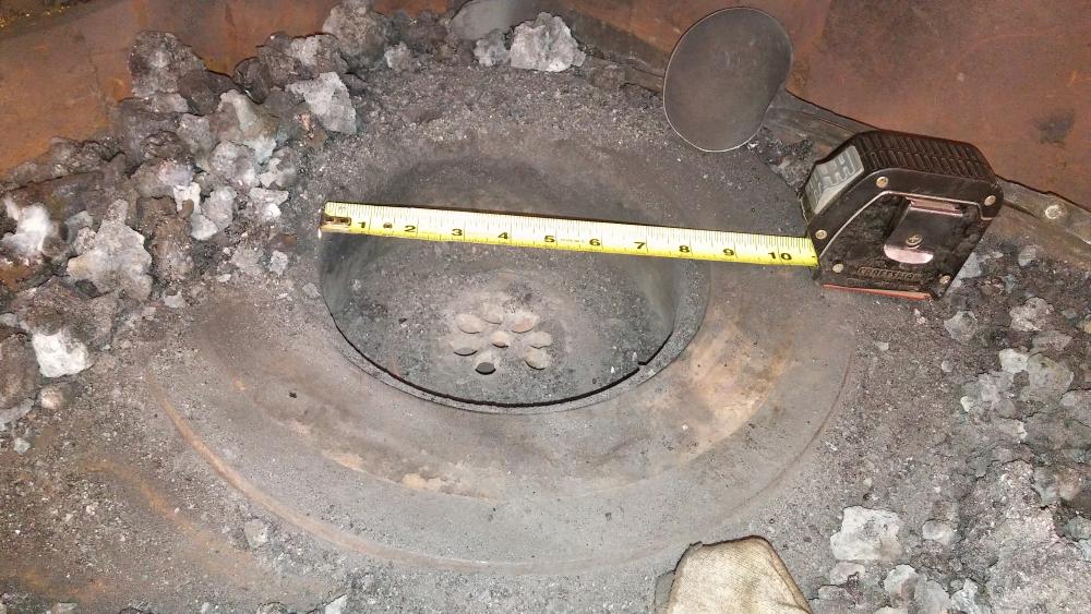

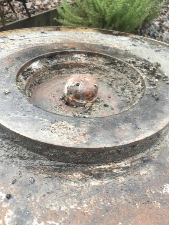

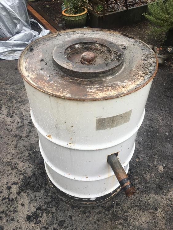

Panterafan Posted February 27, 2017 Author Share Posted February 27, 2017 1 hour ago, ThomasPowers said: The biggest problem most folks have using charcoal is that they are trying to use it just like coal and it ain't! Tweak your forge for charcoal and it will work a lot better than just trying to load charcoal in a coal forge! How can I tweak my forge for charcoal?? Using less air? My forge is just a brake drum forge mounted in a oil drum, with 1-1/4 inch pipe, powered by a hairdryer I got from Goodwill. I took Frostys advice and took some photos, maybe they'll help who knows?? Quote Link to comment Share on other sites More sharing options...
NickOHH Posted February 27, 2017 Share Posted February 27, 2017 Add charcoal and bit less air. I would want to add some sides that, maybe cut the barrel about 3 inches down and flip it over and tack it back to the barrel If your fire pot is just sitting in there . I would also take some clay or fire cement and smooth out the transition to the fire pot to make it easier to scoop the charcoal toward into the fire. Quote Link to comment Share on other sites More sharing options...
Kevin Olson Posted February 27, 2017 Share Posted February 27, 2017 Wow thats some grate/ tuyere. Mabey you should modify like mine. Makes it deeper. This works good for me. Quote Link to comment Share on other sites More sharing options...
ThomasPowers Posted February 27, 2017 Share Posted February 27, 2017 Charcoal needs a deep fire, combine that with the fact that all the charcoal on top of the forge will end up burning; but only that in the stack over the tuyere will actually contribute to heating your metal and you can see that that forge is very inefficient for charcoal. Look up the Tim Lively washtub forge for an example of how to adjust it to use less charcoal to provide more heat. A hair dryer will put out way more air than you need; how are you wasting air to keep the flow down? Quote Link to comment Share on other sites More sharing options...
Panterafan Posted February 28, 2017 Author Share Posted February 28, 2017 Going to stick weld some higher walls onto the brake drum for now. And I am looking into building a charcoal specific washtub forge, or a v forge much like a whitlox. Thanks a bunch guys I'll keep you updated! Quote Link to comment Share on other sites More sharing options...

Charles R. Stevens Posted March 20, 2017 Share Posted March 20, 2017 Charcoal and side blast forges just go to gether, that and less air... You will find that a 3/4"-1" side blast tuyere (2/4" gas pipe is about 7/8") works very well, it's not complicated. A hair dryer is to much air, even a pancake fan from an old PC is usualy over kill, so some method of regulation is nessisary. I just use a T and a valve to waste extra air. Quote Link to comment Share on other sites More sharing options...
