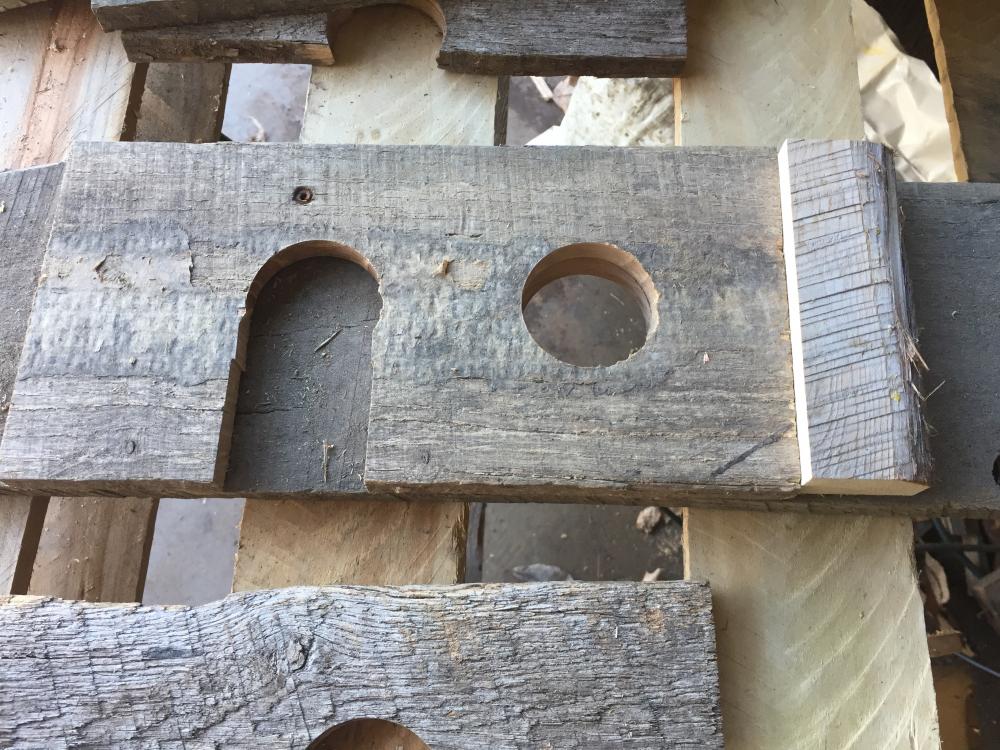

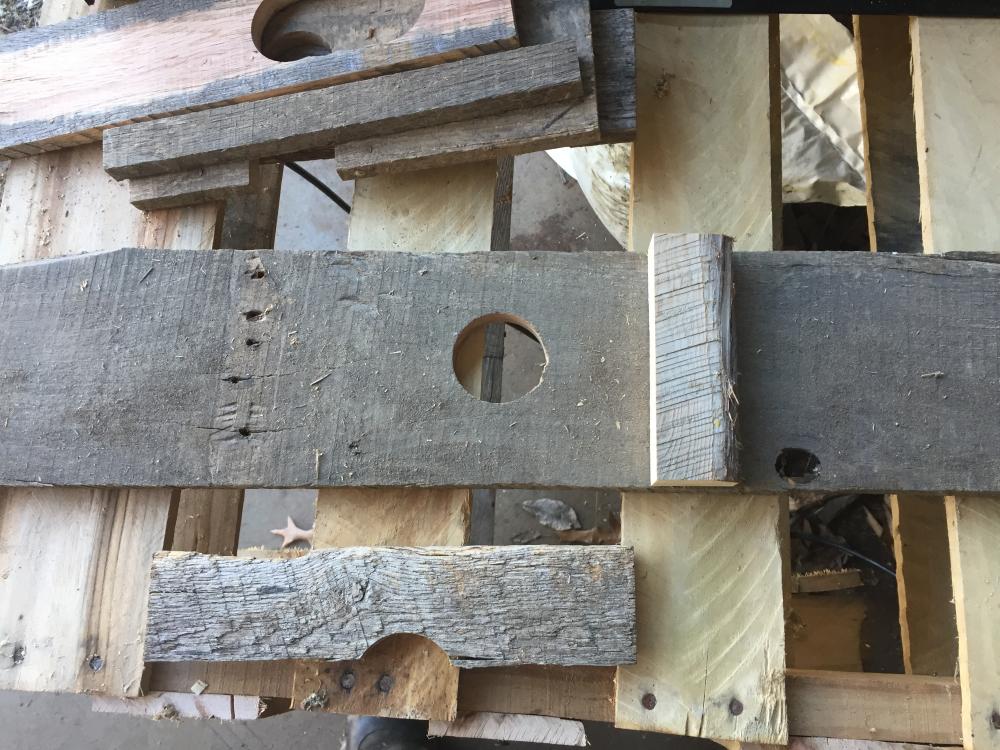

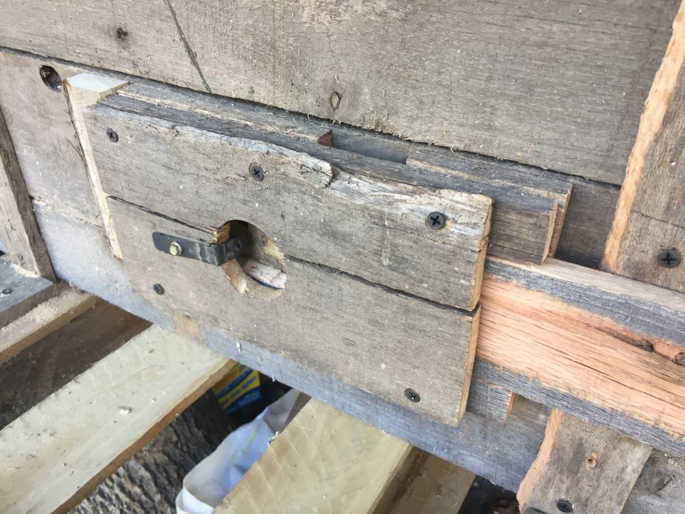

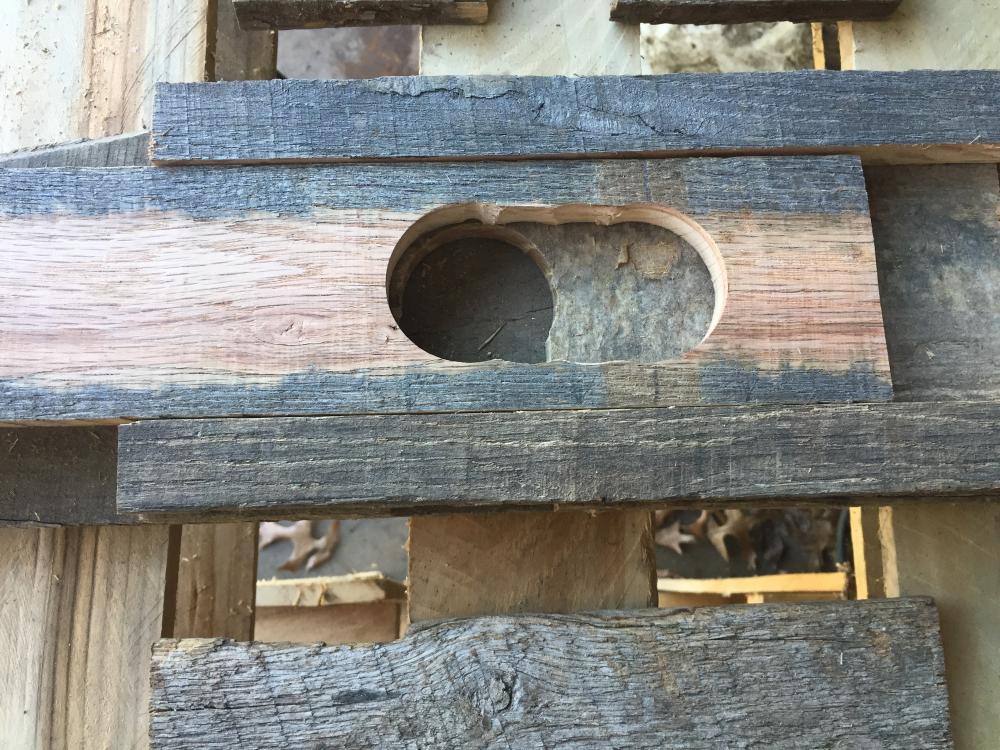

I made this gate valve for my new JABOD forge and thought folks might like to see how the insides work. It was pretty easy to put together, and all the materials were screws and pallet wood that I had on hand already.
Starting with the back board of the forge, I drilled a 2" diameter hole in the middle. I used a big Forstner bit for all the holes, but since the pallet wood was so hard (red oak), I had to hog most of the material from the middle of each hole with a twist bit.
The middle layer has two holes spaced 2" apart: one that directs the blast into the tuyere and one that exhausts the excess air.
The sliding gate has a 2" x 4" oval. When the gate is all the way in, the oval connects the blower with the tuyere. When it's pulled out, the oval connects the blower with the exhaust vent.
Another piece of wood covers the outside and holds the whole thing together. The 2" hole is centered between the tuyere and the exhaust vent.
The little metal clip keeps the gate from pulling out, and there's a little block of wood at the end (see top photo) that keeps it from pushing in too far.

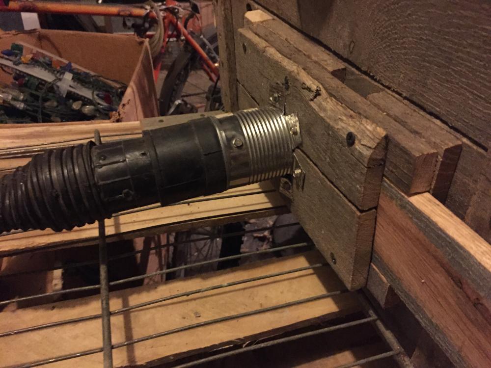

Kind of fancy for a box of dirt isn't it? Pretty slick John, the blower inlet is the round hole visible on the outside in the pics. Yes?
Yes, that's the inlet. I haven't yet figured out how to attach the blower, but then again, I'm not yet sure what the blower actually will be. I'll probably start off with the same shop vac I was using before, but Lisa just got a new vacuum and I'm all set to modify the old one.
Wanna go old timey blacksmitherly? Find a tin can about the right dia to fit whatever blower hose you have. Then find a larger tin can and cut an end out. trace the ID of the small can in the center of the larger lid. When you cut it out with tin snips or a SHARP chisel leave about 1/8" overlap on the inside. AND leave a couple tabs to you can pin, rivet, screw, etc. it all together.
With the lid cut it's easy to pein the extra in to make a lip for reasonable air tightness. If you forgot the tabs solder the assembly together, other wise punch a couple holes and wire, pin, whatever the sophisticated mounting flange to the equally sophisticated custom air connection. Screw or pin it to the air valve.
Everything stays in character.
  • 3 weeks later...
Here's the fitting to attach the shop-vac hose, made from a soup can, a section of shop-vac extension wand, and a gasket of motorcycle inner tube.
And here's a video of a kindling fire going from "no blast" to "full blast" and back.

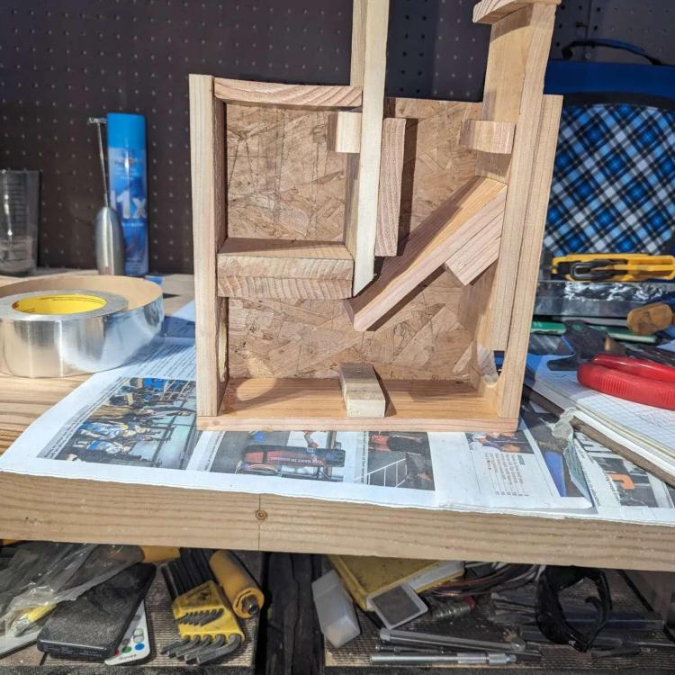

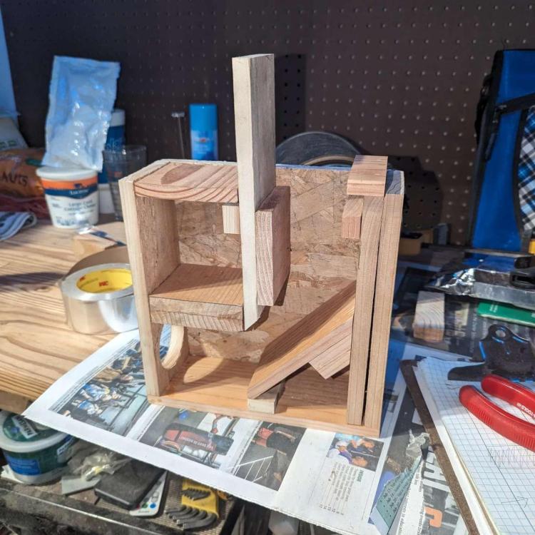

Hey guys, I realize this thread is only about sic and a half years old, so I apologize for resurrecting the dead lol. However I just stumbled upon this and wanted to share my air gate design as well. it actually diverts some of the air instead of just a blockage also has a choke. this is obviously before i closed it all up lol. it works awesome too!
i'm not sure I understand how this wotks.  Could you please describe the air flow and what is the moving paert(s).  I think the moving "gate" is the light colered vertical piece of wood in the top of the box.  Also, what is the advantage of this over a simple buttefly valve other than getting to build a cool wooden gadget?
Thanks.
GNM
Lets see how close I got this. The gate is the assembly on the right with angled board, attached to the slide. The slide closes the hole in the box body when it's in the down position, opening the large square (maybe) vertical air passage. The light colored board makes the valve seat, closing the vertical passage when the slide assembly is raised.
That's what I think I'm looking at but it doesn't tell me which way the air travels.
It's an intriguing valve I'd LOVE to hear how it actually works from the maker. :)
I’m guessing that the air comes in the lower left corner and exits from either the lower right corner (to the forge) or the upper right corner (waste air). It looks like the main control is the slide on the right, which is shown closed in the upper photo (slide down) and open in the upper photo (slide up).  The choke slide (center vertical) is shown open in both photos, but can presumably be slid down to reduce the total air moving through the valve.
In other words, it seems to me that this is a combination of two valves: one of the completely-block-the-airflow type and one of the bleed-off-the-unwanted-air type. It’s an interesting idea, but I’m not sure what benefit such a combination might have.
