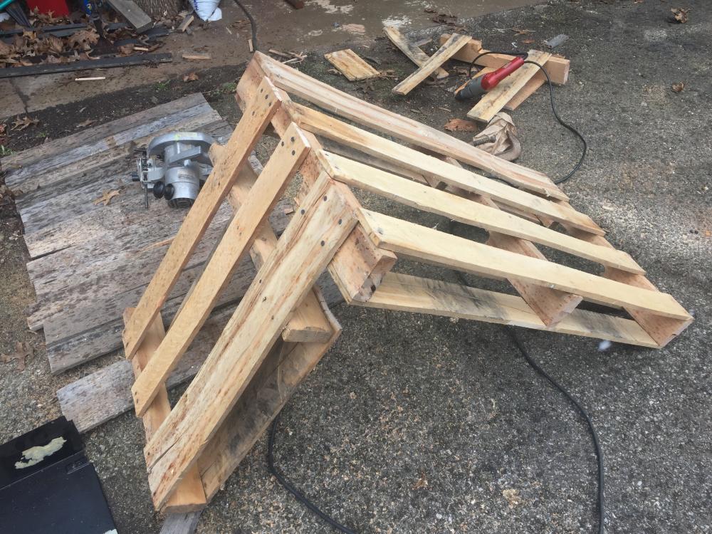

I started by making a base from an old pallet cut to the proper width:
Using the cut-off section for one end:
Legs in the other corners (more pallet wood) and a robust diagonal brace:

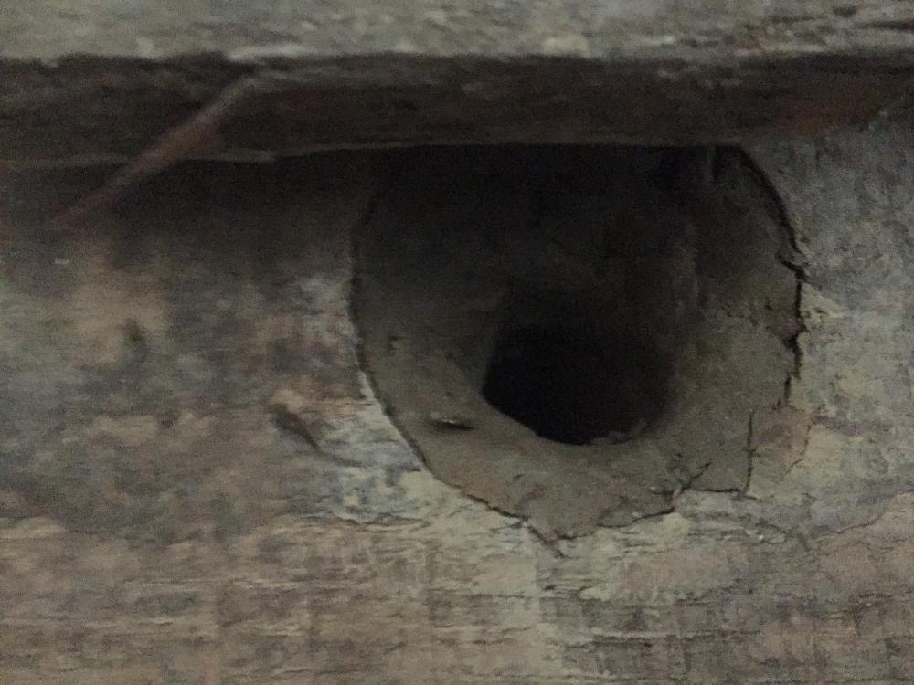

One detail I forgot to mention: the vertical piece of oven side was eventually moved down and had a hole cut in it for the tuyere before I started adding clay.

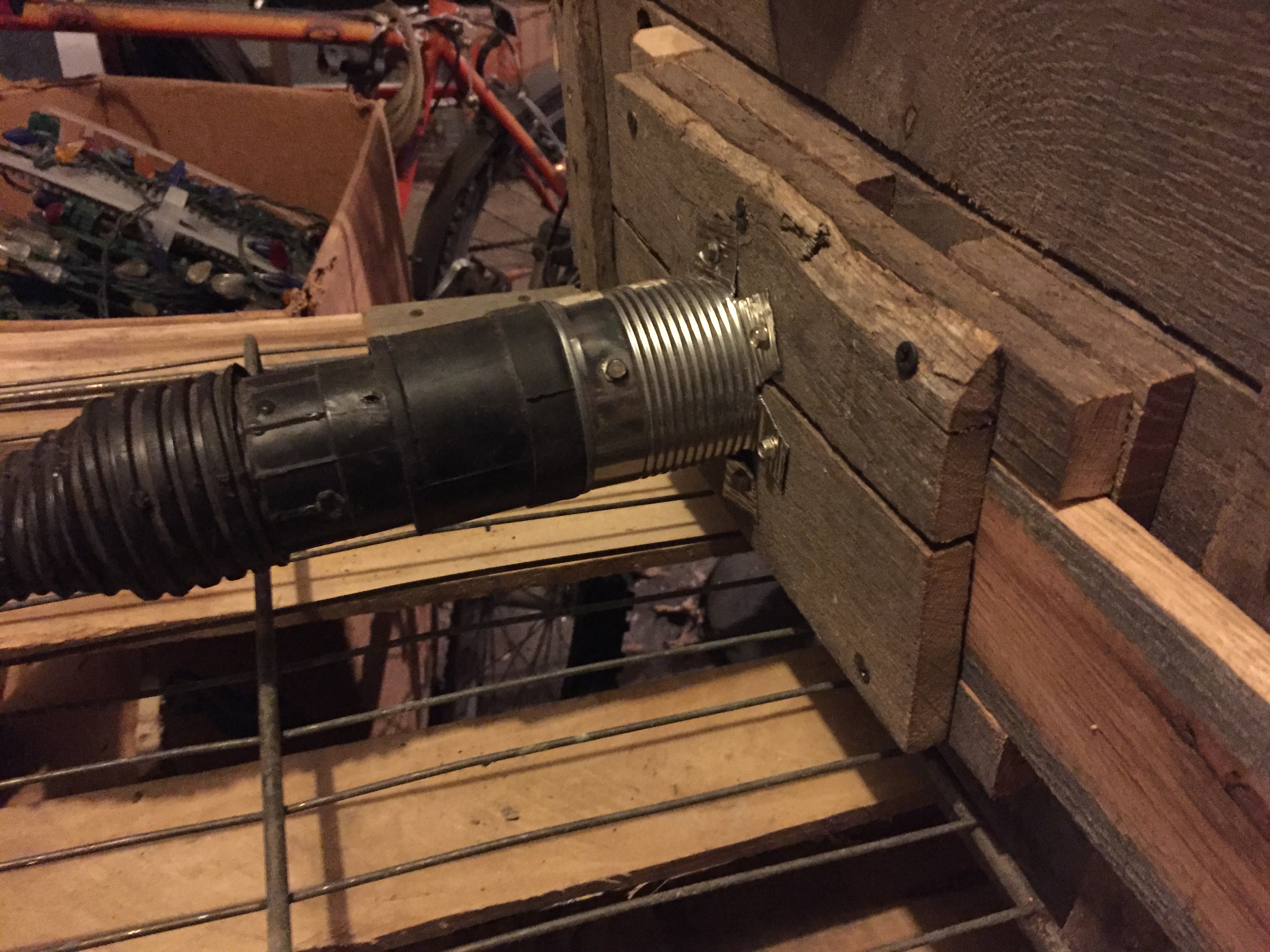

Trying out the gate valve.
A fitting to attach the blower hose to the gate valve.

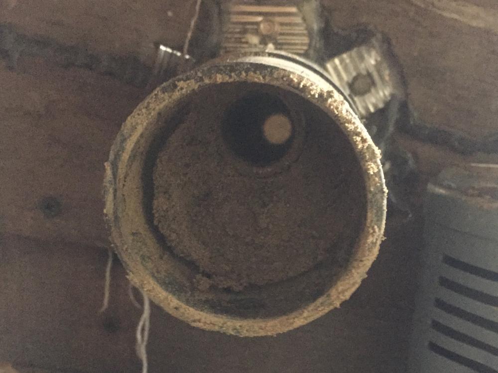

I had used a rag to seal off the hole around the tuyere, where it passes through the wooden back. Unfortunately, I forgot that it was there, and a spark got back to it somehow and set it on fire, right at the end of the forging session. Rather scary, having sparks and smoke coming from where they shouldn't be! I'll need to figure out how to get it out of there before I fire things up again.
So, broke down the gate valve, fished out the rag, and reclayed the transition from the valve to the tuyere.

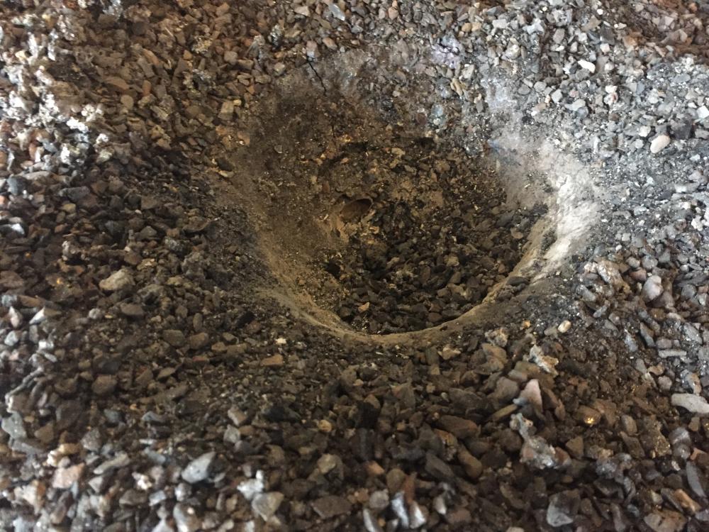

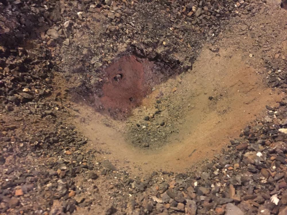

Another forging session yesterday, which went very well. The clinker seems to want to form around and above the tuyere opening as well as at the bottom of the bowl. No idea why, but it's not a major hassle.
Here's the bowl after clean out.
