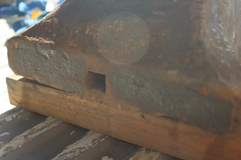

Black Frog Posted October 18, 2016 Share Posted October 18, 2016 The numbers on the side are probably weight stamp, 273 pounds. Any closeup picture of the front foot under the horn? If there was a serial number, that is where it would be. Pictures after thorough cleaning with a wire cup wheel on an angle grinder may provide another hint or two.... Quote Link to comment Share on other sites More sharing options...
Gold Country Forger Posted October 18, 2016 Author Share Posted October 18, 2016 Here they are, I couldn't find anything there.... Quote Link to comment Share on other sites More sharing options...
Jakesshop Posted October 18, 2016 Share Posted October 18, 2016 Just a guess.... Maybe a late model Mousehole? I have one that could be this ones twin but at 150 pounds. Mine does have the serial number on the foot though. Quote Link to comment Share on other sites More sharing options...
John McPherson Posted October 19, 2016 Share Posted October 19, 2016 I have never seen a Mousehole with square feet, always triangular. A better picture of the bottom would let us know if it was a Hay-Budden or not. Quote Link to comment Share on other sites More sharing options...
JHCC Posted October 19, 2016 Share Posted October 19, 2016 Also lacking the typical Mousehole ridge down the underside of the horn. Quote Link to comment Share on other sites More sharing options...
Black Frog Posted October 19, 2016 Share Posted October 19, 2016 John, late MH's had square feet and serial numbers. Still marked stone weight though... Quote Link to comment Share on other sites More sharing options...
Gold Country Forger Posted October 19, 2016 Author Share Posted October 19, 2016 Thank you all for the responses. I am learning more and more as I go along. 6 hours ago, John McPherson said: I have never seen a Mousehole with square feet, always triangular. A better picture of the bottom would let us know if it was a Hay-Budden or not. I have the anvil in my shop now so I do not have pictures on demand, but will take one when I have a chance (also this thing is heavy enough I was having trouble turning it on its side which is why there is just the tilt picture of the bottom). I did give the bottom a fairly close look and could not see any noticeable depression (besides the handling hole obviously). 16 hours ago, Jakesshop said: Just a guess.... Maybe a late model Mousehole? I have one that could be this ones twin but at 150 pounds. Mine does have the serial number on the foot though. I never would have looked at mousehole anvils for this one. I have come up with a few examples that are similar but am having a little trouble getting good info. I'll keep looking but any help would be greatly appreciated! And lastly here is a picture of the collection now that it is (just barley) inside the shop! Quote Link to comment Share on other sites More sharing options...
