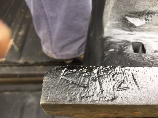

Farmall Posted October 14, 2016 Share Posted October 14, 2016 Just picked up this Trenton. Looks like serial # A 7101 on the right side although it looks like T121 on the left side. Any ideas why it would have two holes drilled through it? Quote Link to comment Share on other sites More sharing options...
Black Frog Posted October 14, 2016 Share Posted October 14, 2016 There would have been one more number on that serial number for that style of logo. A7101x that would be 1907 according to Anvils In America. The holes in the side are odd, as is what looks to be a large bolt head on the underside of the base? Sometimes there was a square handling hole there. Guessing this anvil possibly had a cracked waist and these are the evidence of repairs... Quote Link to comment Share on other sites More sharing options...
Frozenforge Posted October 14, 2016 Share Posted October 14, 2016 It would appear that it has been broken at the waist at some and the 2 holes probably had a metal plate to hold the top and bottom together. The large bolt in the bottom has also been added. It appears that the split has been welded and ground smooth. Unable to tell if it was full depth welded or just surfaced welded. A7101 would make it 1899 but it appears to have another number after the 1 which would make it 1907. Does it have a ring if you tap it with a hammer? Quote Link to comment Share on other sites More sharing options...
Farmall Posted October 14, 2016 Author Share Posted October 14, 2016 Maybe the last # is 2. Looks like maybe the bottom right corner has part of a 2 Quote Link to comment Share on other sites More sharing options...

Farmall Posted October 14, 2016 Author Share Posted October 14, 2016 Has a good ring and rebound Quote Link to comment Share on other sites More sharing options...

Glenn Posted October 15, 2016 Share Posted October 15, 2016 This could be one reason for the hole in the side of the anvil. I have seen one anvil with a bolt hole in the bottom to secure it to a metal work table and prevent theft. Quote Link to comment Share on other sites More sharing options...
Farmall Posted October 15, 2016 Author Share Posted October 15, 2016 Thanks Glenn. That's an interesting Patent. Quote Link to comment Share on other sites More sharing options...
