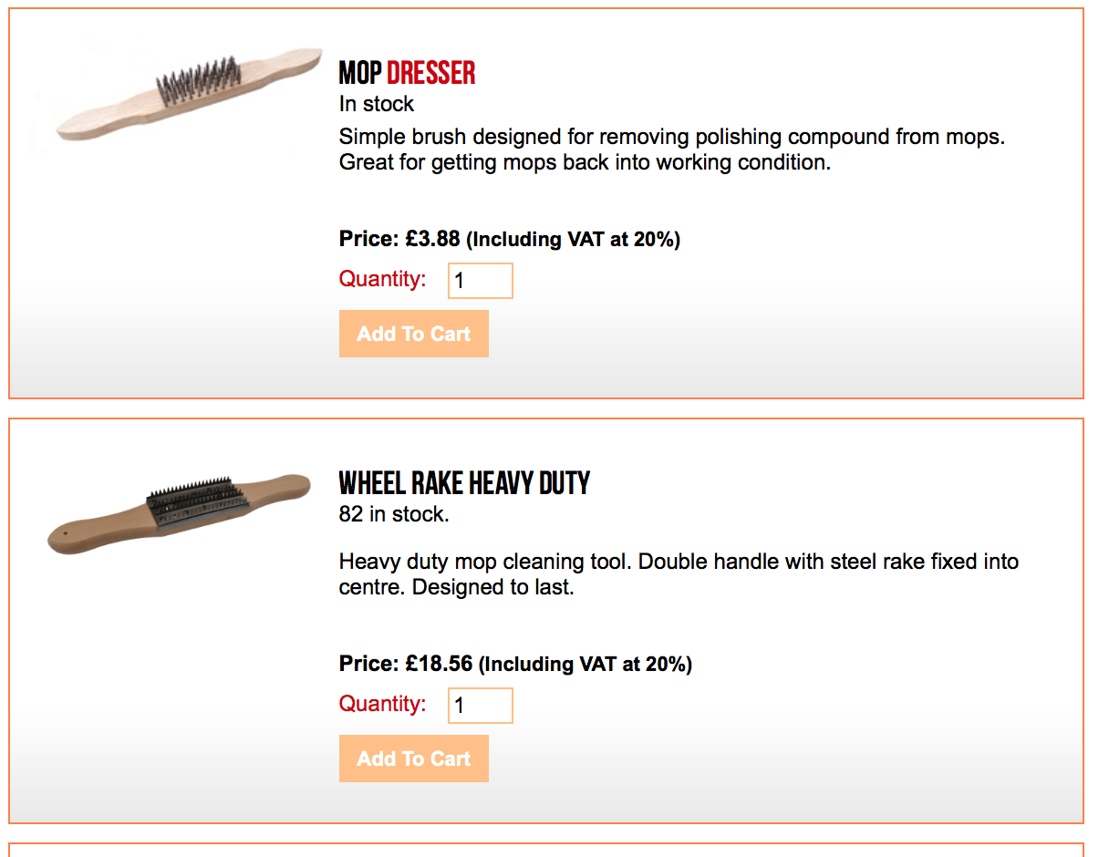

A buffing wheel dresser looks like this for those unfamiliar with them--when used right it does a similar job on buffing wheels that is done when you dress a grinding wheel.  They also tend to knock out old or stray grit and "lumps" of buffing compound that might be in your wheel.  It's a good idea to keep buffing wheels protected when not in use--remove and store in a big ziplock or at least put a towel over them because grit and dust larger than the buffing compound are always flying all over the shop.

I have always known that as a wheel "rake" rather than a wheel dresser.
I have always used an ordinary 5 or 6 row wire brush to "dress" buffing wheels. The dedicated dressers have two handles similar to the rake, but I have managed without....You could always try an ordinary wire brush while you are waiting for the bespoke tool to arrive.
