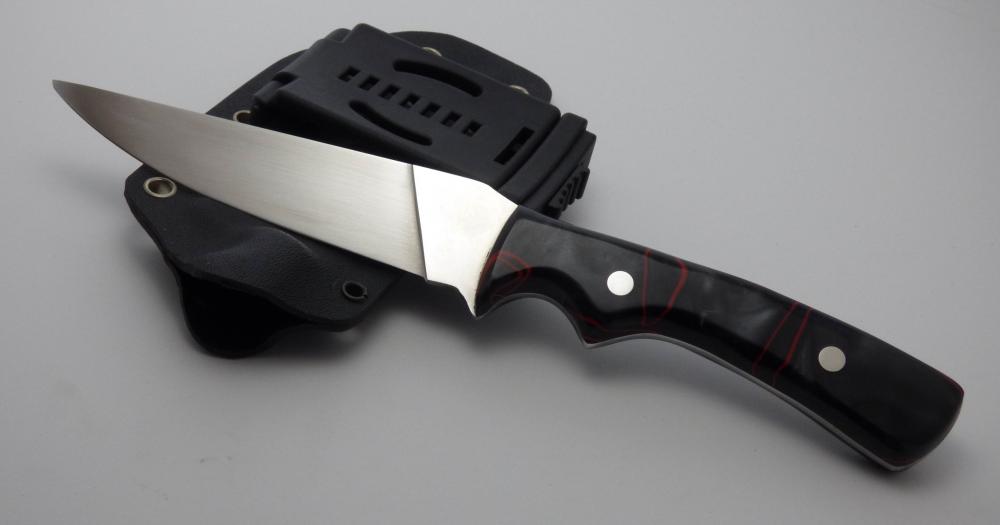

  19. well being the first one I will keep it for my self for testing but it is a design I have done in 440c up for sale as a general purpose EDC knife. here is a pic of one that was done in 440c
