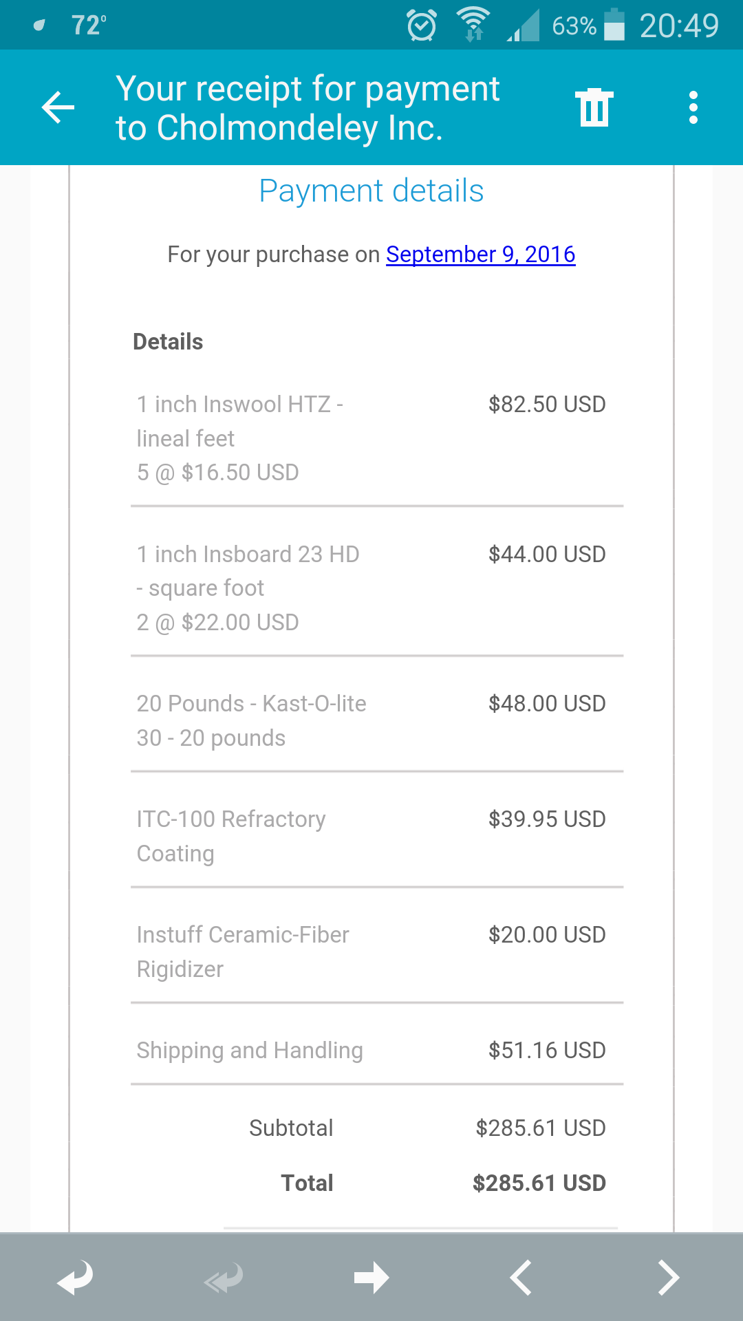

Almost forgot for the lid i was thinking insboard with a coat of refractory and itc100
Sorry for the screenshot but does that seem like what a non-rookie would get?
Could i be missing something?

WOW, those prices seem high and I live where shipping about doubles everything! We must be really lucky to have the distributor we have close. I lot may be the brands too.
It looks like a pretty complete list. I see: the insulating blanket, backer, the rigidizer, board for the floor. castable hard refractory Kast-O-Lite 30 LI and ITC-100 kiln wash.

Thanks frosty... but the board was for my lid and where do you buy from... for possible future uses

I buy refractory from EJ Bartell in Anchorage and the Alaska club enjoys a commercial discount. They're also a HVAC service company and it's not legal to use ceramic blanket refractories servicing boilers, furnaces, etc. unless it is cut from the roll. This means there are dumpsters of rems in the yard, when the dumpster is full it goes to the dump. I haven't paid for Kaowool in years. They are who I buy Kast-O-Lite 30 LI for the club price of $78/ 50lb. bag. Retain is $99/50lb bag. Retail ain't a bad price either.
There aren't any local sources for kiln  shelf, refractory board, etc. Bartell will order it for us but we might as well order online ourselves.
ITC-100 priced itself out of my market, last time I checked it was $136./1lb. pint can, WET. plus around $25 shipping. Instead, a few of us in the club got together and purchased a max load for an USPS flat rate box of "Zircopax," Zirconium silicate, flour from Seattle Pottery. The final cost delivered in the mail was $3.76/lb total,  The Seattle Pottery people really treated us well, they went out of their way to ship it USPS flat rate and that took a little extra handling on their part. I've done nothing but sing their praises since. They're just as agreeable on most issues. Great prices and helpful folk.
Zircopax is just zirconium silicate flour without a binder, unlike commercial kiln washes like: ITC-100, Plistex, Metricote, etc. I've been experimenting with mixing it with the Kast-O-Lite 30 high alumina water set castable refractory. Boy was that a mouthfull but that's what I'm experimenting with.
