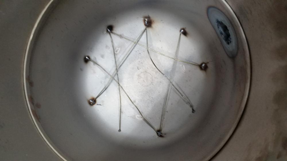

Mini UPDATE: created a rebar like structure for the PoP to hold onto20161001_102750.jpg
PoP soon to come

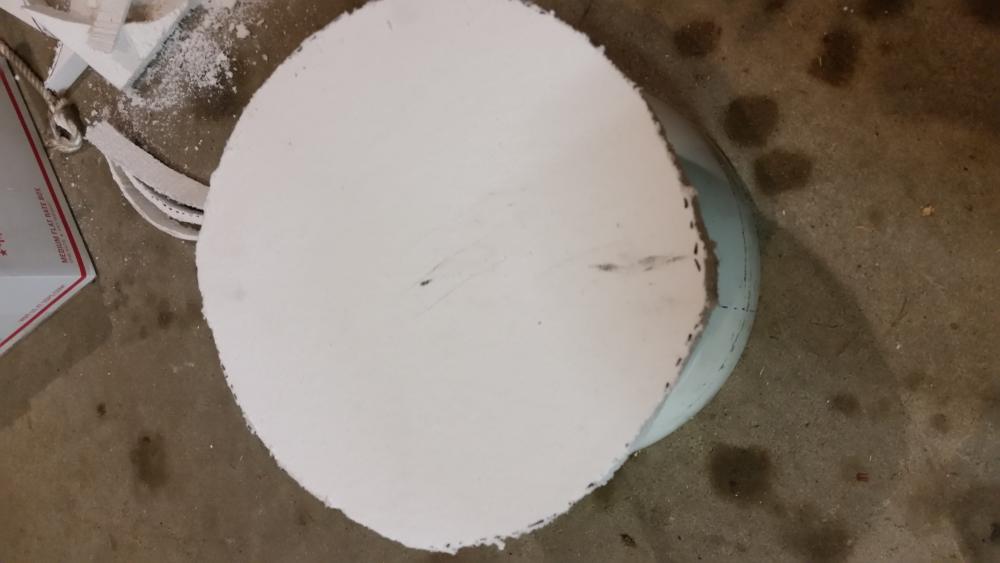

UPDATE: poured PoP, let dry for a few hours, cut the insboard... a few times(ended up working out, read on for details), put the insboard disc into the shell then put the pieces from the second cuts around the insboard disc(had to cut smaller because of the seam in the tank).
PoP
Insboard disc
Insboard disc in the forge
Insboard disc with "shims" in place
The chambers current depth 12 1/2" deep... exactly what i was going for. I LOVE IT WHEN A PLAN COMES TOGETHER! But thats all folks (for today)
