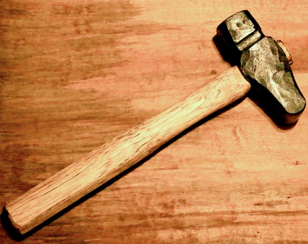

NickOHH Posted August 16, 2016 Share Posted August 16, 2016 Had a random day off of work so decided to not let the heat and humidify defeat me and lit the forge this morning. 2.75Lbs of 4140, cross peen, differential heat treat to straw. Its far from perfect, the eye is a little crooked but its not to bad so it should still swing just fine, cant wait to try it out now. Quote Link to comment Share on other sites More sharing options...
Frosty Posted August 16, 2016 Share Posted August 16, 2016 Looks pretty good Nick. In what way is the eye crooked? If it's only a bit you can trim the handle to correct for it before installing it. You have made your own tools before haven't you? If not get ready for a tool that feels better than any store bought tool you've ever used. Nothing beats using tools you've made with your own hands. Frosty The Lucky. Quote Link to comment Share on other sites More sharing options...
swedefiddle Posted August 16, 2016 Share Posted August 16, 2016 Good Morning, Nick If the eye is a little off-center, that is it's "Serial Number". Only the builder is that critical to see it. Tom Clark (Bless his soul), taught me to keep the Handle Hole in center, by drilling 3 - 1/4" pilot holes for the first punch. Dead simple and effective. No more off-center Handles that you correct by making the Handle to compensate. Is that WRONG???? Nahh, that is the way, i intended it to be!!!!!!!! Enjoy the Journey. Punch the weight and the date on the inside, closer to the handle. In 10 years, you will Thank Me!! When was that............? Neil Quote Link to comment Share on other sites More sharing options...
NickOHH Posted August 16, 2016 Author Share Posted August 16, 2016 the eye is a bit off center on the bottom, comes out in the center uptop. it was worse at the beginning, corrected it some forging , its still there, but i am just being critical of my work. i will have to try using the pilot holes on the next the one, which will be VERY soon. Quote Link to comment Share on other sites More sharing options...

51 Papy Posted August 17, 2016 Share Posted August 17, 2016 Swedefiddle I'm thinking that the 1/4" holes go dead center where the handle goes through the head from one face end to the other? Holes as close together as you can get them. I have not tried this yet but it's on the list. Papy Quote Link to comment Share on other sites More sharing options...
Frosty Posted August 17, 2016 Share Posted August 17, 2016 No, the pilot holes don't go face to pein. The center one is dead center where you want the center line of the handle, the other two define the ends of the eye. The punch will follow the path of least resistance, the pilot holes. I prefer Brian Brazeal type slitter punches they'll follow the center pilot or if you have practice you don't need a pilot. They tend to go straight as they work, a pilot is cheap insurance. Frosty The Lucky. Quote Link to comment Share on other sites More sharing options...
NickOHH Posted August 17, 2016 Author Share Posted August 17, 2016 I use a similar eye punch I made . It drives pretty straight, I got off to a bad start, twisted it before I had it buried and drove it deeper than I would have liked . I will take my time more on the next and make sure I'm straight before I start smashing it Quote Link to comment Share on other sites More sharing options...

swedefiddle Posted August 18, 2016 Share Posted August 18, 2016 Good Morning, Frosty is Correct. 3 holes, one on center, each other hole 3/8" from center = 3/4" apart. Through the part of the Hammer where the Handle is going to go. I guess if you want the handle from the Face to the Pien, that would be YOUR DECISION!!! I can't believe that needs clarification!! Lay-out from two sides, take your time with your square. Center is center. If you layout off center, guess what . . . Neil Quote Link to comment Share on other sites More sharing options...

Mark Ling Posted August 18, 2016 Share Posted August 18, 2016 what was the length and diameter of stock you used? Littleblacksmith Quote Link to comment Share on other sites More sharing options...
NickOHH Posted August 18, 2016 Author Share Posted August 18, 2016 3 hours ago, littleblacksmith said: what was the length and diameter of stock you used? Littleblacksmith It was just over 4 1/4 inches of 1 3/4 inch round 4140. Squared it up a bit with round edges before punching the eye. Quote Link to comment Share on other sites More sharing options...
