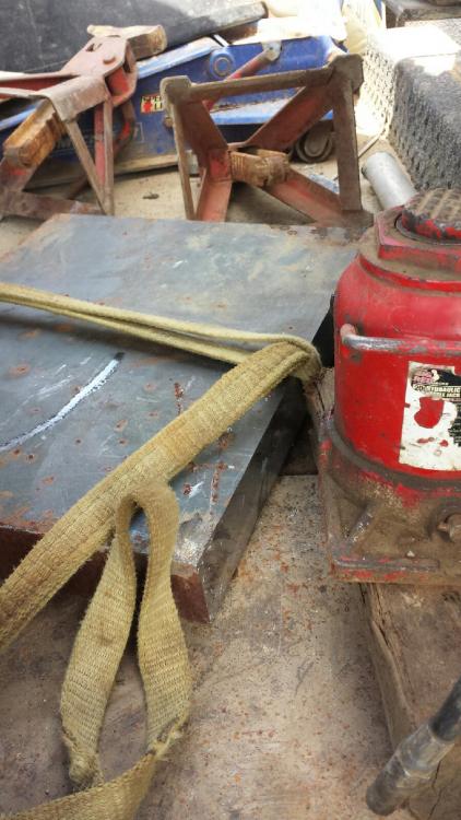

Here is what ive sourced so far
1 - 14" x 18" 2" thick plate (120lbs roughly) unknown low quality steel. possible laminated anvil setup for knife making and who know possibly a short sword or two.
1 - 7" diameter x 24" (180lbs roughly) hydraulic hammer bit for breaking rocks. most likely my starter anvil and possibly a cold steel hammering surface for misc Armour making once i build my plate anvil.
1 - 18" diameter 3/4" thick 26" (from dome to dome) wall pipe with 1 welded dome end cap and one loose dome end cap. once i build the burners (thinking more like hybridburners type of setup) i was thinking 2 burner setup with 3 inch total thickness insulation (1" kawool ) and a firebrick strip laid down for metal running across.

For your 2 inch thick plate, it will work best as an anvil if you place it on edge with the 18 inches vertical.  The more steel directly under your hammer blows, the better it will help you move metal.  2 inches is a little thin, but it only needs to be as wide as your hammer face to get full effect.  Sometimes for knife making a narrower anvil is better anyway.
The hydraulic hammer bit sounds like a sweet item for a post anvil.
Your pipe for a propane forge is overkill by an order of magnitude at least.  18 inches in diameter at 3/4 inch thick and 26 inches long is quite heavy to begin with.  Next you'll need to calculate your volume after lining it to figure out how many burners of which diameter you'll need to heat that monster.  It's pretty hard to work on more than 6 inches or so of metal at a time before it cools to the point where it needs to be put back into the fire.  Your proposed forge will use a LOT of propane to keep it hot and the reality is most of it will be completely wasted.

The hammer bit will make a heck of a post anvil.  Put at least a third to one half of it a base and put sand around it.  That will cut the ring down to a manageable level.  Mine has about 90% rebound and works well for what I do.

Here is my little post anvil before I decide how to mount it upright. Also my little slab I'm assuming it's pretty low grade steel since we cut that with a circular saw made for steel cutting 1 inch depth at a time and was pretty easy.IMG_20160727_152219_01.jpgIMG_20160727_152206_01.jpg

I did like the idea on the brazeal style anvils but my plate is way to soft to use in its current state and i wouldn't have anything to heat it up a 14" x 18" x 2" plate let alone to cool it well enough to get a decent harden anvil.

1: Your plate, if it's steel, is probably the same hardness, (barring work hardening),  as his plate is.  Hot steel is softer.
2: Unless it's an alloy with appreciable carbon content in it heating it up and quenching WON'T HARDEN IT!  Please ignore what Hollywood shows, what poorly researched fantasy books tell, if it's not a proper alloy it won't harden---in fact some alloys will soften if you heat them up and quench them in water as you will lose any work hardening and not gain any quench hardening. (very low carbon alloys for instance)

Case hardening is an extremely thin surface layer that is used to increase wear life it's not any good for impact.  "jacketing", do you mean forge welding a higher carbon steel to it?  Yes and it was commonly done historically; nowadays with the massive amounts of cheap high grade steels available it's generally not done as not being cost effective and taking high skills to do it.  Where it's still done is in historical replicas, bragging rights pieces and blades where the method and results play a part that may ignore costs...
Hard facing can help but is expensive and you have to get the RIGHT STUFF for hardfacing, many commonly used rods are for abrasion resistance and not for impact where for an anvil you worry more about impact and less about abrasion resistance.

Brian's anvils are not hardened steel, they're generally mild. He ONLY works HOT on it so it doesn't make a lot of difference. Case hardening is a complete waste of time and money. for what it'd cost to case harden that plate you could buy a darned nice modern anvil.
Hard facing isn't going to do a lot of good either even if you use a steel on stone facing rod. What you're trying to prevent is deformation under the hammer, you may not know it but that's the ONLY reason for hard anvil faces. Unfortunately hard facing rod is brittle and has almost no bridging strength. This means if the metal under it can give the hard face will start cracking under hammer blows.
To prevent cracking and spalling under impact is why I recommend guys wanting to hard face their anvils use a proper build up rod first to provide an unyielding surface for the hard facing. To get a handle on how this works imagine laying a sheet of glass on a clean table then press on the center as hard as you can with your finger. It won't break. However if you lay the same sheet of glass on a piece of foam rubber it hardly takes any pressure to break it. The glass is brittle and has little if any bridging strength but it has enormous compression strength. So as long as it's supported rigidly it can take all but inhuman pressures.
