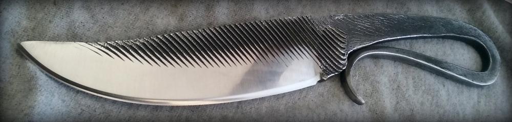

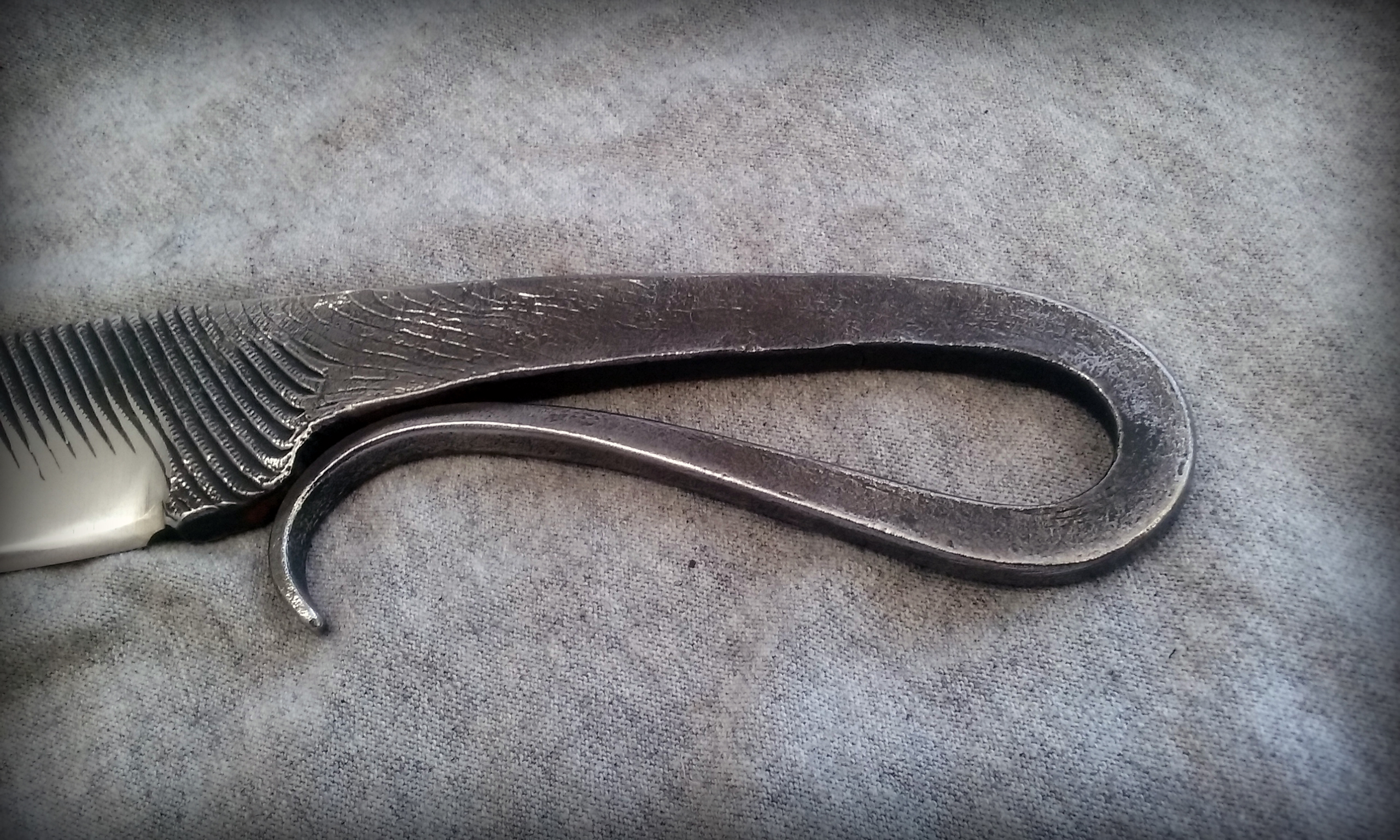

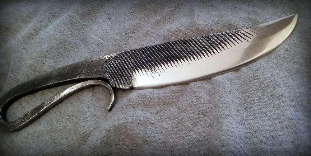

Might be kind of a step backwards from my other knives, but I never tried one before.  So, took the rest of the file from the last herb chopper I made for my show, and whipped this out.  It was kind of fun, and got it done fast enough to sell at a pretty reasonable price at the show.  Might have to whip out a few more.
That's one of the nicest file knives I've ever seen. It looks clean and smooth in all the right places to be comfortable for some use. I can't tell about the spine though, did you grind off the teeth there?
I once made a knife similar to this and the handle, I hardened the back side of it and so you could then use it also as a flint and steel, though you got to be sure to temper the transition of the blade to the handle and only harden the backside.
                                                                                                            Littleblacksmith
I actually really love this style of knife, both the handle and the rasp or file knives. I know they are usually unknown steel and dont hold up as well as damascus or similar blades but i really just dig the way they look . Congrats on another great knife project.
Pattern welded Damascus has NOTHING to do with how bladeworthy the steel may be; you can have a damascus billet with extremely low carbon content that can't be hardened but has a lovely pattern, say 1002 and pure nickel  for instance.  Wootz damascus, (you didn't say which you were referring to), has a bit more constraint on content to get the carbides to produce the pattern; but it can be too brittle as well.
A beautiful knife - I've got to give that a go. I like the way you have integrated the file grooves. Top job.
Just remember that every one of those teeth is a stress riser, and potential cracking point.
