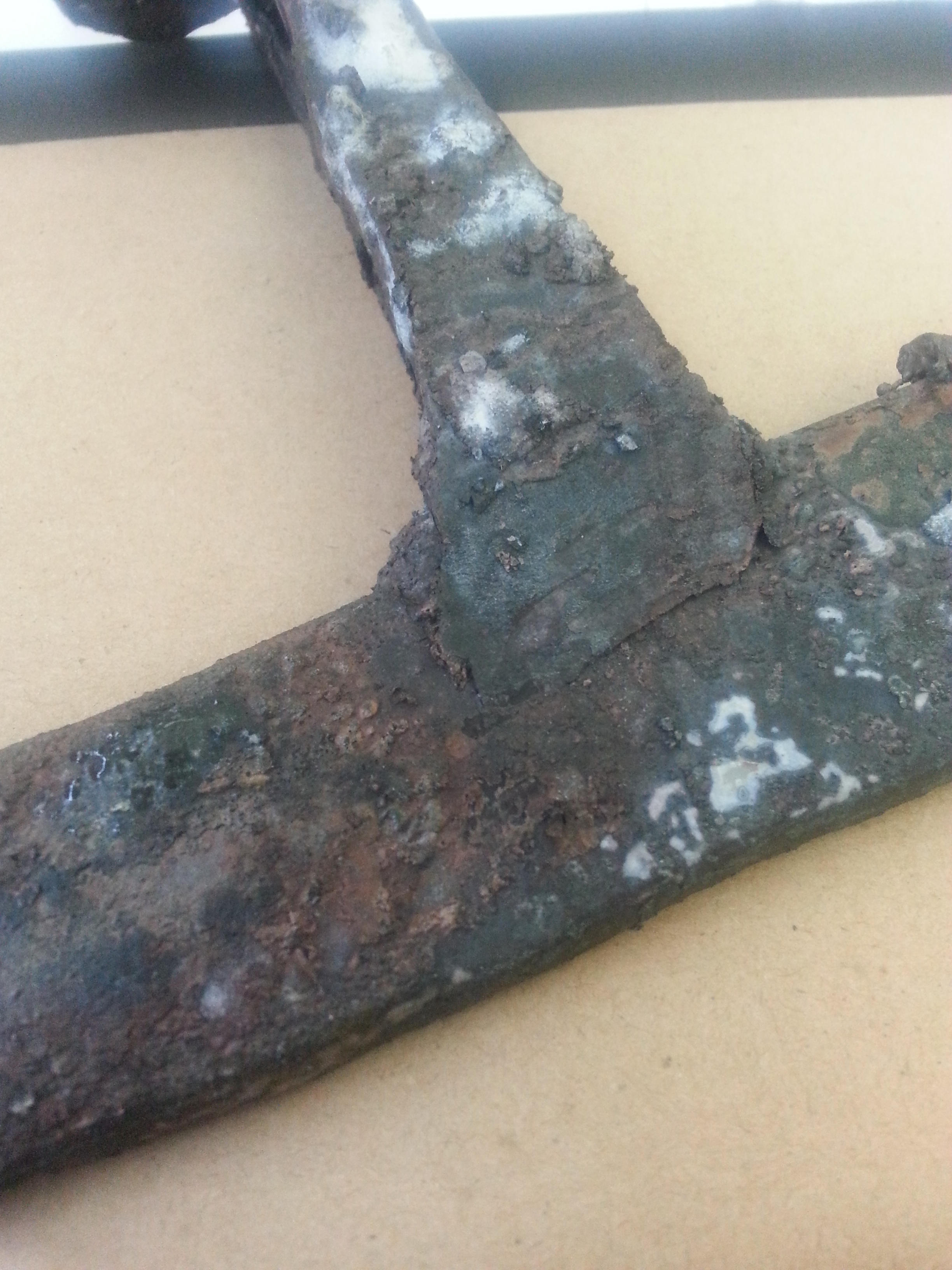

RR Spike Axe - Forge Weld Question
Dustin Quade replied to Dustin Quade's topic in Axes, Hatchets, Hawks, Choppers, etc
So your saying that if i am running a reducing forge the joint will have some scale because i took it out an exposed it to air but its an ammount that can still allow for a forge weld to take, but if im running an oxydzing forge i will have too much scale in that joint to make the forge weld possible now? -
Well this is the first time i have had an issue with a forge weld like this. I dont know what forge i have and i would hate to have a part of my knowlege base be pernicious I found an old post about these differences between these two forges. And it looks like there is a way to try and figure it out, Frosy posted this "It's been discussed repeatedly scale WILL form on hot steel in open air. PERIOD. A forge with a neutral or reducing atmosphere: gas, coal, charcoal, electric, etc. can NOT form scale there is NO oxygen to oxidize anything. To check, shine up a thin piece of steel and put it in your forge hot and running. If the surface appears clean till it's the same temperature as the forge it is NOT scaling up." But i do have a question. In that post Iis is said that no matter what forge you have scale forms on metal when the piece meets oxygen. So if thats the case then there is scale in that joint whether i have an oxydizing or reducing forge since its in the air now and has been since last night, so doesnt that mean that the joint on my project is scaled up making that forge weld much more difficult no matter what type of forge im running and the question about what forge type i have will only come into play in future projects right? -
Lol i always "Try to use superb technique" im just not that good at it sometimes. Is my forge running oxidizing what? The main thing is that there is at least a shot at getting the weld to work so that is what i will attempt to get done tonight. -
So this is my second attempt at one of these RR Spike axes. I paid attention to the comments from my first one and have gotten to this stage. I upset the spike which gave me a lump of mass to use at the end for joining my 52100 steel bit into the spike. The upsetting also gave me a bit more material around where I wanted the eye. I moved the eye to the back near the head of the spike. So punching and drifting the eye with this style of axe was much more difficult than my first attempt. Because of its location it was hard to get it over my hardy hole for the punching through. My hardy hole is fairly large so as I punched through the whole piece would buckle into the hole but that meant the head would be mainly bending into the piece and jamming on my punch making the removal of it a bit of a pain. But in the end I got a hole punched and to a size I was somewhat happy with. Next I split the end of the spike which had been upset. I then selected my piece of 52100 for the main axe portion. I hammered this into place and then tacked it in place at the top and bottom so it wouldn’t slid around while I got to forge welding. Now here is the part I need advice on. So I got the one side welded up really well (pic 1) nice big pop when the weld set and everything. But as I went in to set the other side (pic 2) my propane started to run out. I did what I could and I heard a small pop when I went to set the weld on this side but I can see that at least the edge is not welded. My question is can I still weld up this other side tonight when I get my propane refilled or is this piece kyboshed now? I'm still really new to forge welding so id appreciate all comers with advice. Also the piece is obviously nowhere near finished so expect more pictures to come

Its good to know that having those shuts in there is a common occurance. If i try another where i fold the head into itself like this i will try to flux it up and weld it shut. I know that for decorative applications they might not be a big deal but for something like this are cold shuts a real problem or is there enough mass that its just an ugly asthetic? -

Damascus and RR Spike Tomahawk
Thanks for the tips about the eye. I do need to work on upsetting. I will definately attempt to get some more material around the eye next time. Even as i was working on this i was worried about the eye splitting open as i made it because the material was so thin there (1/8" at the middle and 1/4" at the corners)
