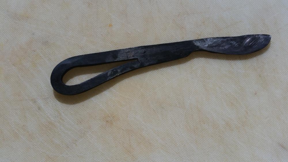

Soupyjones Posted July 19, 2016 Share Posted July 19, 2016 I am hoping that some of our wood carvers can give me some help. I am hoping to make a carving knife or two for a local wood worker to trade for some help and shop time. I have ideas and rough plans but I need some help with the fine details. First and possibly most important, how hard do you prefer the blade to be on a 1 1/8 straight ground blade? I understand that very hard blades are the norm bur some guys like a bit of flex in the blade. More than anything I am curious about preferences from folks who have used a few. Second is the balance of the blade. Is there any drawback to having the balance point closer to the center of the palm or is index finger the only real choice? Thanks for the help and advice guys. Quote Link to comment Share on other sites More sharing options...

Soupyjones Posted July 19, 2016 Author Share Posted July 19, 2016 9 minutes ago, ThomasPowers said: So are you making a striking knife used for marking wood (some nice japanese versions are out there); or are you making a carving knife like a crooked knife or a chip carving knife, or ... Hardness and flex are dependent on what they are intended for and the user's preference---tell me what kind of tires I should have on my pickup? Blast I got caught with a lack of information! Truth be told at this moment I am looking at making small whittling blades lIke chip carvers. Something akin to a scalpel which leads me to think a very stiff blade is ideal. Quote Link to comment Share on other sites More sharing options...

Soupyjones Posted July 20, 2016 Author Share Posted July 20, 2016 Thanks for the responses guys. I have done lots of hunting for popular knives and the style that most guys seem to like. I knocked one together to try out knowing that the handle was not right for a competent carver. I will try it out and see what needs improvement then go from there. It is still super rough until I grind it a bit and sharpen it. Quote Link to comment Share on other sites More sharing options...

Soupyjones Posted July 20, 2016 Author Share Posted July 20, 2016 That is great advice nate, thank you. The crux of the matter seems to be that each person prefers something different. Maybe I will clean that little blade up and give it to a hunter as a precision skinner and start from scratch on carving knives. Quote Link to comment Share on other sites More sharing options...

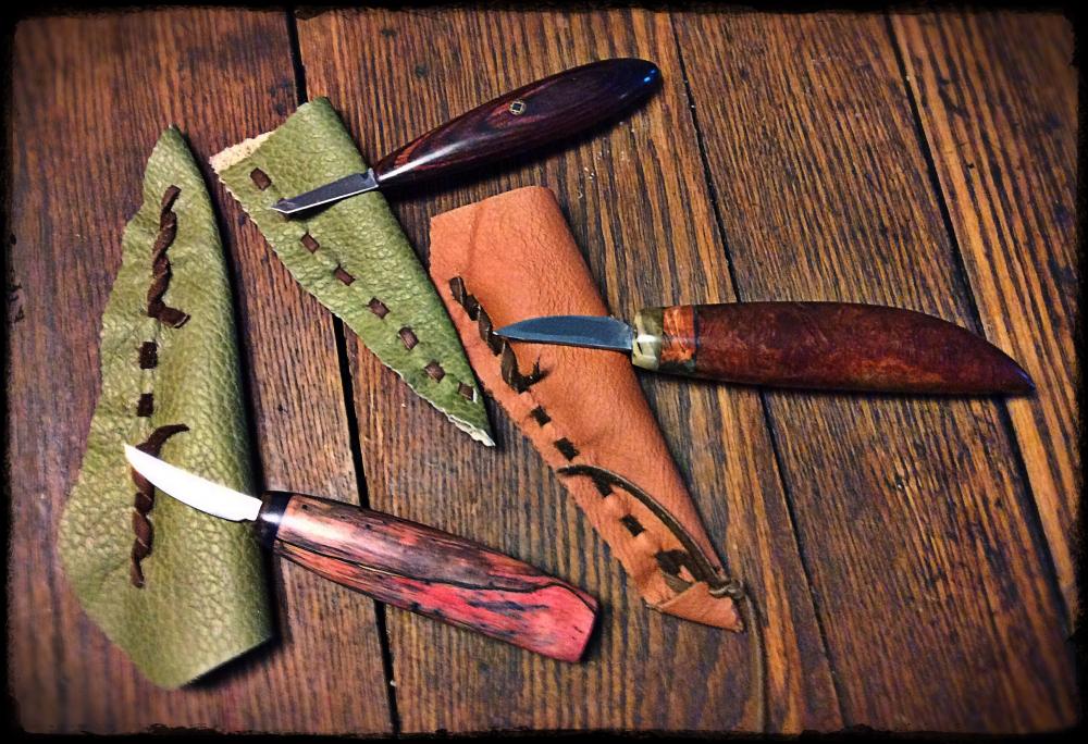

bigfootnampa Posted July 20, 2016 Share Posted July 20, 2016 Here are some from my collection. I didn't make any of these and don't have any that I have made with me now. These are good knives though! The two on the bottom are made by a smith who goes by the name "neza" on eBay. He usually has other knives listed and some are really beautiful! You can look at them for inspiration. The two larger knives here are roughing knives with about 1 1/2" to 2" blades. The top knife is by a well known maker and is more of a detail knife. I make the little scabbards myself. I prefer very little flex in my carving knives but I carve pretty hard woods most of the time. You can use a softer and more flexible blade with softer woods and do just fine. For me, cherry or walnut is about as soft as I usually work, with but many carvers carve pine and basswood almost exclusively. Quote Link to comment Share on other sites More sharing options...
