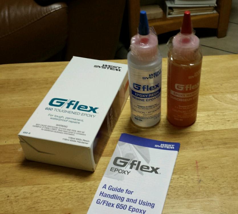

TacticallySharp Posted July 7, 2016 Share Posted July 7, 2016 1 hour ago, ThomasPowers said: I use GFlex marine epoxy as my adhesive, and small Corby Bolts for mechanical attachment. On kitchen knives I prefer stabilised wood or man made materials for my handles. I use the same on most of my other knives too. Quote Link to comment Share on other sites More sharing options...
TheoRockNazz Posted July 7, 2016 Share Posted July 7, 2016 That stuff is fantastic, I started using it a year ago and now swear by it. Yeah, something like a kitchen knife that's going to get washed frequently would benefit from a handle material that will not be effected by water. Quote Link to comment Share on other sites More sharing options...
