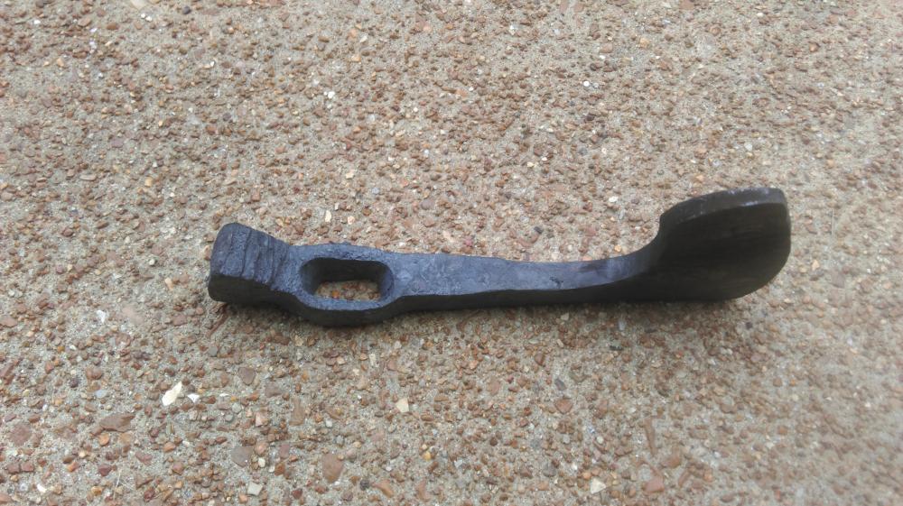

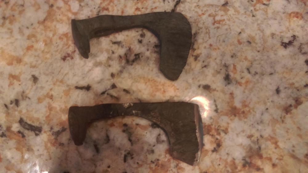

Anthony Karakas Posted May 13, 2016 Share Posted May 13, 2016 Hello, These are some of my first tomahawk attempts. I keep having a recurring problem, which is the eyes keep cracking. I have been drifting the eyes early in the process, but now i am realizing, is it better to drift the eyes later in the forging process, thereby reducing eye damage during forging? Also, i am welcome to any and all advice that might help me along my way to producing a serviceable hawk. Thank you. Quote Link to comment Share on other sites More sharing options...

NickOHH Posted May 13, 2016 Share Posted May 13, 2016 Looks like the edges are to sharp on your drift round the edges a good bit but you can still keep it rectangular overall. Post a picture of the punch you used also if it is different. You make have wanted to let the checks of the eye pert rude instead of keeping them even with the rest of the spike. Quote Link to comment Share on other sites More sharing options...

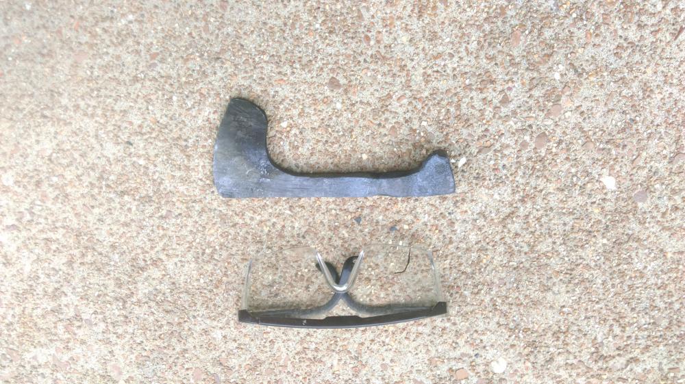

Anthony Karakas Posted May 13, 2016 Author Share Posted May 13, 2016 Here is a picture of the two tools that i used...Also, perhaps i did not make myself clear: the cracks did not happen while i was drifting the eyes. I noticed them later on after i had been forging the rest of the tomahawk. For that reason, i am wondering if it is better to do as much forging as possible of the Hawk, and then drift the eye as late as possible in the forging process? Quote Link to comment Share on other sites More sharing options...

Anthony Karakas Posted May 13, 2016 Author Share Posted May 13, 2016 Actually Navasky, i was doing just that on my latest attempt. I ran out of rr spikes, so i used a piece of 3/4 tool steel. After upsetting the piece to 4" (from 6.5") i punched and drifted the eye. Later as i was working on the body of the hawk, i started quenching the lower part of the hawk where the eye was located, under the belief that if i kept it cooler, it would not split or crack. Unfortunately it did just that! Quote Link to comment Share on other sites More sharing options...
Latticino Posted May 13, 2016 Share Posted May 13, 2016 1 hour ago, Anthony Karakas said: Actually Navasky, i was doing just that on my latest attempt. I ran out of rr spikes, so i used a piece of 3/4 tool steel. After upsetting the piece to 4" (from 6.5") i punched and drifted the eye. Later as i was working on the body of the hawk, i started quenching the lower part of the hawk where the eye was located, under the belief that if i kept it cooler, it would not split or crack. Unfortunately it did just that! Unfortunately that is almost completely backwards of what you should be doing. Many smiths who work exclusively with tool steel (bladesmiths) don't even have a slack bucket in their shops to avoid this temptation. Water quenching tool steel, particularly with strong variations in crossection is a recipe for cracks and surface microfractures. There are some tool steels and situations where water quenching is a prudent option, but with the steel you probably have and the work you are doing it is highly unlikely. As others have already stated, slitting and drifting should be done quite hot (I don't bother drifting unless the stock is in the orange/yellow range, too much work otherwise. If it gets below cherry red you are asking for trouble, and remember the side in contact with the anvil will cool faster). Also you can try to forge down the sides of your blank around the drift on the anvil a bit rather than just forcing the drift through. This will raise cheeks on the side of the hawk around the opening, but these can either be a design element, or forged out as well. Rounding corners of your drift will also help. I like the traditional teardrop crossection for hawks, but many different styles have been made historically. Quote Link to comment Share on other sites More sharing options...

Anthony Karakas Posted May 27, 2016 Author Share Posted May 27, 2016 After rounding over the edges of my punch and drift, and making sure that i only worked the steel in the orange and above range, i am happy to report that this eye did not crack! Unfortunately i was not perfectly center (although it certainly seemed so when i started punching). Quote Link to comment Share on other sites More sharing options...
