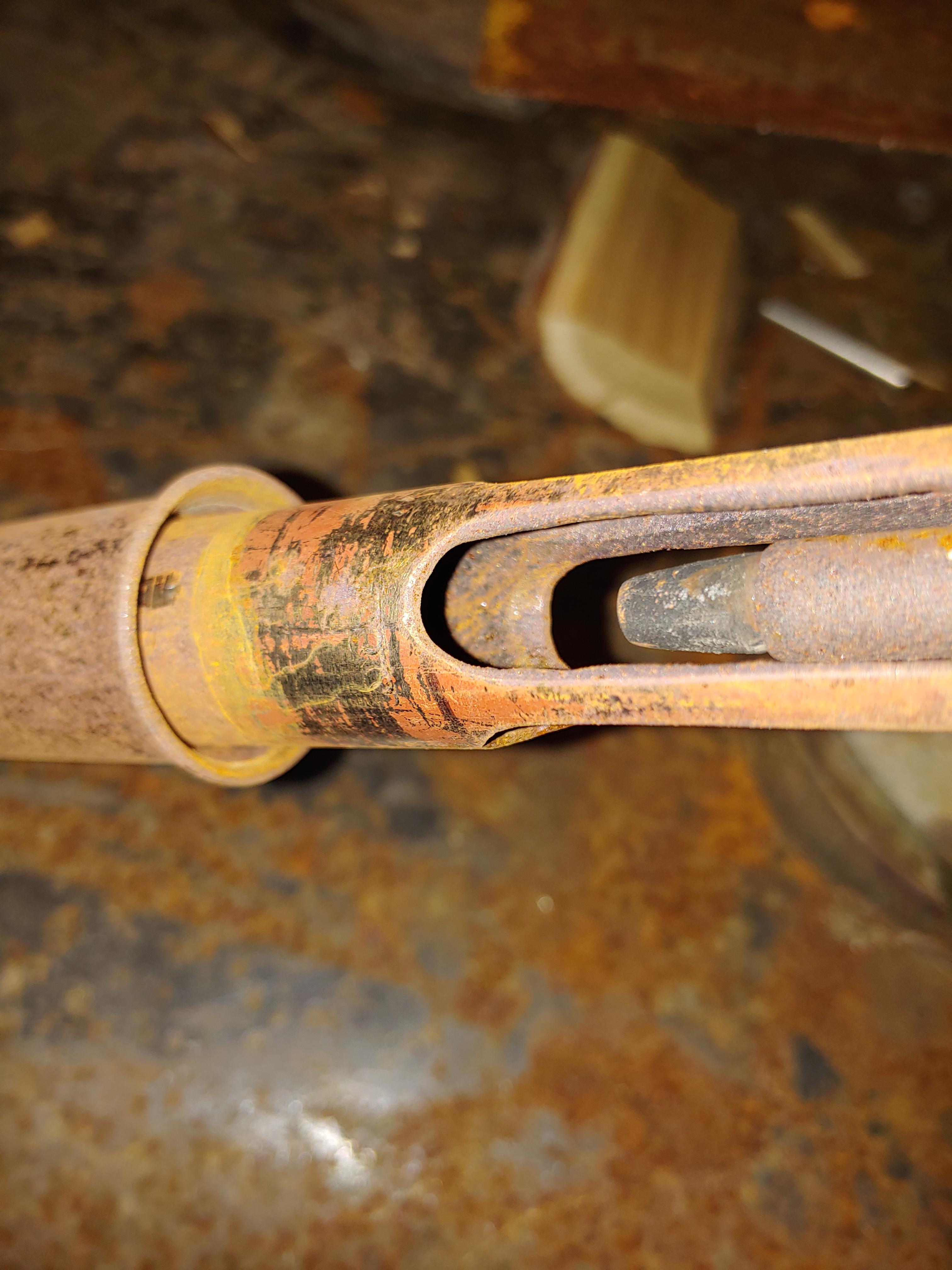

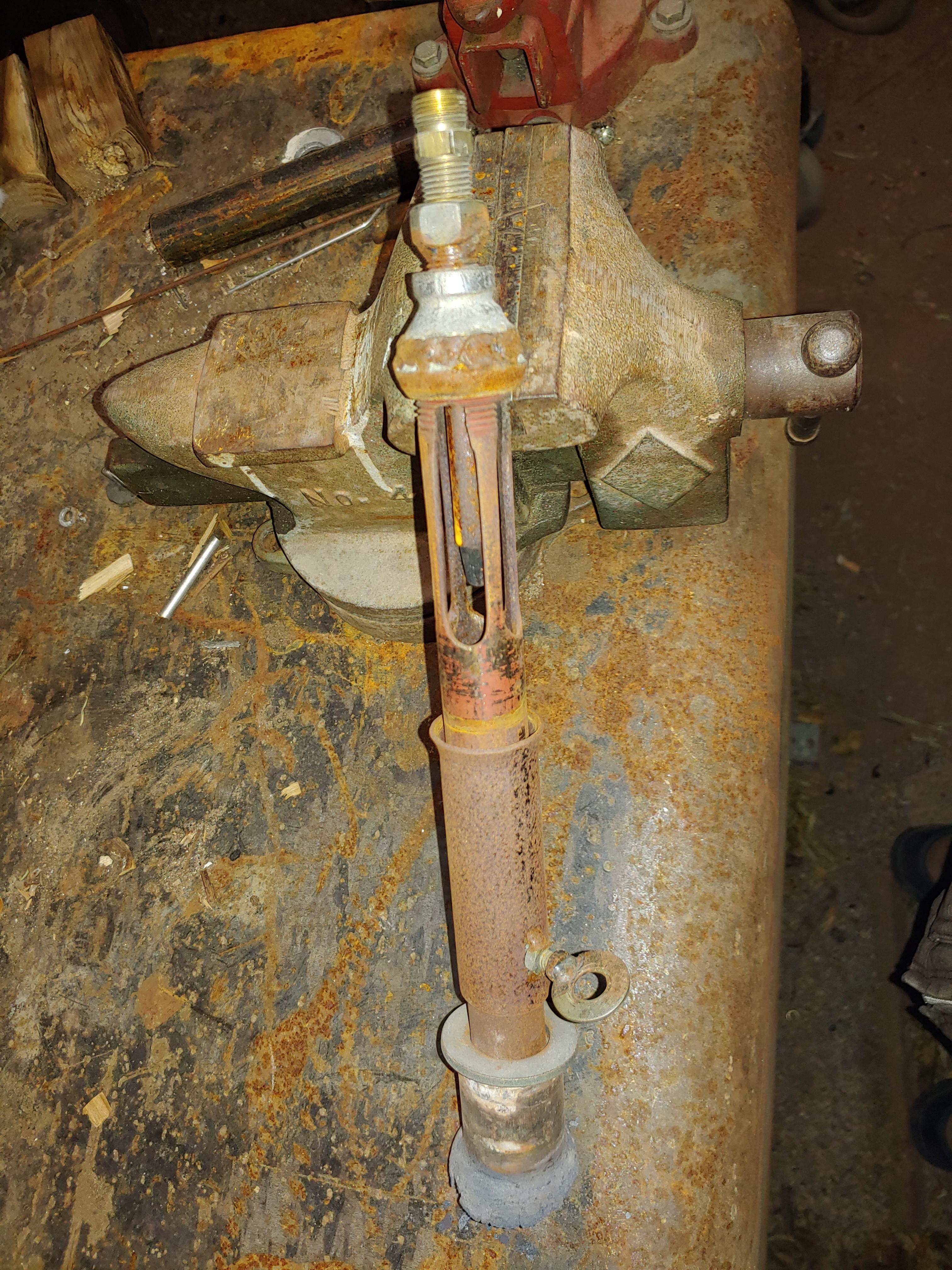

Jimw3326 Posted December 11, 2022 Share Posted December 11, 2022 (edited) So, Mikey98118 what is the optimal position of the orifice relative to the inlet? My results may be different after I rebuild the burner but as the pic shows it is above the edge wide open. To get it to run the choke was about 1/2-3/4" above the orifice. Edited December 11, 2022 by Mod30 Remove @name tag Quote Link to comment Share on other sites More sharing options...
Mikey98118 Posted December 11, 2022 Author Share Posted December 11, 2022 36 minutes ago, Jimw3326 said: what is the optimal position of the orifice relative to the inlet? I am assuming that you are actually referring to what we call the sweet spot." There are bound to be differences in terms. The sweet spot is what we call the optimal distance between the MIG tip's forward end, and the air openings forward ends, or in other words the point where the area of the burner's air openings stop, and the area of the burner we call its mixing tube begins. On a 3/4" size burner that will be somewhere between 3/8" and 1/4." First, you want to finish squaring the forward ends of your air openings. Next, you want to grind a sixty degree internal bevel on all those squared ends. Third, you want to set the end of the MIG tip 3/8" away from the outside edge of the air opening ends. Fourth, tune your burner to the best flame you can by varying the length of the flame retention nozzle's overhang past the end of the mixing tube; that will start at a distance equal to its inside diameter, plus 1/8" (on a properly built slide-over step nozzle). You will find the flame varies between slightly reducing at that distance, and oxidizing as you move closer by subtracting the whole 1/8". You make a proper slide-over step nozzle by cutting a tube or pipe the next size larger than your burner's tube body, and 1" long; we call this a centering ring. Then, you cut an outer tube or pipe the next size up from that to form the flame retention nozzle; its length is to match its inside diameter, plus 1-1/8". You will find this nozzle will produce a much hotter flame than the ones you have now. You can use mild steel tube or pipe for the centering ring, BUT you need to use stainless steel socket set screws on you flame retention nozzle. You also want to use stainless steel for the outer tube; #316 is best, but #304 will serve. Usually, I need to due some minor power sanding on the outside of the centering ring to get to push into the outer tube, and some minor power sanding on its inside to get a good sliding fit between it and the mixing tube, but I have been know to slit the centering to make less than optimal part sizes serve. Also, you must remember that pipe, and to a lessor extent, tubing isn't round, so you need to check the ring and outer tube to see where they mate best; this reduces your work and improves the finish product. If all goes well, a single screw will do the trick; otherwise, you will at least need three equally spaced screws in a line 1/4" away from the nozzle's rear edge. Why there? Because that leave an area 3/4" away from the edge available for a second line of screws, if needed. Do I think you'll need to go that far? Heck no; but other are reading these instructions too You are now finally ready to move your MIG tip back and forth between the 3/8" and 1/4" distances, to fine tune your burner's flame. Also, get rid of that short MIG tip; replace it with an 0.025" tip that is 1-1/2" long. Quote Link to comment Share on other sites More sharing options...
