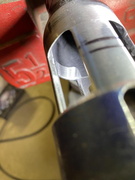

Greg in Maryland Posted February 19, 2023 Share Posted February 19, 2023 Mike, Appreciate your help. I have no problem making the changes. I asked for help so I am willing to go all in. I will square the air slots and bevel 60 degrees. How much bevel do recommend on the choke sleeve? Quote Link to comment Share on other sites More sharing options...
Mikey98118 Posted February 19, 2023 Author Share Posted February 19, 2023 Sixty degrees; but that's just because I'm a picky. Forty-five degrees should do okay. I'm willing to go all in too. The promise stands as stated. I can't leave you down to the deep end, without a life preserver, or the others won't want play anymore Quote Link to comment Share on other sites More sharing options...
Greg in Maryland Posted February 19, 2023 Share Posted February 19, 2023 I appreciate the offer. I like to tinker and learn. Will report back shortly. Quote Link to comment Share on other sites More sharing options...
Greg in Maryland Posted February 19, 2023 Share Posted February 19, 2023 Mike, I beveled the air slots and the choke. The knife edge formed by the bevel is about .03 thick. It seems to be more responsive to the choke setting now (ie. there is a wider range of green, light blue and darker blue flames). Pressure is 15psi. Question: The 1/8” nipple used for the gas accelerator is schedule 40 and 3” long. I ordered a 4” long schedule 80 assuming it will need to be shortened. How long do you suggest it be? Also: The distance between the front of the air openings and the forward cut off end is 9.125. Your book suggests 6.75. Not sure if it was engineered with a longer mixing tube because of the “funnel” design at the gas accelerator assembly? Regards. Quote Link to comment Share on other sites More sharing options...

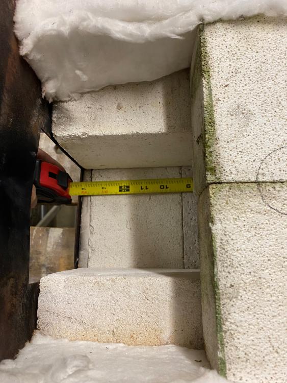

Greg in Maryland Posted February 22, 2023 Share Posted February 22, 2023 Quote On 2/20/2023 at 6:24 PM, Mikey98118 said: That sounds promising. Unfortunately for us, your burner problems are likely to end shortly; the hunt is on for a way to keep you around Perhaps an improved forge to shove it into? Mike, You must have ESP! I assure you that I was contemplating scripting a message requesting your input on an “improved” forge. I already started lurking on the Gas Forges thread ( I am up to page 12 of 80). As I shared earlier “ignorance was bliss” when I started playing with fire. I built the forge as a box design with the burner top dead center and centered front to back. I tinker with knife making so that is the primary purpose of the forge. I used 2600 degree ifb for the 2 1/2” hot face and have 2-3 inches of superwool ht for the cold face. There is a 3200 degree ifb incorporated into the floor for flame impingement. The thermal couple is in the back of the forge. It will heat up to 2000 degrees f on 10psi and when up to temp hold at 5psi. I have never timed how long it takes to get to 2000 degrees but I guess it to be around 20-30 minutes? I am looking forward to your input. Regards.y Quote Link to comment Share on other sites More sharing options...

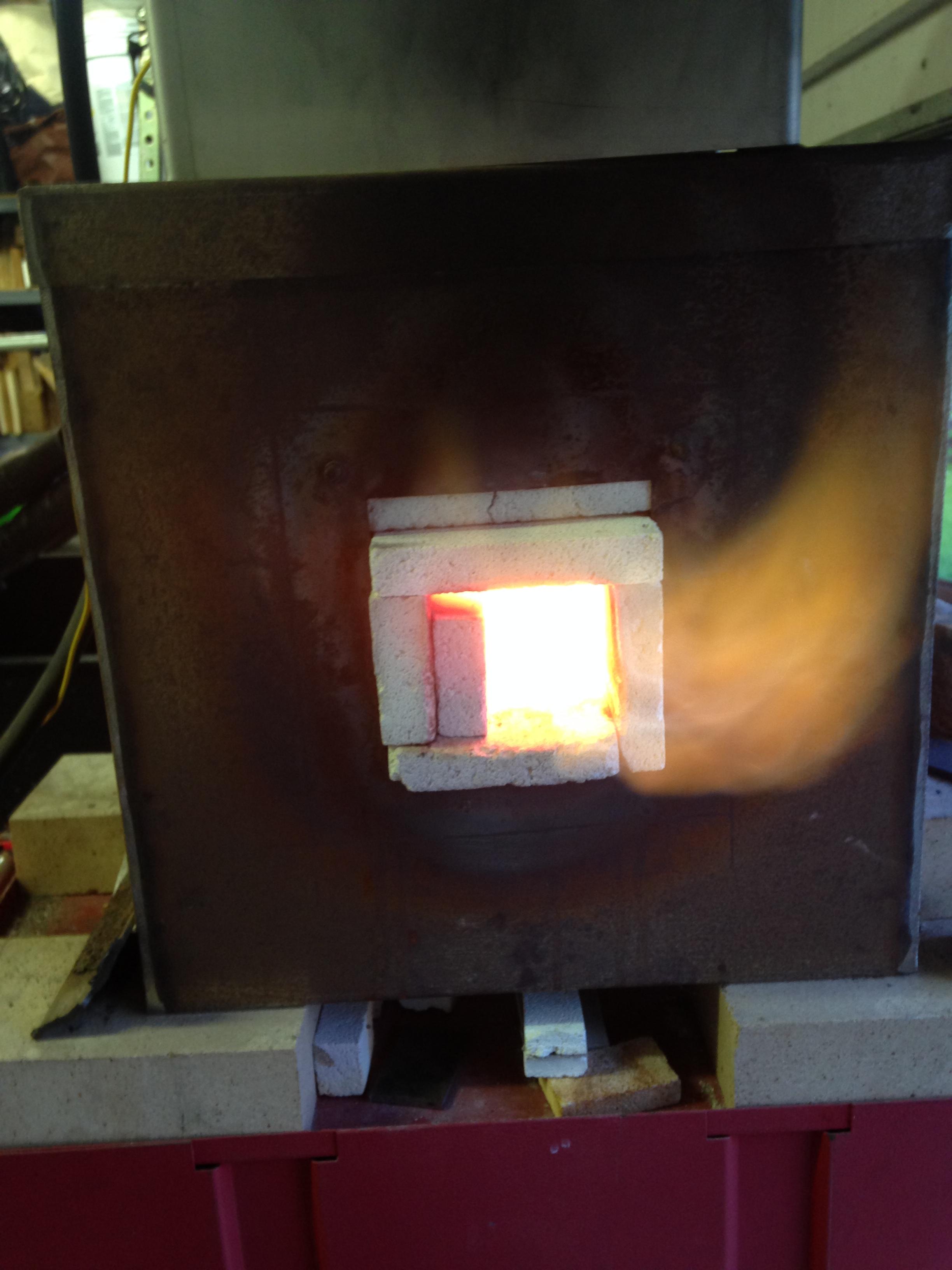

Mikey98118 Posted February 22, 2023 Author Share Posted February 22, 2023 I suggest we start with some back and forth about your present forge. I see some apparent contradictions. The digital readout is only 2056 (F?), yet the opening shows a nearly white hot interior (that should indicate about 500 F higher internal temperature). Is the photo showing the same incandescence as your vision? Is the thermostat maxed out? Next, the opening looks very small for a 1" burner's exhaust. We need to go into this more deeply. And, of course, there is the whole question of whether or not you're satisfied with your forge overall, or if you're looking to build something fancier Note that I'm just asking; not suggesting. Burners are all about performance, but the same guy who wants more from his burner, may take any remarks about the forge is rests in quite personally; as though I were kicking his dog Quote Link to comment Share on other sites More sharing options...
Greg in Maryland Posted February 22, 2023 Share Posted February 22, 2023 Mike, I took those pictures a long time ago (2016) but they were taken at the same time. The time stamp on the pictures shows they were within 1 minute of each other. The T-Rex burner is a 3/4" and not a 1". The thermal couple is in the extreme rear of the forge and only protruding 1" into the chamber from top dead center. The display is in Fahrenheit and it was not maxed out. I did verify its calibration at the time using an ice bath. It may be the exposure of the photo or the placement of the thermal couple causing the contradiction. The overall dimensions of the chamber are 4.5" x 5" x 14". I would like to accomplish 2 things: 1) Get the present forge running as efficiently as possible so I can start playing again. 2) Build another forge that takes advantage of everything previously learned to create a high-performance unit. I assume this will include building some Mikey burners which is something that excites me. Last but not least - No worries on hurting my feelings. You can call my baby ugly and I would probably agree. Quote Link to comment Share on other sites More sharing options...
Mikey98118 Posted February 23, 2023 Author Share Posted February 23, 2023 So, the answer to apparent contradictions will likely end up as "all the above." .O30" This is the usual deal. It is seldom that we get to point the finger at one outstanding issue and say "ah ha!" You said that the burner is 3/4" size. Normally that would present a problem, since the proper MIG tip for that size burner is the tip for .O23" welding wire--not .O30" welding wire. However, with the improvements you made, .O30" tips may work well enough. If not, your next tip change should be to .O25" tips (not .O23"), because of the improved flow you well have in the burner. The last photo, shows an oversize exhaust opening. This is excellent, if you include a brick baffle wall placed between 1" and 2" away from the opening. This arrangement seams too crude to most people. However, it is temporary; endless improvements on it can be made...later. Why later? To give the operator time enough to wrap his head around the whys of baffle walls, before trying anything fancy Quote Link to comment Share on other sites More sharing options...
Greg in Maryland Posted February 23, 2023 Share Posted February 23, 2023 I will get some .025 tips just in case and will also fabricate a method to hold a brick baffle 1-2" away from the opening. Do you recommend installing the burner top dead center or should it be angled? I have to fabricate a new burner collar and install new top bricks so now would be the time to know if the burner orientation should change. Thanks in advance. Quote Link to comment Share on other sites More sharing options...
