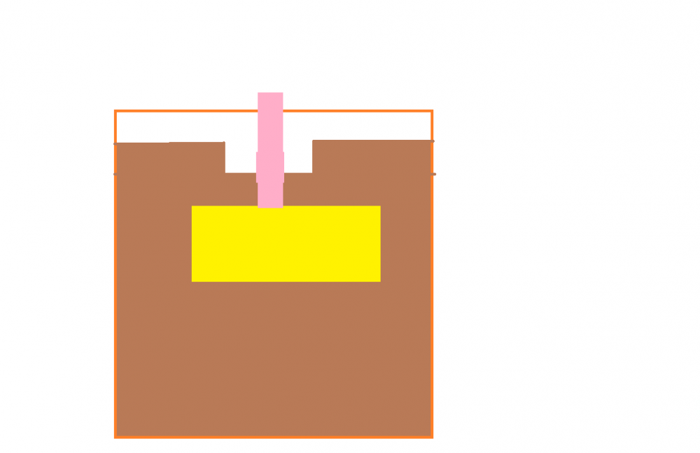

I suggest take a class before you do yourself and family a serious mischief. Seriously your "diagram" shows very nicely you don't know enough to be playing with molten metal. This isn't the kind of thing to figure out yourself unless you like the idea of being a Darwin Award winner.

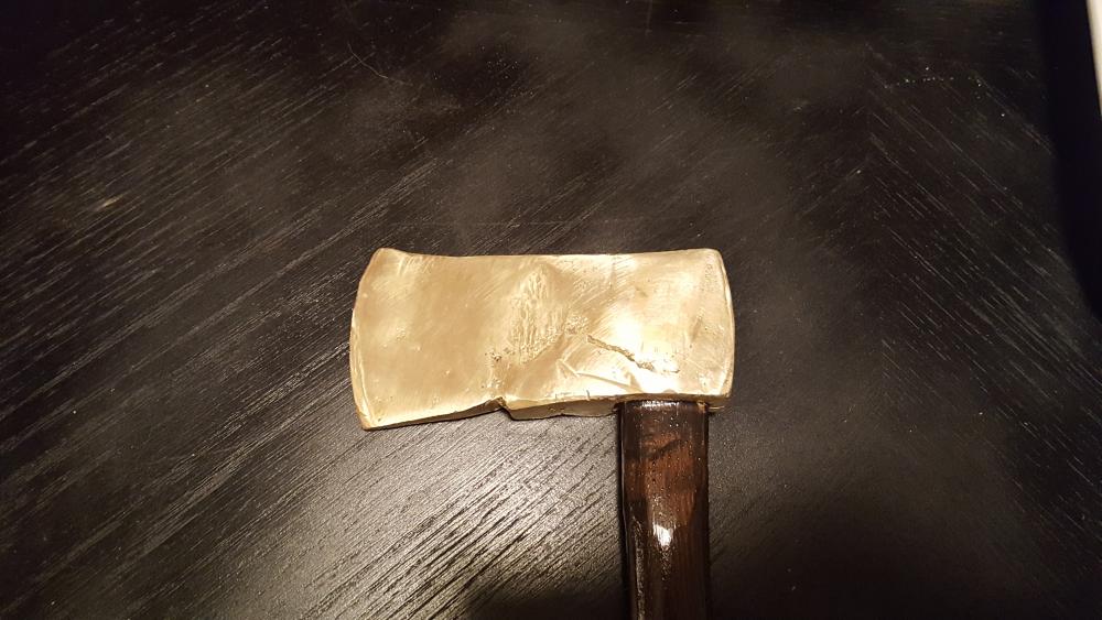

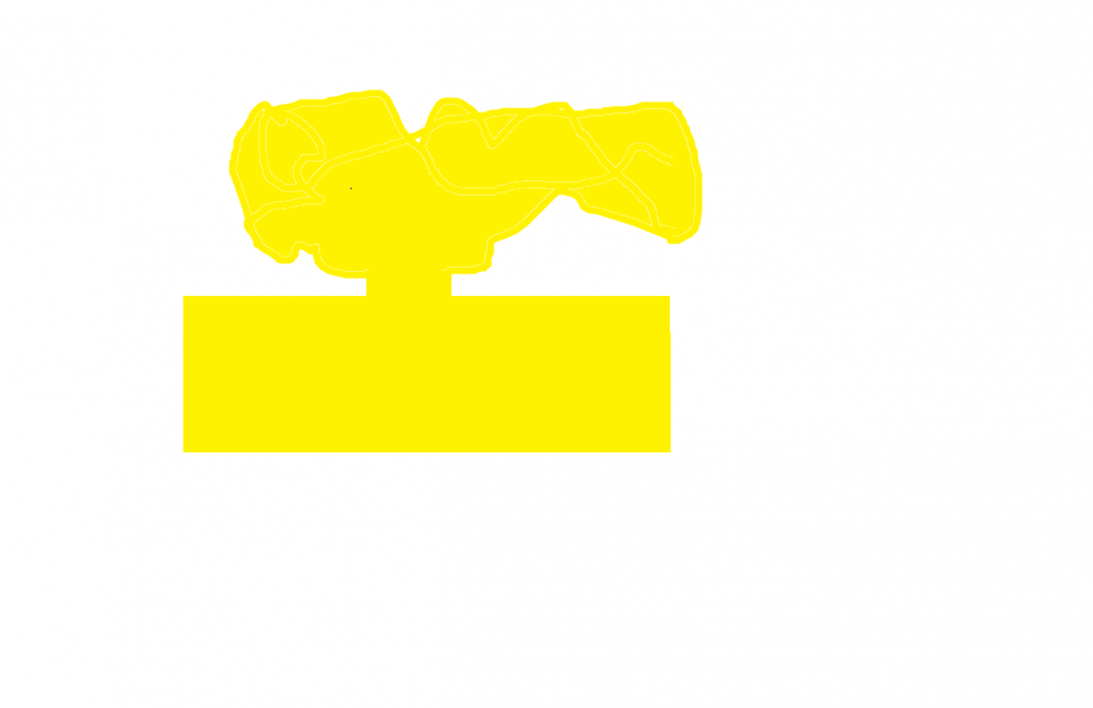

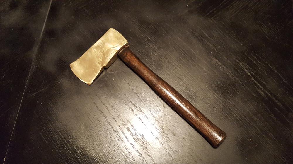

What exactly about my setup is so dangerous?  I have poured a dozen or so castings without any unexpected results. I am curious to hear your thoughts. I obviously am not looking to get hurt, and understand there is inherent risk in this and try my best to be as safe as possible.  I am going to start including vents in future castings if that was what you were referring to being wrong with my diagram, and I am going to use a metal bucket for any lost foam castings as I don't like the idea of aluminum melting through the sides if something overflows or breaks through the sand containment. I have also planned on starting to use the green sand mold process instead of the lost foam casting for most of my projects.
For one. You're attempting lost foam on shapes that should be green sand cast and in a couple cases open mold cast. How are you removing the foam?
For another. Your diagram shows a serious lack of understanding of how metal flows. A simple axe head hardly needs vents but sprueing it directly into the center with that kind of drop is a near guarantee of poor castings. Bronze is heavy and dense so it's going to erode the mold material where it pours onto it from a drop like that. It obviously wasn't an investment mold.
A metal shop 1 teacher wouldn't pass your form let alone let you ram it up.
I am not going to try to instruct you in casting metals with a higher melting temperature than say zinc. It's too dangerous without PPE and someone standing by the phone. You really REALLY need to take a casting class.

I agree. I over reacted with the temper of a younger man than that of which I am.  I clearly took it too personally. I have been doing more research and am going to be changing how I cast. No more single vent lost foam castings. I am going to get some real green sand and make a casting flask and utilizing a proper sprue/riser venting set up.
I also want to reiterate that I am extremely careful when I pour, I am fearful of the crucible and treat it with the utmost respect.  I plan out my footwork and clear the area of any unnecessary debris tools etc. I have a real commercially purchased graphite crucible and as soon as I see any signs of wear I spend the cash and order a new one...just wanted to provide some context on the respect I do give this hobby. I am not just doing this half cocked.
