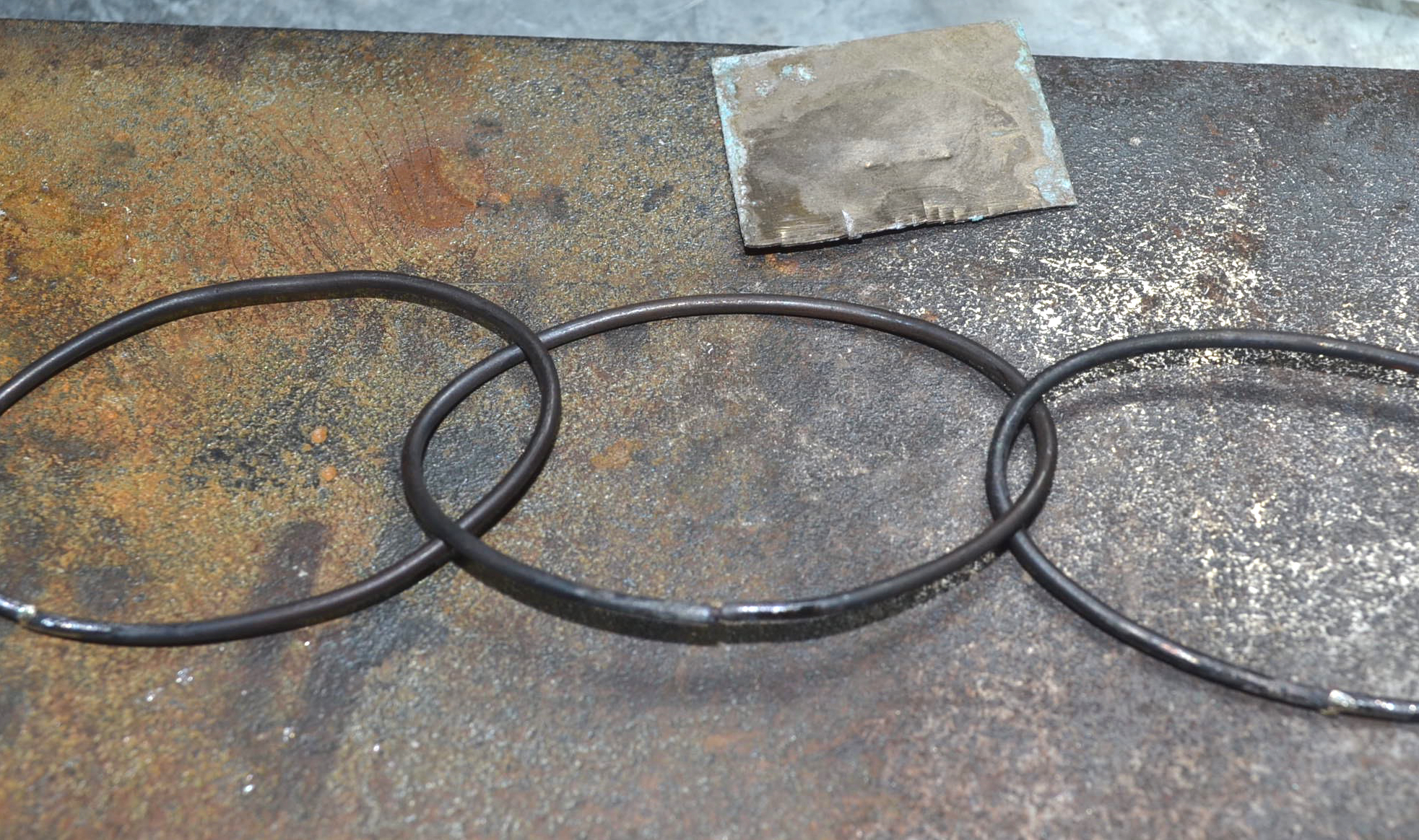

Hello,
I'm using a Benzomatic butane torch and making jewelry with rebar tie wire which is carbon steel wire according to the website. I've made several oval loops and want to join the two ends together. The ends have been filled down so they meet end to end and I've used steel wool to make sure the ends are clean. I've tried using Batterns flux for silver, gold & Platinum and Oatey flux No. 5. Then for solder I've tried Bernomatic solid wire solder !00% lead free and just the regular silver solder that I have in soft, medium and hard (used the soft and medium).  I've tried placing the solder on top of the joint and also in between. I heat and heat and it does look like it goes sort of liquid but then with more heat it balls up instead of flowing into the joint.
Do I need a different flux or solder? Is my torch not hot enough?  I have no idea if this wire has been annealed either as I own another type I haven't tried yet that is annealed.
Also does this wire need to go into a pickling solution after the water? I've been doing that but wondering if it was necessary with this type of wire.

Shown is the tie wire, the loops and the last photo of the medium solder. I'm using a charcoal block to solder.  The other solder that I have that is lead free comes in a coil that I snip off.  I can also get Stay Clean flux locally but only a 16 oz size which is more then I want. I'm told by the store that it should work for what i want to do but don't want to spend more money on another type if it doesn't work. Also wondering if I should try the paste flux/solder version like this:  http://etsy.me/1qpsAfr
With the low Canadian dollar I'm trying to avoid buying from the USA where possible and may see if I find something like this in Canada.

You are aware that you should be aiming to heat the ring with the torch and that the workpiece in turn should melt the solder?...the beading up and no flow sounds suspiciously like you are heating and melting the solder with the flame and expecting it to flow into a cold joint.
It may be helpful to remember that the solder will flow towards the hottest point...
...and that each time you remelt the solder it will be at a slightly higher melting point...very useful for multiple joints on the same piece.

You should not need to heat the entire ring but just make sure it is the heat of the ring metal that melts the solder and not the direct heat of the flame.
I am unfamiliar with the brand names of the solders you are using. But I get the impression they are hard/silver solders rather than tin/lead soft solders.
Have you cleaned all the black mill scale away from the joint area before you start?
Have you tried Borax for the flux? For silver soldering most metals I generally use a proprietary flux by Johnson Matthey called Easy-flo.That covers the temperature ranges of the hallmark-able silver and gold solders and also the industrial Easy-flow silver solder. It was more convenient than the old borax cone and ceramic dish but has much the same effect.
For your rings I would either scoop out a spot in the charcoal block just below the joint so that the flame could get all around it, or hang the joint over the edge of a block for the same heat access reasons. If you are using panels of solder rather than in stick form, warm the joint first and wait until the flux has stopped bubbling and has turned to molten glass before applying the panel.  I used tweezers but I see in some old books they used a fine pointed stylus. Play the flame on the underside of the joint away from the solder panel.
As said by others above, the joint must be good. Solder is not a gap filler. It gets pulled into a hot joint like water and capillary attraction.
