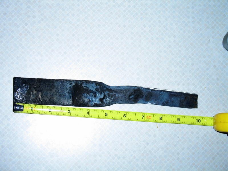

I have some used oilfield pipe (locally known as drill stem) which I believe is a Chrome Moly alloy. Wall thickness is about 1/4" except in the upset and threaded ends, where it's at least 3/8". Since I have maybe 50' of it left over from a building project, I'd like to use it for some other purpose. Hawks, axes and knives are of interest to me. Can anyone enlighten me to the potential of drill stem for these projects?

If it's actual drill stem from a drilling rig (the pipe that goes down the hole to drive the bit) it should be a tough alloy. But if it's just oilfield piping with regular npt ends schedule 40/80/160 A333 it's just mild steel.
I can't remember off hand what the alloy is, some sort of 8620 or something.  Something to remember as well, the "upset" ends are separate pieces that are friction welded on and may or may not be the same alloy, that's why most data books on drill pipe don't take the ends into account because they come from different manufactures.
Would probably be OK for the body, but I'd want a high carbon bit for the edge, never tried forge welding it so I don't know how well that'd work though.
Having a set of comparison samples to check sparks against can help narrow things down a lot.
If you luck across some known steel cutting sample to trade with others can make a nice collection;
things like 1020, 1045, 4140, 4340, 5260, O1, W1, 1095, H-13,  real wrought iron, cast iron, etc...and STAMP what it is on the holding end!
I cut a piece about 1.5" wide, cut the ring and flattened it out. It forges well. I narrowed one end of it and drew it out, thinning it from 1/4" originally to about 3/32". I heated it and quenched in water, then put it in a vise. It breaks when struck with a hammer. Here's a photo of the end grain showing the crystalline formation. A file will cut it with some effort.

Also back to the matter at hand i just completed a hawk from scrap pump shaft from work i am guessing that the steel could be pretty similar to drill stem. Probably has good torsional resistance, some corrosion resistance, and very tough. Probably not as good for taking an edge but this seems good for a hawk to me where mostly you are worried with shock resistance and is tough so it wont bend. That is if you commonly throw the hawk like i do. Thats just my take may be wrong.
I decided to go ahead and make a "knife-shaped object" out of my test piece just for practice. When I get it cleaned up I'll post a pic. This is my first attempt at a knife (other than the one I carved out of wood when I was 10 years old), so there's a LOT of cleanup to do.

I realize this puts this thread into the wrong group, so if it needs to be moved, feel free. Here's what I started with Tuesday afternoon, along with the cleaned-up version.
I ground enough off of it to make another one like it. It'll look a little better when I get some wood on it.
