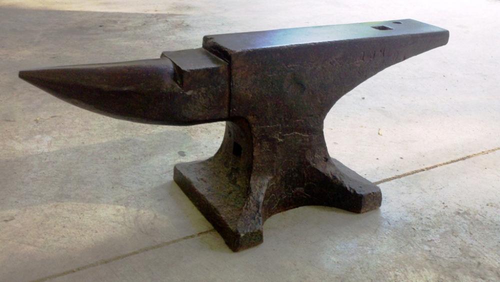

jerryt Posted April 4, 2016 Posted April 4, 2016 (edited) I am also very interested in this because I do not understand the construction of the new anvil I got this week which is suspected to be a HB. Jerry Edited April 4, 2016 by jerryt To add pics Quote
arkie Posted April 4, 2016 Posted April 4, 2016 Check the foot under the horn for a serial number. If it is indeed a Hay Budden, you can find the date of manufacture and type of manufacture by consulting Postman's Anvils in America. Quote
ThomasPowers Posted April 4, 2016 Posted April 4, 2016 Solid high carbon steel top sections are only hardened to a certain depth---prevents the anvil from breaking. If you really want to learn about how anvils were made and you live in the USA go to your local public library and ILL "Anvils in America" by Richard Postman and read it! Let me give you a hint: a couple of posts by random people on a web site does not take the place of 550 pages written by an expert. Quote
FoxFire Posted April 4, 2016 Posted April 4, 2016 That is most certainly a Hay and it does look to the later 2 piece construction. The slender waist (with the almost straight sides under the horn and heel) and well defined base/feet are giveaways. There should be 3 numbers stamped in to the far side up by the start of the heel. Just realized that I was responding to jerryt's post in Emower's thread... Quote

ThomasPowers Posted April 4, 2016 Posted April 4, 2016 Getting back to the original picture I'd *guess* it was a function of work hardening as you see the thin layer delamination on items heavily used---like RR track at times. Quote

01tundra Posted April 8, 2016 Posted April 8, 2016 Just a side question, I keep hearing about HB's "later" 2-piece design. My 155 HB was manufactuered in 1895 (confirmed) and I always assumed it was a two piece design because of the large line across the top of the waist that I assumed was where it was welded together, but now I'm wondering if it was just rough casting marks because the manufacturing date doesn't seem to coincide with the shift to two piece design? Quote
ThomasPowers Posted April 8, 2016 Posted April 8, 2016 London Pattern Anvils commonly had a forge weld at the waist predating the use of cast tops/bottom by a century or two and still being used afterwards---though some manufacturers started arc welding the waist join in more modern times. Quote
01tundra Posted April 8, 2016 Posted April 8, 2016 So does this that mine is likely a 2-piece and that HB started doing this well before the 1920's (as in 1895)? Quote
