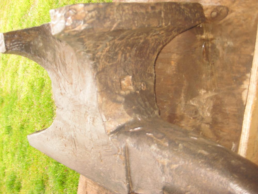

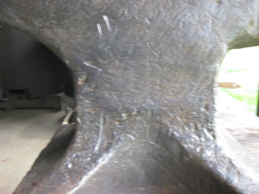

  15. Hi everyone, Got this anvil yesterday. I had posted about this anvil several weeks ago and the consensis was it was a Hay Budden. Due to site/login problems, I can no longer access your responses to refresh your memories so I'm on a new account. Anvil came from a local fellow who bought it from a family with a railroad history when they sold the barn/farm. It was mounted on a cast iron low platform which may have been a switch base in its original life. I removed it from the base to clean it up. Approximate anvil weight is 300 lbs. Length 32", height 13", width is 5 1/8". Base is 13x12" and base is about 2" thick at corners. The only identifier is a "6" left under the horn. Horn is 9" (12" including the step). Hardy is 1 3/8", pritchel is 5/8". It had been painted at some point but was mostly bare metal. Wire wheeled it today and coated it with linseed oil. Before oiling, used blue chalk and could not raise any identifiers. Please give your opinions on its identification and history. All the strike marks on the body make me think it may be a forged base. Ring is loud and clear, especially loud at the extreme ends. Rebound is great. At the step it appears an old repair was made. Top is flat. BTW: Smaller anvil in the background is a 214 lbs Peter Wright. Thanks for your efforts. Jerry

  17. 11th attempt to respond, including a computer restart. Never see such a tough site to use. Tom, Thanks for reaffirming my decision to walk away. He has my contact info. BTW: I have a retail store but am only fooling with anvils to learn. I do have my 214 lbs Peter Wright listed on CL but have made no further selling plans. Jerry
  18. No noticable buzzing. I used his small 16 oz ball peen. Did not strike hard enough to dent. You think I may have made a mistake walking away at that price?
  19. Crap! Lost my post again!!! I'm not a typist. Anvil is tightly secured to the base and base thickness is about 3/4". Rebound varied, particularly near the Hardy. The flat of the horn had no rebound at all. Made me wonder if the top is tool steel and body is cast, similar to Fisher. My Fishers have the tool steel extended from the table fully across the flat of the horn step and across the top of the horn. I don't know how the H-Bs were made.
  20. Update: I looked at it and struck it repeatedly. IMO, the table was not consistent in rebound or ring. No obvious damage but I was just not impressed with the sound. Maybe that is characteristic of Hay-Buddens (if that is what this anvil is). I've never seen a H-B before. There were no other identifying marks. The stand is open in the center so I could feel the bottom. No hourglass recess. Totally flat on the bottom. Anyway, given that the brand is not clearly determinable, I felt he wanted to much for the anvil (started at $1,000 and came down to $750). I went as high as $600. No deal.

  22. Direrwolf, Thank you. I kinda figured it was closer to my Fisher in weight. I don't understand the board/forum, I guess. I posted details twice and can't see my own posts, so don't know what anyone else is seeing. Jerry Direwold, I see the one I just addressed to your response. The other two have disappeared. Something is screwy. Jerry
  23. Thanks Frank and Ivan. What is your assessment of condition (given the rust-covered surface) and is there a place where I can find out the different sizes Hay-Buden made? Jerry
  24. Frank, I went back to him. The "6" is on the waist under the horn. Now to find some info on the various versions of Hay-Budens in the larger sizes. Thanks. Jerry
