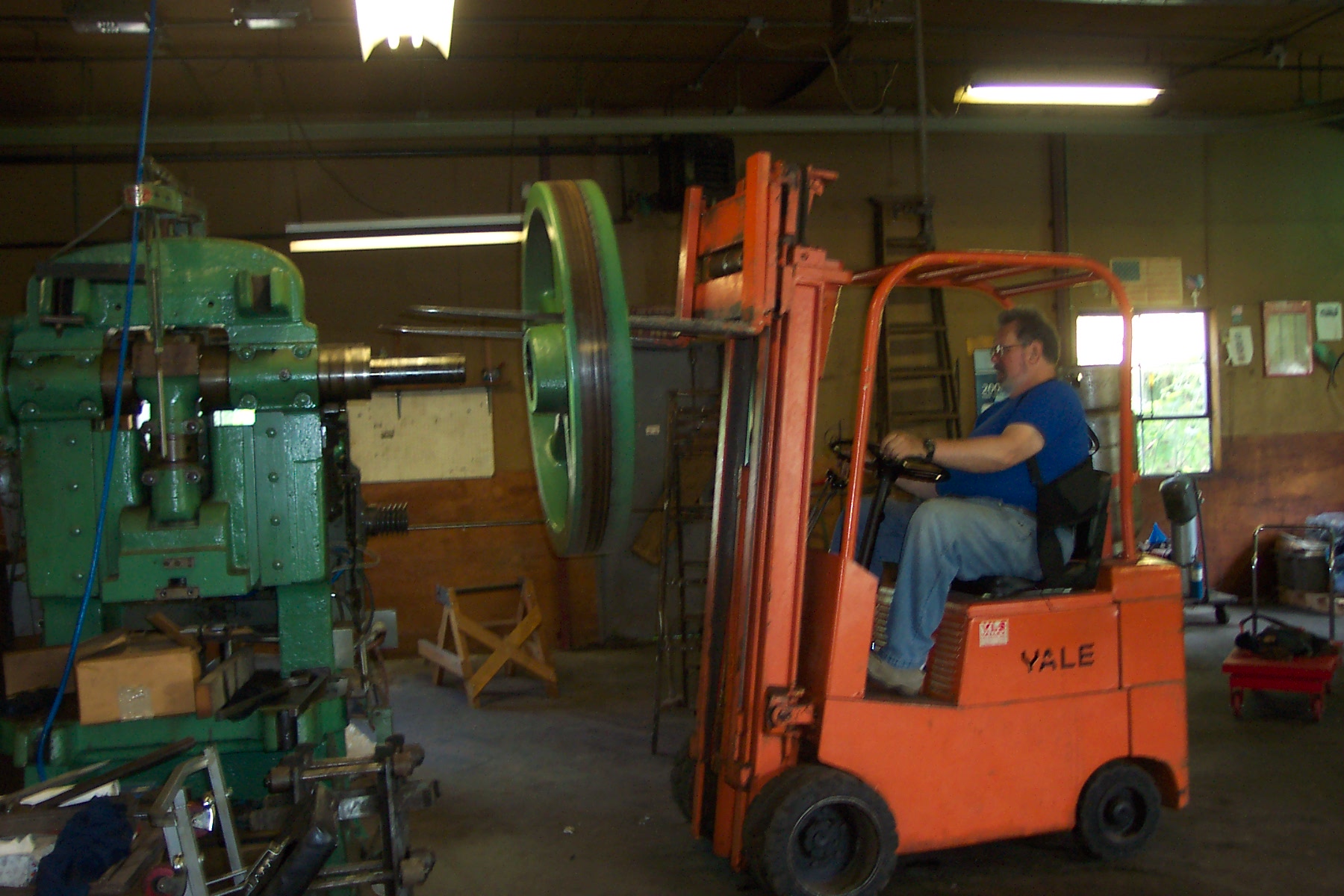

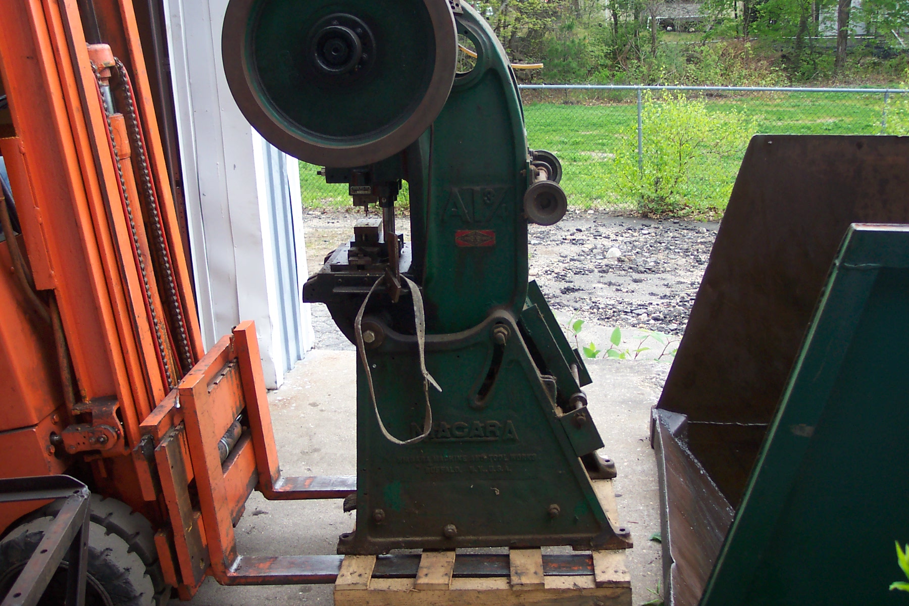

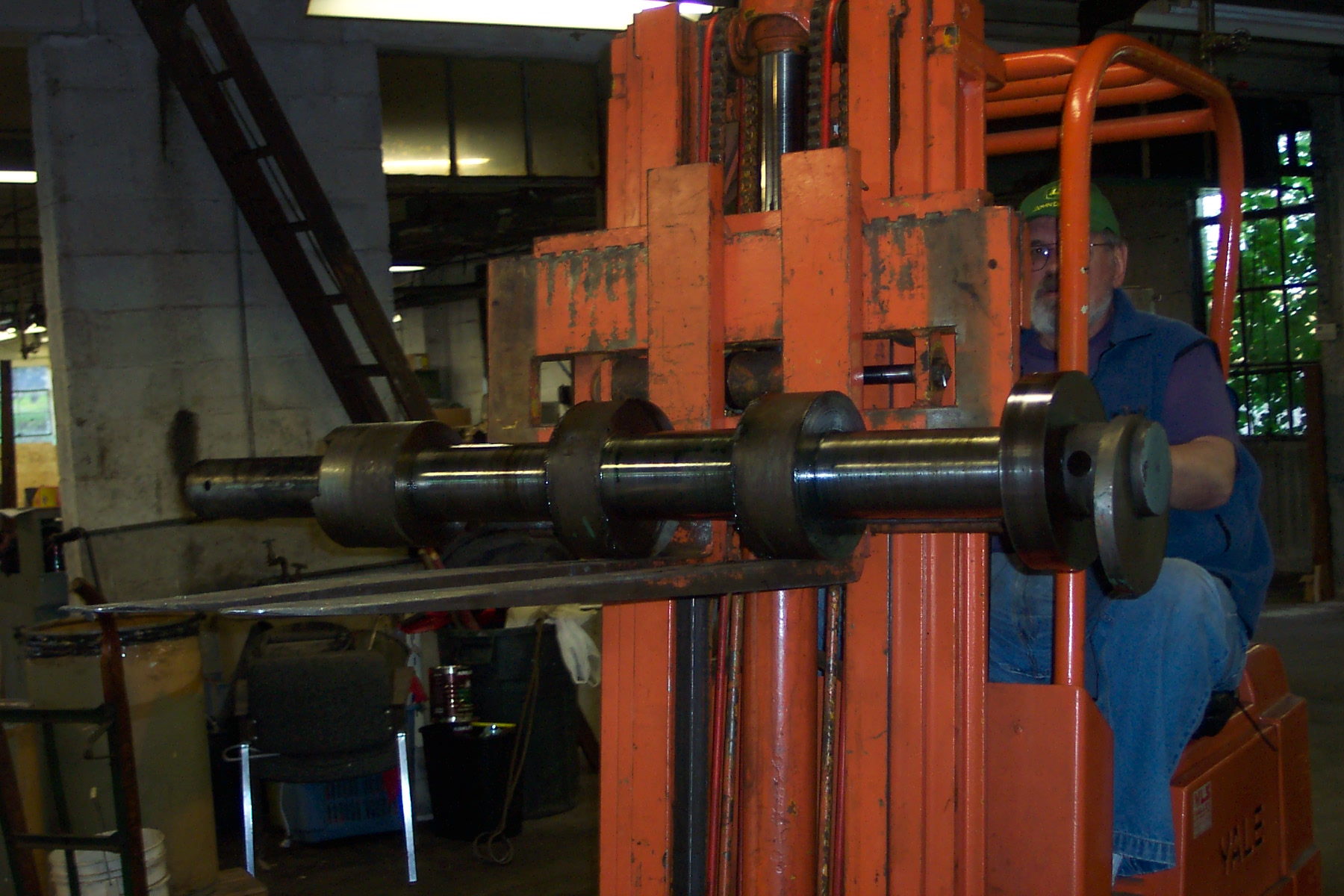

notownkid Posted March 9, 2016 Share Posted March 9, 2016 These are Punch Presses 1st is a smaller one 2nd is one of the largest in the shop I helped clean out a few yrs. ago, 2 3 show the press being stripped for scrap the frame was cracked and had worked till the shop closed but nobody would buy. 3rd is the crankshaft out of the machine. These were run by 3 phase electric motors and belts. I think 2 was a 50 ton press. We had to strip every part we could get off so we could move it to the scrap bin. Somebody asked about punch presses Forklift operator is my brother in law and had owned the shop & machines for 40+ yrs. there had been 25 machines wnen we started the clean out. 8 were scrapped Quote Link to comment Share on other sites More sharing options...
Sanderson Iron Posted March 9, 2016 Author Share Posted March 9, 2016 There you go, Jumbojack, the first picture above is an OBI. See how the whole machine can be rocked to different angles? The flywheel's on the side with a crank in the middle, instead of like mine which has the flywheel on the back and the crank on the end towards you. Thanks for showing those, notownkid. It sure is a shame any were scrapped. Can you imagine if eight hammers had been scrapped? People's cries would still be echoing. Had those been power hammers, they'd have all sold no matter the condition, and folks would have been declaring that they "saved" them and so on and so forth. Unfortunately, hardly any blacksmiths know what one of these can do, which is a mystery to me, because they've been around for as long as hammers. (The one I use probably predates the Little Giant company.) Why there's a flypress movement and no toggle press movement, I just don't understand. Joel Quote Link to comment Share on other sites More sharing options...
