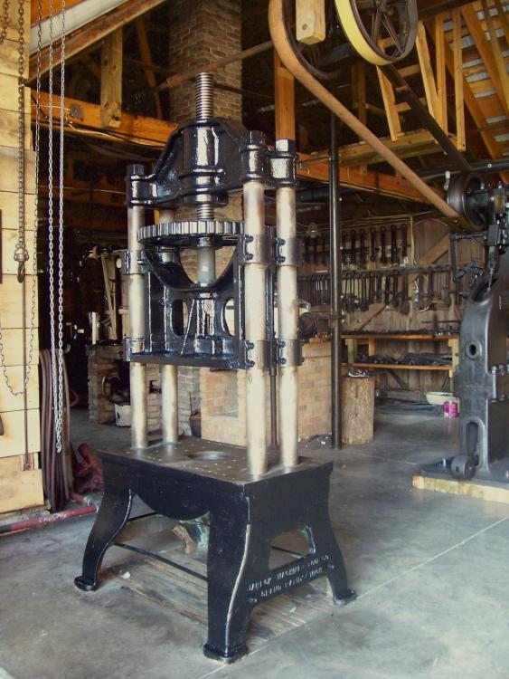

Sanderson Iron Posted March 3, 2016 Share Posted March 3, 2016 This is a 35 ton screw press, or try press, made in Grand Rapids, Michigan by the Jereki Company. If I remember right, the date on it is 1910, but I could be wrong. It's not intended for hot work. It's very slow. It's made to try your dies (therefore a "try" press) before you put them under power and heat. It has one large hole in the table and many 3/4-10 holes in the head and the table for bolting dies in position. I use this all the time. It's particularly nice for fitting embossing dies--where the punch enters the die--using copper test pieces to gauge the relief needed. Cold copper behaves a bit like hot iron, so if you test your dies with copper, cold and slow, you can tell what areas are still contacting too much and need more relief. Anyway, I thought somebodies might like to see this. I picked it up in 2010. Great tool. Is anyone else here using a screw press? Joel Quote Link to comment Share on other sites More sharing options...
Kevin Olson Posted March 3, 2016 Share Posted March 3, 2016 Cool. How big is it? Is this a powered machine or do you crank it by hand. I would like to see more of the shop. Looks like a nice space. I see a line shaft. Cool! Quote Link to comment Share on other sites More sharing options...

Sanderson Iron Posted March 3, 2016 Author Share Posted March 3, 2016 The press I showed a picture of, Thomas, is a much different animal than the percussion presses popular in blacksmiths' shops. People sometimes call those screw presses, but really they are percussion presses or fly presses. The percussion press has a double or triple screw, and the ram is propelled downwards by the momentum of the flywheel. (I know you know that--just explaining the difference here.) The press I use has a single thread, and a relatively fine one at that. It is very slow. It is not intended for forging. There is a handle that fits into a ratchet that clicks in and out of the teeth around the wheel, (which you can see in the picture) rotating the wheel either downwards or upwards. It is hand powered, Kevin. And yes, my shop is all line driven, powered by a Reid engine made in 1898. Quote Link to comment Share on other sites More sharing options...
ThomasPowers Posted March 4, 2016 Share Posted March 4, 2016 Fly presses are usually 3-5 lead screws and Screw presses 1-2 lead; my hopkins is a 2 lead screw. You're right in that you tend not to get the bounce of a press with more leads on the thread; but It's done a lot of nice things for me. My friend TM once had a press with a very large platen that used to be used for making the pressed tin ceiling tiles. Well suited for pressing thin metal into a die but not for trying to focus the power in a small area. His first press came from the old packard plant where it was used for body work. Quote Link to comment Share on other sites More sharing options...
Sanderson Iron Posted March 4, 2016 Author Share Posted March 4, 2016 There is no bounce whatsoever to this kind of press, Thomas. It squeezes. That's it. It is not a percussion press. It is built very differently than your Hopkins. It is ratcheted downwards or upwards. Single thread/lead screw presses give a slow, quiet push. It is a try press for testing dies, pressing bearings, broaching, straightening shafts and that sort of thing. It's nice for straightening shafts, because it's convenient to mount an indicator on it, and the push is so slow and controlled. I find it to be very useful, especially like I said earlier, for testing embossing dies with copper. Don't know if anyone on here's doing that kind of work or not, but I thought I'd throw it out there and see. Do you happen to remember the two that showed up on a trailer at Quastate in, oh, I think it was 2006? They were single lead presses and built like this one but by some other company I don't recall. Nobody was interested in them, said they were slow, and they left on the trailer that brought them. I remember talking about them with Patrick, but I don't remember if you were there for the conversation or not. Kevin, I forgot to answer your question about how tall it is. It's about eight feet. There's another Jerek press in a salvage yard a couple miles from me that has an extension, making it two feet taller. I think it's a factory extension, though I could be wrong. I tried to buy it before I found this one, but they use it there in their shop and wouldn't let it go. Quote Link to comment Share on other sites More sharing options...
Sanderson Iron Posted March 5, 2016 Author Share Posted March 5, 2016 It was kinda rude of me to say this press is different than a percussion press and then not give pictures to explain. Here're some to show it better. The ratchet/dog, which you can see in the second picture, can be flipped either way to move the ram upwards or downwards. You can imagine how slow it is--you stand and move that handle about two feet back and forth in order to move one tooth in that big gear. I counted the teeth once, and I think there are 48. If so, that means 24" of handle movement gives 1/48th of a revolution. It's something like that, anyway. If you take the gear and try to throw it, it only goes a quarter turn or so. This press is absolutely quiet. If you've ever used an hydraulic H-frame press, you'll know that when you press a bearing in or out, it goes a wee bit and then POPS and then goes a wee bit more and POPS. That's the frame stretching and bending. This press doesn't do that--it just pushes steadily until it's done and never says a word. Quote Link to comment Share on other sites More sharing options...
Jim Coke Posted March 5, 2016 Share Posted March 5, 2016 Greetings Joel, Beautiful piece of equipment. Thank you for your explanation and pictures. It is a fine example of leverage and the inclined plane to multiply force.. I can see the original use as being able to see how the dies and material perform prior to installation into a more rapid production press . Forge on and make beautiful things Jim Quote Link to comment Share on other sites More sharing options...

jumbojak Posted March 5, 2016 Share Posted March 5, 2016 That's fascinating. I like the pulley drive system in your shop too. Never knew there were different types of presses that operated in this way. Well, more research for me to do.... thanks for sharing! Quote Link to comment Share on other sites More sharing options...

jumbojak Posted March 6, 2016 Share Posted March 6, 2016 So, the first press slowly ratchets down to test a die which will be used in another press for the production run, right? For that you use the toggle press, which I gather is a more rigid version of a standard flypress, though it seems to be powered and have a flywheel that's mounted vertically instead of horizontally overhead, like a flypress? And a flypress uses percussive force generated by the mass of the flywheel to form a part? Sorry if these seem like silly questions but I'm having a bit of trouble making out the images. It's not that they aren't clear, I'm just gradually going blind and attempting to look at them on a small screen. Quote Link to comment Share on other sites More sharing options...
Sanderson Iron Posted March 7, 2016 Author Share Posted March 7, 2016 Yes, the screw press slowly ratchets down in order to test dies while they're being made. Then they are fitted into the power press for production. Do you know what a punch press is? Well, that's what this is. There's a crank, and on one end of the crank there is an arm which connects to the ram, the head, or whatever you want to call it, and there's a flywheel on the other end. The flywheel spins with the belt, and there's a dog clutch ("clicker clutch") that engages the shaft when you press the pedal, which makes the ram go down and back up again. If you hold pedal down, it keeps going until you release it, and then it stops at the top of the stroke. It always goes to the same point and returns. That's really, really nice. For instance, in the punching operation I showed the dies for, you want the punch to go just into the die and return. Same with the embossing operation. You can set the position of the ram to just where you want it, and it'll always go there and return. There's a really common version of this, called an OBI (Open Back Incline) that has an open frame to pass parts through, and it rocks (inclines) so that parts will drop out when they're punched (and for other reasons). Neither press behaves like a fly press. A fly press is a percussion press, which doesn't have that solid link on a crank. Its stroke is not specific. The head on a percussion press moves until the energy in the flywheel is spent, which means it doesn't always make the same stroke, either in power or in position. That lets you do veritable things, freehand, while the toggle press can only do the same, repeated operation until you change its setup. The toggle press is a very important part of my shop. In fact, some of my pieces have more work with the toggle press than with the power hammer. I think it's an overlooked machine by most of today's blacksmiths. Joel Quote Link to comment Share on other sites More sharing options...
