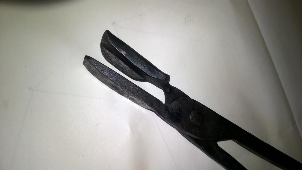

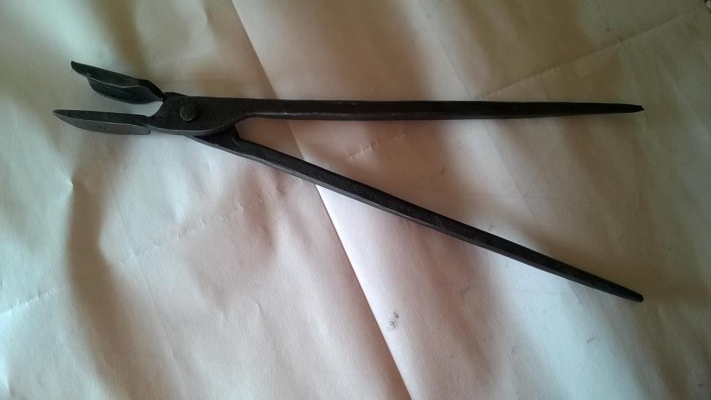

While working on another project, I thought I would stretch my skills a little and make a set of box tongs from scratch.
These are 3/4 box tongs made from 16 inches (8 inch each side) of 3/4 by 3/8 flat stock, now that I have them the next sets will go faster.
I learned a lot making them.
Excellent work, JJ. A functional pair of tongs with very clean lines and finish. Nice how you tapered the reins.
Very nice, they're so much better than tongs I make I think I'll just quietly admire yours.

Thanks everyone for the feedback.
That's as fine a looking pair of tongs as I've ever seen.
much better than mine:D! you did a good job making them.

JJordan,
Nice tongs, much like some I have made, and still use.
