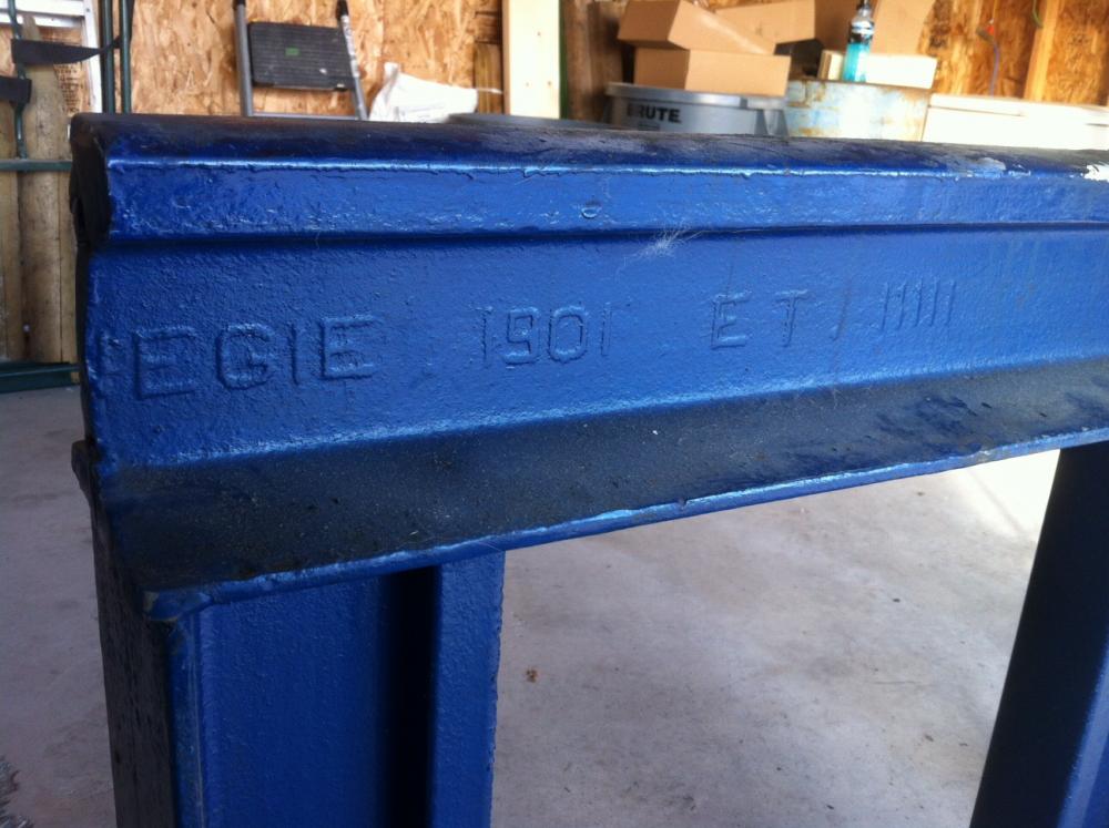

Until I find a proper anvil here is what I have. I got it this way.
Three pieces welded together with angle iron feet. Each piece is just over 26" not including the point on the top piece. Total weight is about 170lbs. I can pick it up and move it but it is heavy. Not stable though. It rocks a bit on the angle iron. It's probably meant to sit on soil not flat concrete.
image.thumb.jpg.89027c8723ad403f79f3aa69
image.thumb.jpg.5974dafe01d8f21897114e57
What should I do with it?
I have started to reshape the point so it is more rounded and usable.
I prefer the idea of the tie being vertical. Should I cut the pieces apart and mount them vertically? Weld them together into a single vertical piece? Most people seem to only use a single piece. I have seen a few interesting ones online just not as many as I expected.
Or just leave as is and use it until I find a better option?
It's ok as is (assuming it's the right hight for you) but the thin web and long belly reduce efficiency. In other words the anvil will flex a small degree absorbing some of your hammer blow.
Use it for a wile, then latter chop it up and make a bunch of tools out of it.
Frosty suggests to nest 3 pieces of RR track together and weld. Stand it up on end and weld a thick top plate securely to all 3 pieces of track.enjoy a HEAVY anvil.

That is basically what I was thinking. If the main part of two tracks were welded to the the webbing of the third and butted up against the main part it would creat a solid core that is greater in size and very stable. The remaining webbing could then be modified into different uses such as hot cuts.
I would need to get the cutting and welding done by my neighbour. I am just starting to learn to weld and not up to that job. I like the idea though.
The two track are laid on the ground flat down and the third track is nested in between the two with the flat up. This makes the most compact nesting arrangement. Stand them on end to use so all the mass is under the hammer.

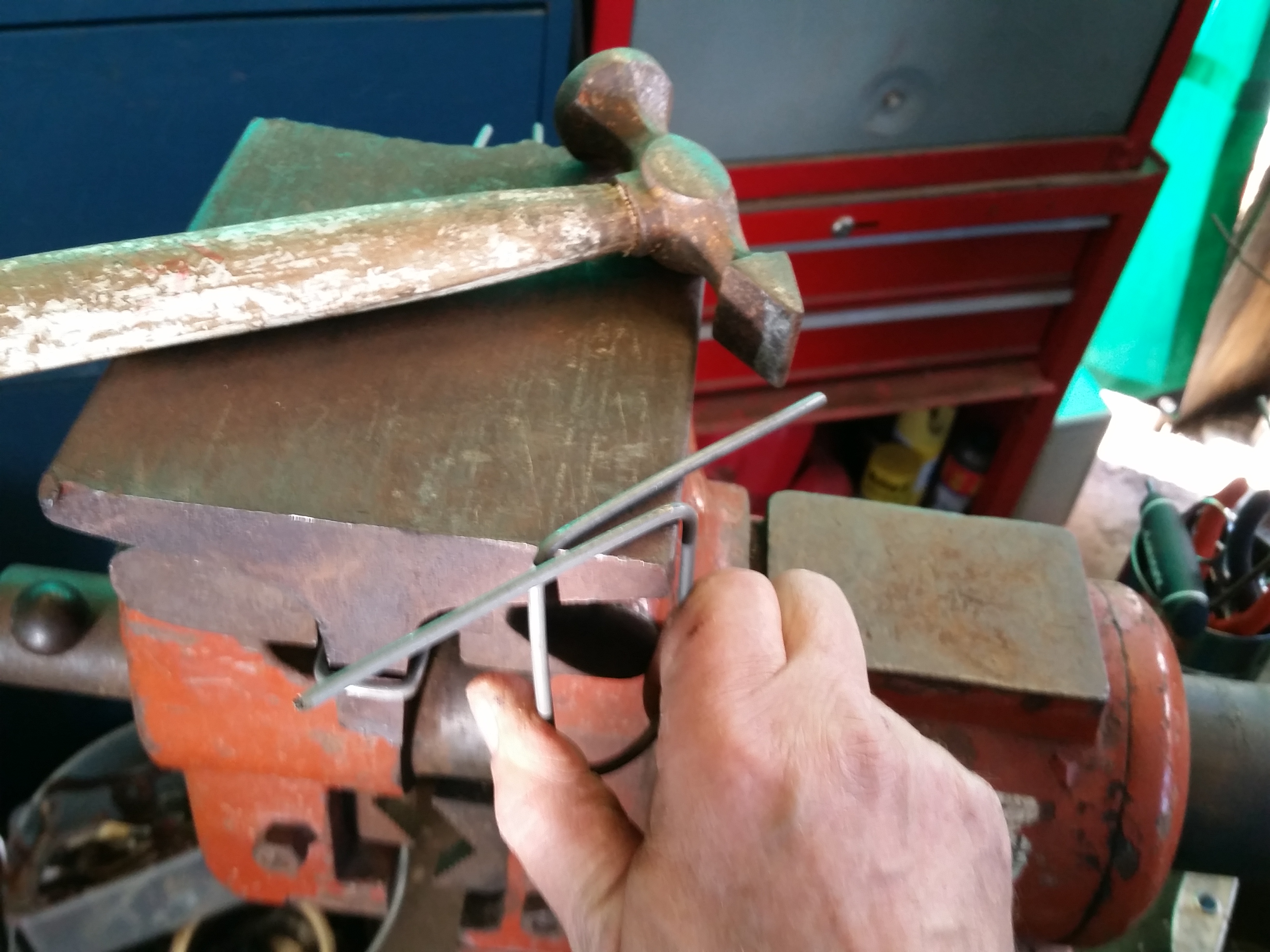

See how a simple hairpin corrects for the curvature of the rail's web, putting a monster grip on this swage anvil I am building. The top piece goes in the same way. Even a large 'cheap' vise has plenty of guts for 'moderate' to 'small' hot or cold work. Imagine how much fun I will have after I have put in some bevels, notches, holes, and radii! (This is just an example of what one may do with an unmodified piece of rail).

Anachronist, thank you for the info on the rail. Any idea as the the meaning of the ET IIIII after the date?
The five I's would signify the month of May (1901) and ET would be the place of manufacture (possibly Etna, Pennsylvania? Or Edgar Thompson?). If anyone is more familiar than I am with rail markings, please correct me.
