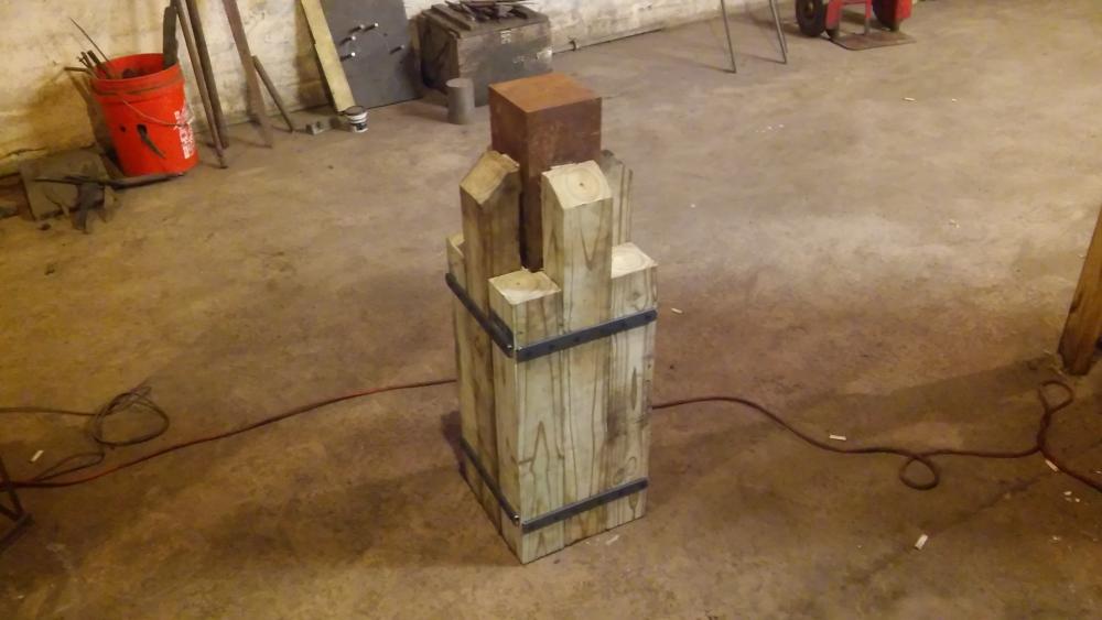

j.w.s. Posted December 1, 2015 Share Posted December 1, 2015 Here was today's project - drawing inspiration from the floor based Japanese anvils. Still need to dress up the edges and harden the face, but the hard part is done. I took a 5"x5"x11" block of A2 (85lbs) and built this stand around it. I just wanted an extra anvil around the shop for teaching classes plus, a nice object lesson for anyone who visits the shop and brings up the inevitable "where to find an anvil" conversation. The primary point of this is that you don't need a horn or a heel to have something that's effective - and you don't need to spend an arm and a leg.. My total cost was around $105 for everything including the new box of screws I had to buy because I couldn't find the one at the shop. J Quote Link to comment Share on other sites More sharing options...
jumbojak Posted December 1, 2015 Share Posted December 1, 2015 That's pretty much what I have now, minus the stand. Thoughts have been a brewing in my head about an effective way to secure mine and I like your design. My plan was to make a sleeve out of angle iron to attach the legs to and apply a layer of clay on the bottom to deaden any bounce. What's the total weight of your setup? Quote Link to comment Share on other sites More sharing options...
j.w.s. Posted December 1, 2015 Author Share Posted December 1, 2015 I just cut the 4x4s to receive the 5x5 block and to keep it at the height I wanted. The anvil has about 0.1875" play all around and just shimmer snug with some scrap pine. If I had to guess on the weight I'd say it's about 150lbs total. J Quote Link to comment Share on other sites More sharing options...

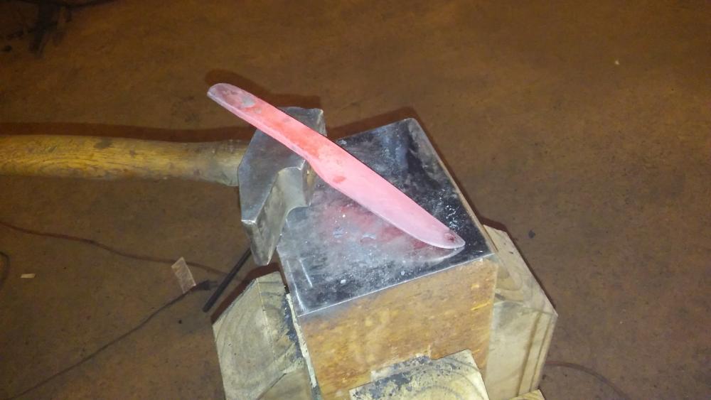

j.w.s. Posted December 2, 2015 Author Share Posted December 2, 2015 Just a quick run of it this morning.. Seems to be working fine. This was just a scrap end of a san mai billet I had lying around the shop.. Drew it out from 4" to 6.5". My only complaint is that the stand tends to rotate slightly but that's easily fixed with an anchor bolt or two. J Quote Link to comment Share on other sites More sharing options...

j.w.s. Posted December 2, 2015 Author Share Posted December 2, 2015 Here's a shot of the cross section in case someone wants to copy my design. J Quote Link to comment Share on other sites More sharing options...
Daswulf Posted December 2, 2015 Share Posted December 2, 2015 If I find a nice hunk of anvil like that I would love to copy that design. I think the only thing I'd do differently would be to drill the wood and use lag bolts. Just preference, nothing wrong with yours at all. I already have 2 anvils but one like that would be nice to work on for sure. Thank you for sharing. Quote Link to comment Share on other sites More sharing options...
ThomasPowers Posted December 2, 2015 Share Posted December 2, 2015 since I have a bunch of old guard rail and telephone pole hardware, (I tend to pick it up at the scrapyard my local electrical coop uses), I'll probably advise him to bolt through the longer "holding" uprights and use them as a clamp on the anvil Quote Link to comment Share on other sites More sharing options...
j.w.s. Posted December 2, 2015 Author Share Posted December 2, 2015 This ones together from the inside out using those spiked joint plates. J Quote Link to comment Share on other sites More sharing options...
