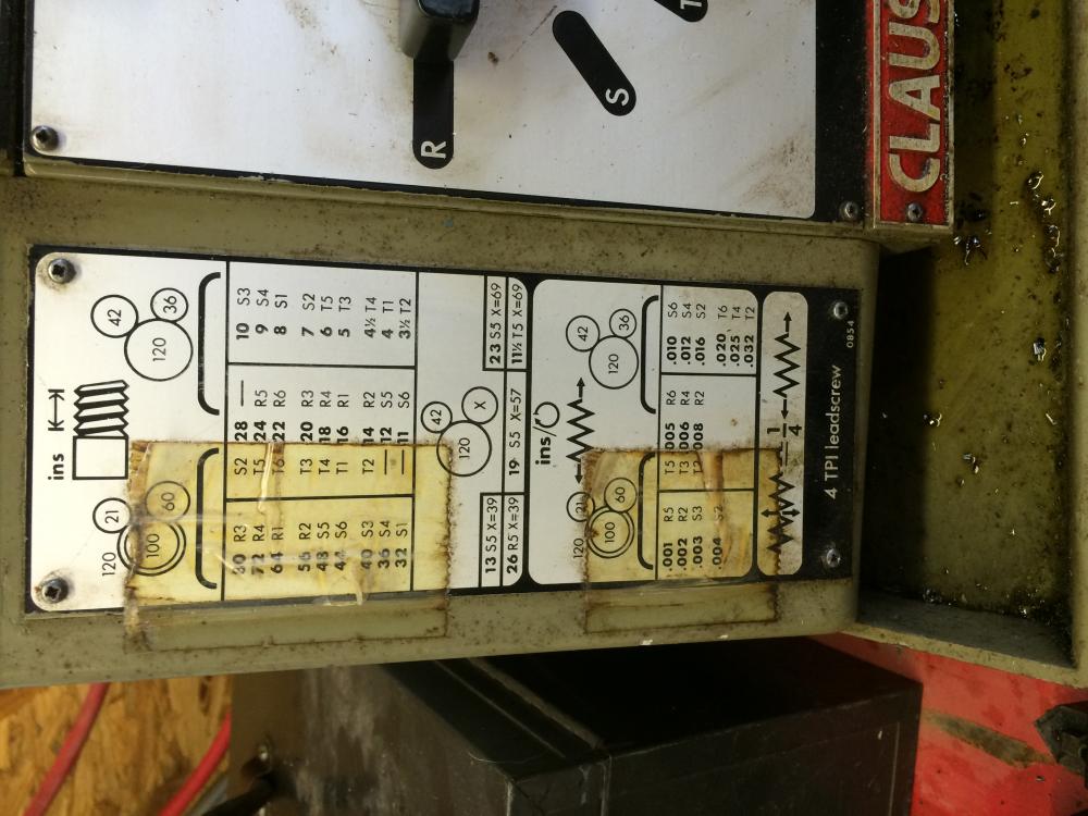

GottMitUns Posted September 16, 2015 Share Posted September 16, 2015 Can anyone tell if it is possible to cut metric threads with this lathe by the pictures below?my Shop lathe lists metric threads on its "gear selection" but this one does not. I know that because it has a "American" leadscrew that if I do find the right gear I will have to leave the half nut engaged and stop the machine at the end of the threads, pull out, and then reverse the machine back to my starting point. Thank you, Russell Doerr Quote Link to comment Share on other sites More sharing options...
HWooldridge Posted September 16, 2015 Share Posted September 16, 2015 It's an Imperial (English/American) gear set. Only way to cut metric is if one of the TPI settings happens to coincide with a metric standard. Or you'll have to change out one or more gears... Quote Link to comment Share on other sites More sharing options...

GottMitUns Posted September 16, 2015 Author Share Posted September 16, 2015 1.5 mm= 16.9333 TPI = .0590 per rev16 TPI = .0625 per rev18 TPI =.0555 per revby the time I get .600 of thread engagement I would be off by about 1/2 a thread (.030 +/_ ) either way I go. I did find the chart and formula for using change gears that should get me to a error of .00008MM if I have the correct gears at home. the hunt continues. ThanksRussell Quote Link to comment Share on other sites More sharing options...

Alan Evans Posted September 17, 2015 Share Posted September 17, 2015 (edited) I just looked at my old Ward 7 lathe plate and that has two charts, each one for a different lead screw if I read it aright.You photo has the legend at the bottom 4tpi leadscrew so I think that is the key.Any handbooks available to download for your lathe?Alan Edited September 17, 2015 by Alan Evans Quote Link to comment Share on other sites More sharing options...

GottMitUns Posted September 17, 2015 Author Share Posted September 17, 2015 I found a stack of gears but no manual so I will be going back online to see If I can find a reprint. The chart I printed off the net is different enough that I want more backup before I try it.I think I have everything except the knowledge to know where to stick what gear. Russell Quote Link to comment Share on other sites More sharing options...

GottMitUns Posted September 17, 2015 Author Share Posted September 17, 2015 The good news is the Tech support guy at Clausing is top notch, and I now have a PDF copy of the 1979 manual for my lathe!The bad news is it looks like the extra gears I have are for a different clausing lathe in my shop.Now I have them quoting their optional metric gear set, hoping they still have some in stock.Fingers still crossed!! Russell Yesteryear I have been lurking the practical machinist sight trying to learn enough to ask a semi intelligent question,,and understand the answer!! Russell Quote Link to comment Share on other sites More sharing options...
HWooldridge Posted September 17, 2015 Share Posted September 17, 2015 Better be sitting down when you read that quote on the gears... Quote Link to comment Share on other sites More sharing options...
GottMitUns Posted September 18, 2015 Author Share Posted September 18, 2015 YEP!!! just over 2/3 of what I paid for the lathe 6 years ago, for 5 small gears and a gear chart! They had the quote ready to go because someone bought the last set they had on the shelf, at that price, a couple of months ago! They must have had a paying job to cut metric threads! Now that I know what new cost I will be investing a lot more time in a work around and searching for used! Its good information to have. Russell Quote Link to comment Share on other sites More sharing options...

rjs Posted October 3, 2015 Share Posted October 3, 2015 If you can replace the 120 tooth gear with a 127 tooth gear you can cut accurate metric threads. Regards,,Bob Quote Link to comment Share on other sites More sharing options...
