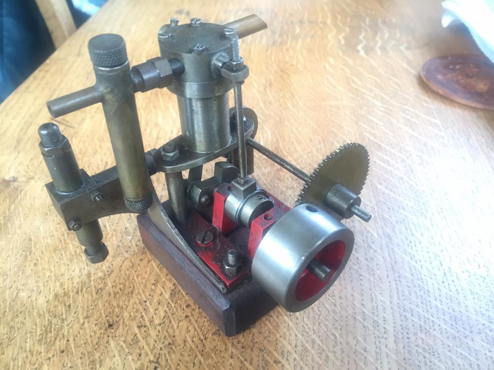

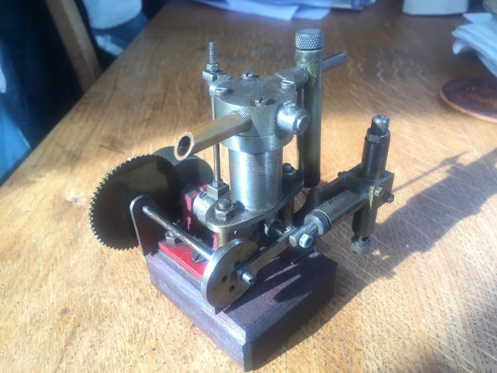

October 6, 201510 yr I think you are right a powered slotter would definitely be the way forward in the real world.My teacher's device was to enable us to make a slightly larger than Meccano size brass gear wheel for the steam engine I was making. He stacked half a dozen or so up on a mandrel and cut them all at the same time. Well, he set it up and the three of us making the engines did most of of the shaping.It is the gear driven by the pinion on the flywheel. The shaft then operated the water pump which pushed the water through the coil boiler.The photographs show my 45 year old steam engine. They are displayed here because I am still slightly smug that mine was the only one that ever ran first time without any valve modification when tested with the compressed air in the science lab!Downhill all the way since a sixteen year old!Alan
October 6, 201510 yr It would have to be powered Alan, a simple hand lever operated slide would speed the job up no end, I'd go so far as to say making a simple slotter (given the stock material being at hand) and cutting the gears would likely take no longer than cutting the gear via the saddle method!Nice little engine you've made there, about time you started on a full size one to power you're workshop ;)
