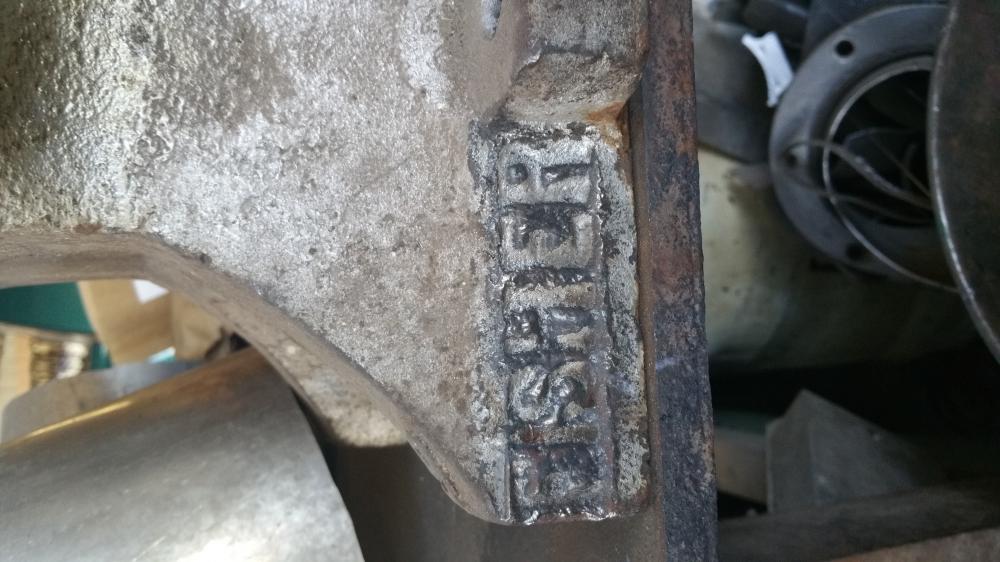

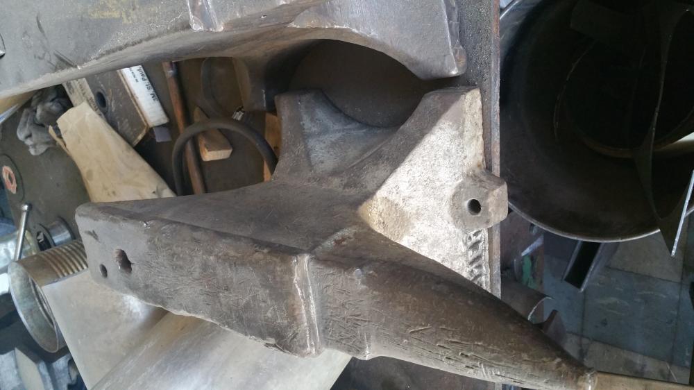

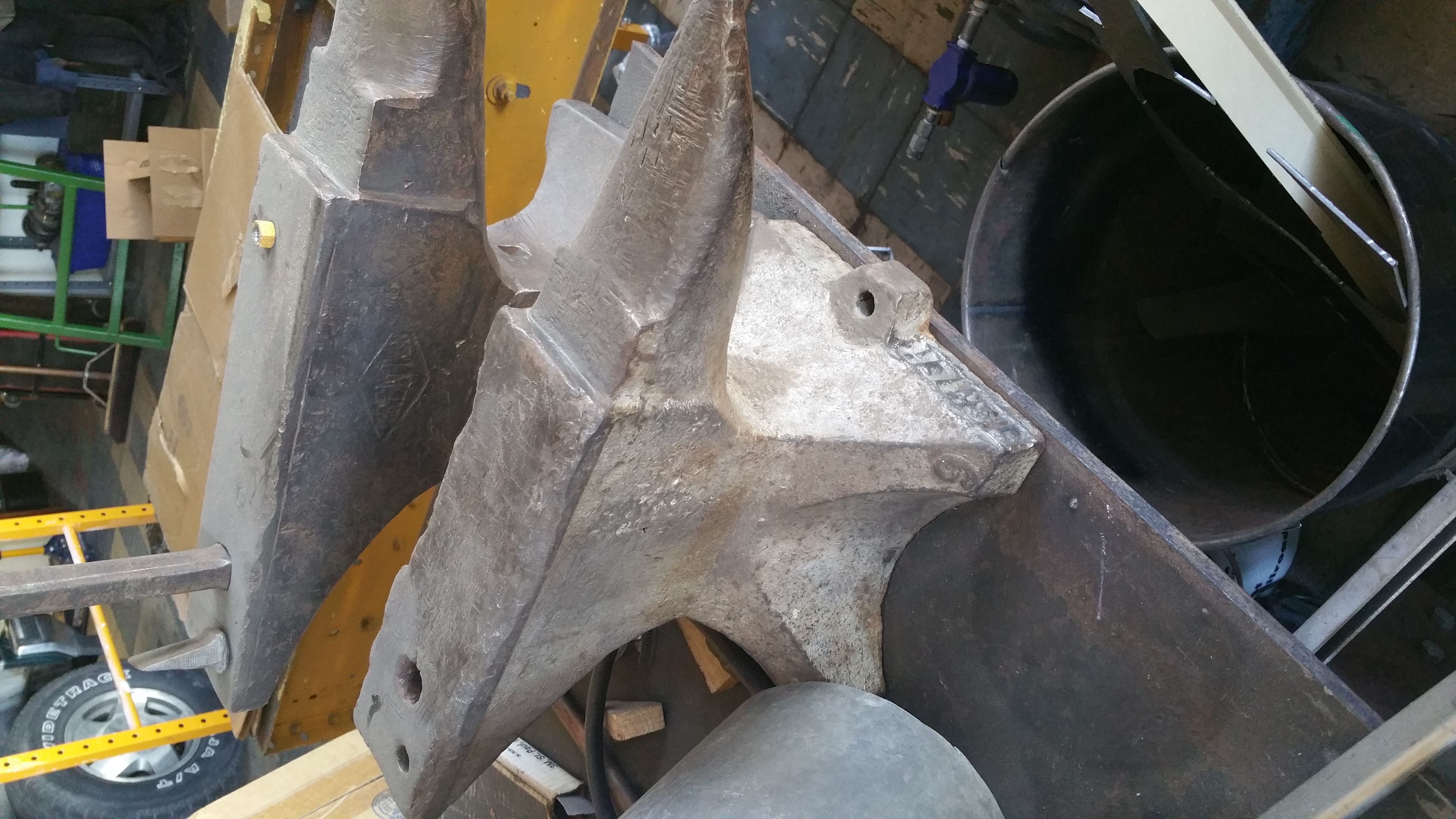

Tolate24 Posted September 4, 2015 Share Posted September 4, 2015 It's pretty rough but it was free....and free goes a long way in my book. Is this repairable? I imagine I could learn to repair it, I have a little fabrication knowledge, but I think that's way over my head....for now.Any info would be greatly appreciated the extent of my anvil knowledge is, they're heavy, and you pound on them. Time for my silly question. I love watching videos of blacksmiths working on their anvil to watch different techniques and things. A lot of them that I see hit their work a few times then hit the anvil, is there a reason for hitting the anvil?(It's the smaller one in the first pic..also I couldn't get them to rotate sorry!) Quote Link to comment Share on other sites More sharing options...
the iron dwarf Posted September 4, 2015 Share Posted September 4, 2015 lots of life in that, use the faults as features Quote Link to comment Share on other sites More sharing options...
njanvilman Posted September 4, 2015 Share Posted September 4, 2015 You have a well worn 90 lb FISHER. These have a steel top that was welded to the iron base when it was cast. They are notoriously hard to repair. Do not start welding unless you have real knowledge of how to do it.You have nothing invested in it. I would just use it as is. Maybe put it on the floor and use it for upsetting long bars. Quote Link to comment Share on other sites More sharing options...
ausfire Posted September 4, 2015 Share Posted September 4, 2015 It might look a bit battered but that anvil has character ... it's a survivor, and well worth a place in any shop.As for the anvil tapping you mentioned, there have been lengthy discussions on this site on the merits or otherwise of tapping the anvil between blows. Some find it necessary, some do it for show, others find it intensely annoying ... I don't tap but it doesn't worry me one way or the other. Whatever suits you. Quote Link to comment Share on other sites More sharing options...
