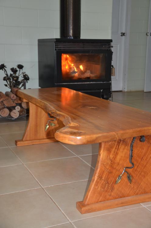

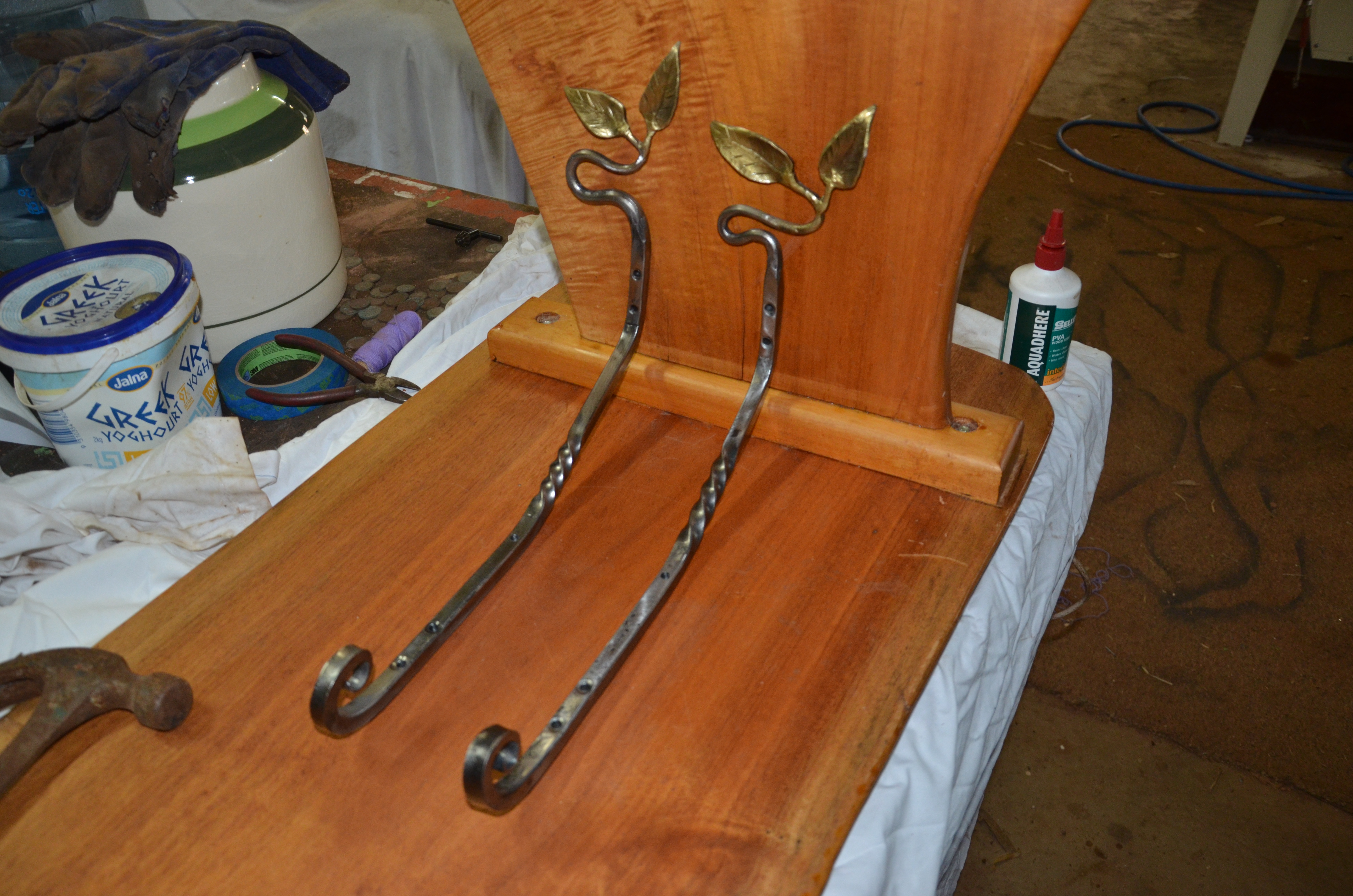

ausfire Posted September 1, 2015 Share Posted September 1, 2015 We have a nice slab maple coffee table, but after a few moves, it became a bit unsteady. Was going to just screw a couple of timber blocks underneath to stabilise it, but had a better idea about forging two brackets with a leaf motif to steady up the sides.Two bits of 12mm square bar and a bit of time at the forge and I was quite happy with the result. It has made the table rock solid and the leaves look quite at home against the maple.Here's how they go ... one at each end of the table: Quote Link to comment Share on other sites More sharing options...

ausfire Posted September 2, 2015 Author Share Posted September 2, 2015 Very nice Darryl. Just tell me you put the burnished leaves up under the table top so nobody not laying on the floor can see them. Frosty The Lucky.HaHa. The dog would like that. It's her favourite table to lie under.The leaves are quite visible from a seated position beside the table. After attaching them I had thoughts of making a smaller decorative pair for the exterior ends. (Near where the glue bottle is in the picture). Quote Link to comment Share on other sites More sharing options...

ausfire Posted September 3, 2015 Author Share Posted September 3, 2015 OK, Frosty, as requested. Table support in position, dog in position and beeah on the table: Quote Link to comment Share on other sites More sharing options...

ausfire Posted September 6, 2015 Author Share Posted September 6, 2015 No fire in the stove? Beautiful piece. Your dog's one eye'd look makes me think s/he isn't going to smile for the camera.Frosty The Lucky.Got a fire in the stove this time Frosty. Had a bit of a cold snap ... well, not cold by comparison to where you are. 'Cool' is perhaps a better word.As you can see I decided to forge another pair of leaf support brackets for the outside of the legs as well. Now that table really is rock solid. I applied the Trewax to those leaves so we'll see how they keep the shine.I like how the wood and steel go well together. Perhaps we should have a thread about projects that combine the two. I have made a couple of nice camphor chests which would benefit from some rustic forged hinges and handles. A future project. The dog isn't in the pic because she got up and left when she spotted the camera. I think the flash makes them nervous - too much like storm lightning perhaps. Quote Link to comment Share on other sites More sharing options...
